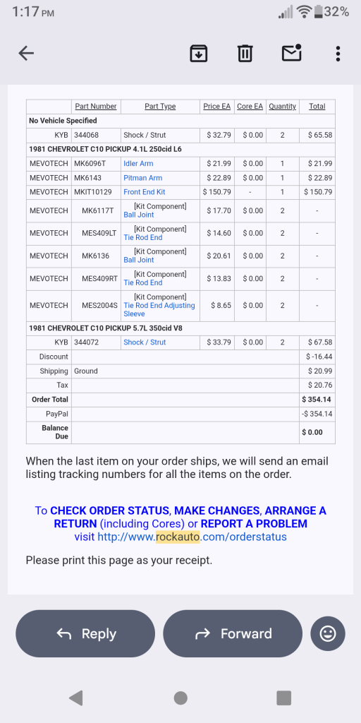

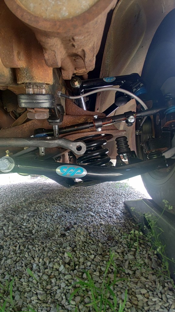

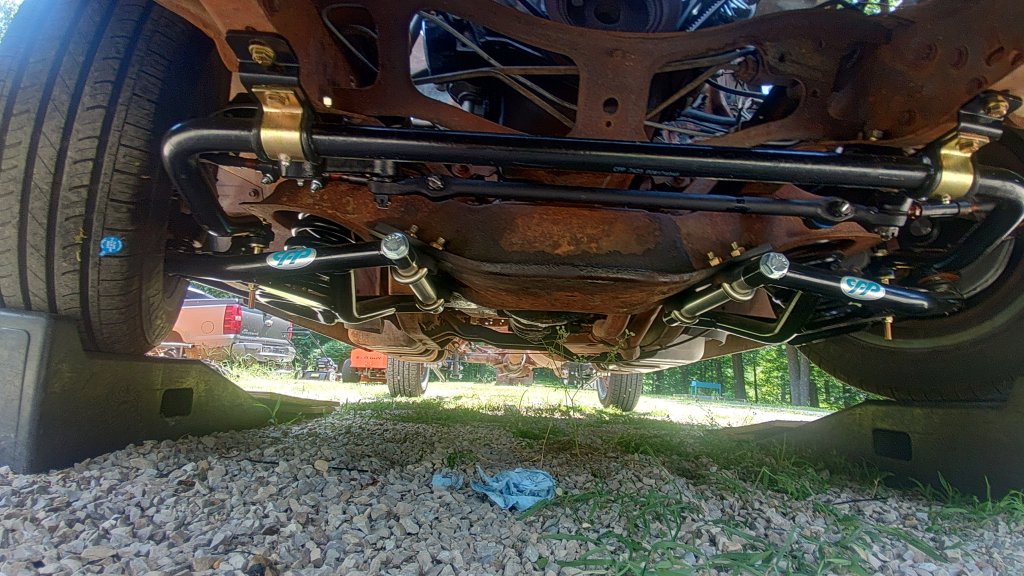

Replacement tie rods and sleeves match original on this 20,000 mile truck, but inners and outers touch inside the sleeves after lowering. (Detroit Speed & Engineering 950# springs, CPP UCA/LCA/modular spindles) I need more adjustments for toe in, as I'm currently unable to mount them to the center link due to length.
Ideas and suggestions are greatly appreciated! Parts list attached in photo.

The rod ends are bottoming out on each other in the sleeve?
