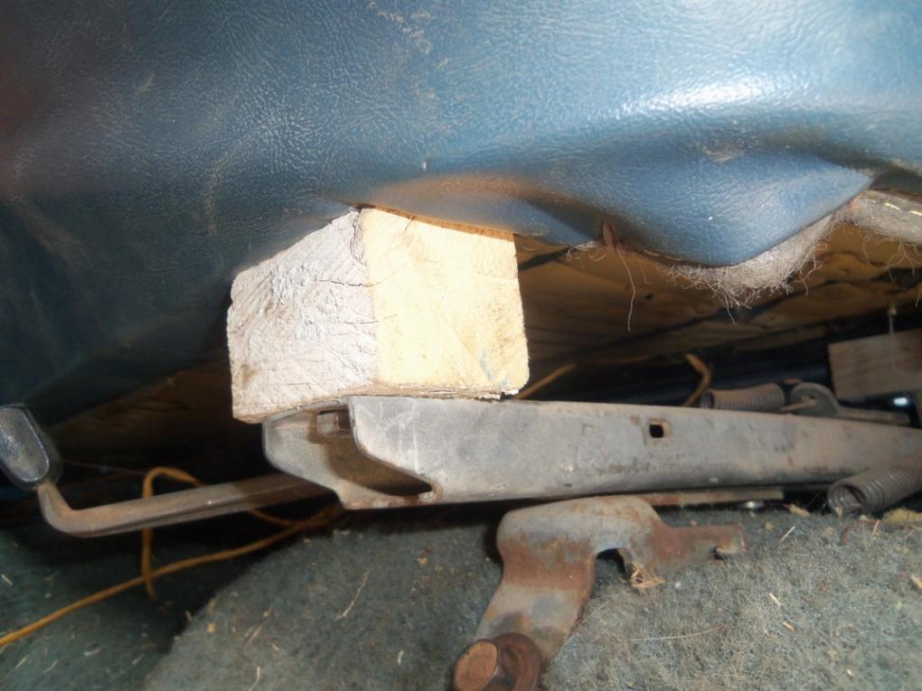

I also noticed, the previous owner of the seat I swapped, done some redneck enginuity and put a 1 1/2 in cut off of 2x4 between the seat mount bracket and the seat frame itself in the front 2 mounting pads. Looks kinda like hell, but changing the angle of the seat, making it a steep incline from the backrest toward the front of the seat made a helluva difference in the way the seat support your legs and takes the strain off my lower back. If you aren't aware of, or catching on to what I'm referring to, I'll get you a pic. I wasn't going to mention it on the forum, because even I had to laugh when I seen it, but I'm telling you, it's worth the laugh in relief of the back pain, espeically for that 70 mile drive to my dads property, worht it. You could always use some kind of metal spacer and longer bolt too, then it woudln't look so redneck like.

this thread is useless without pics.i just want to see the 2X4

WTF??? Are you saying you want to see my wood???
47,017
9,029
So I get out in the heat just to go get a pic of my wood. Sure hope you appreciate it. As redneck as it is, it makes a huge difference. Just seems to me the redneck could have used something as a spacer and do the same thing. I doubt mine will stay this way long. I'll come up with something better because I'm going to do it to the other truck too. :grd:
