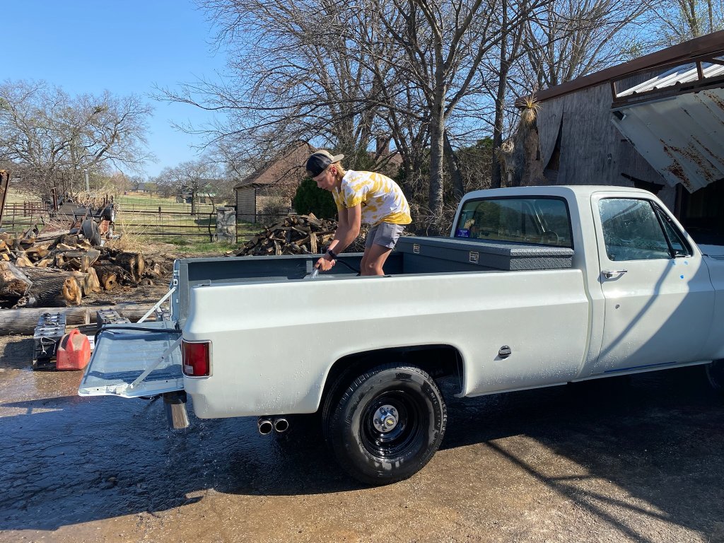

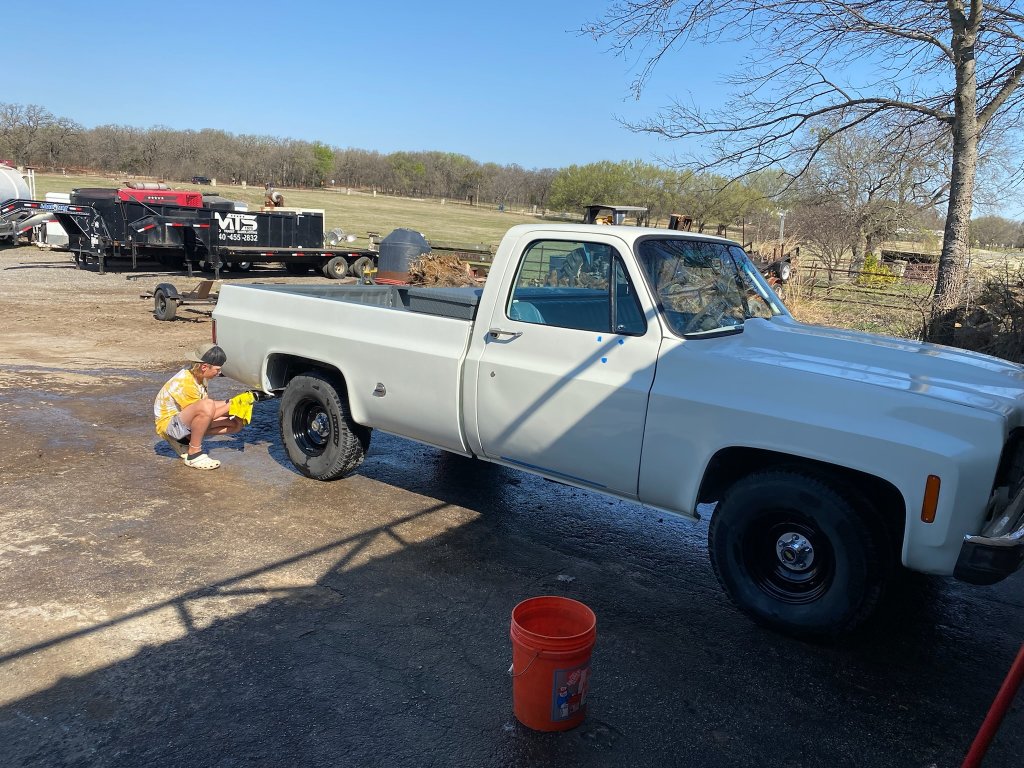

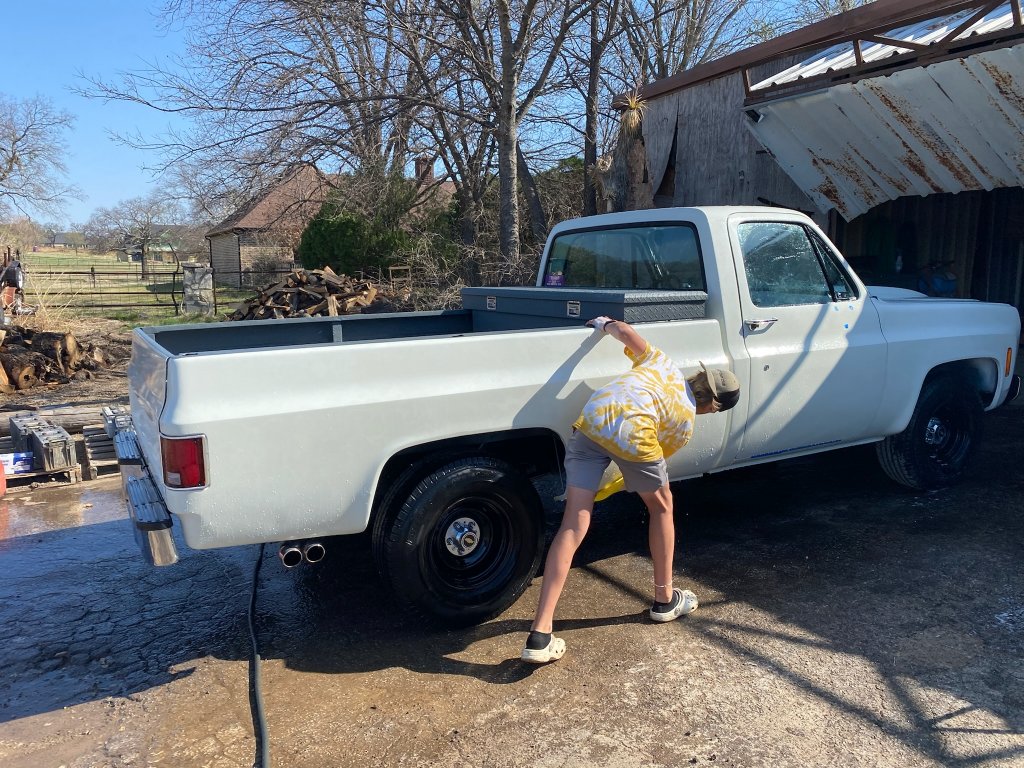

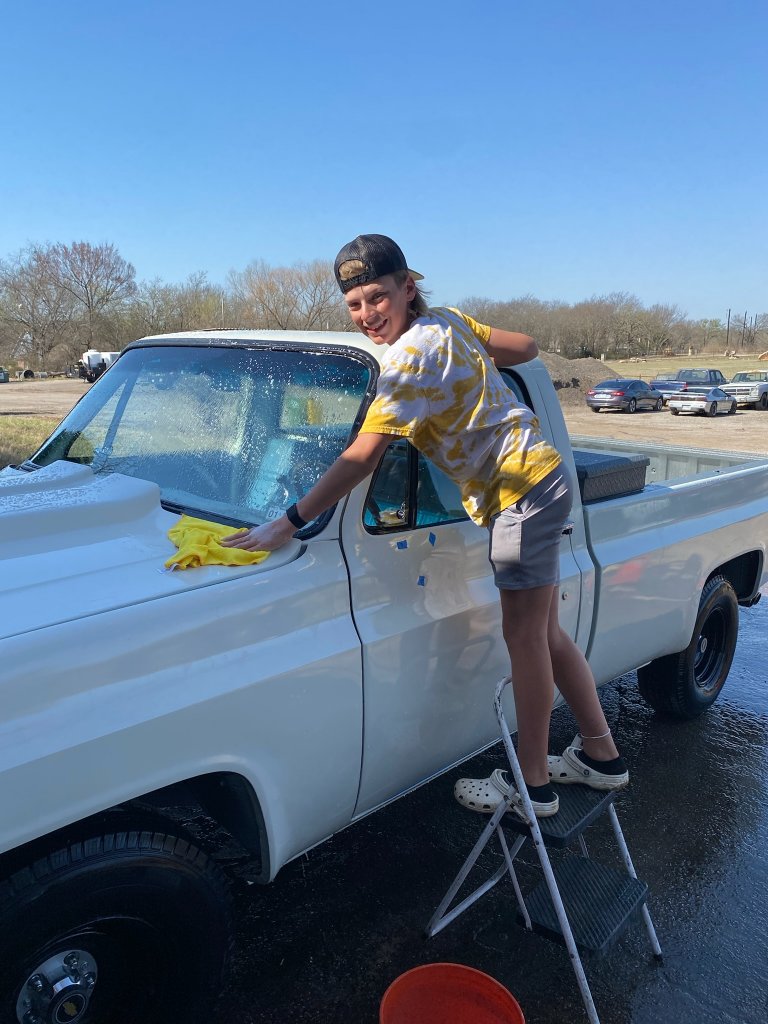

We’ll see, left them for now. When we get steering back in, we will tackle the front body panel alignment issues. Will be interesting to see how all that shakes out. Good thing is that its a 15 year olds restoration and it only has to look good enough at say 60 mph.. so I think if we are in the ballpark he will be happy! I will keep y’all updated
