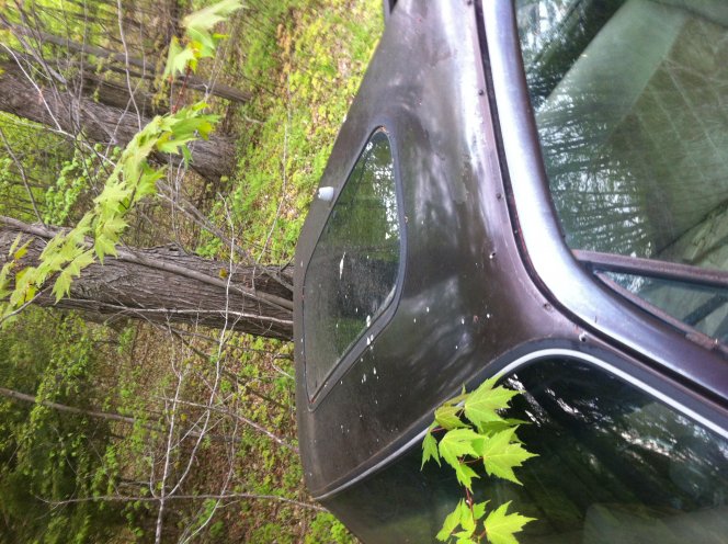

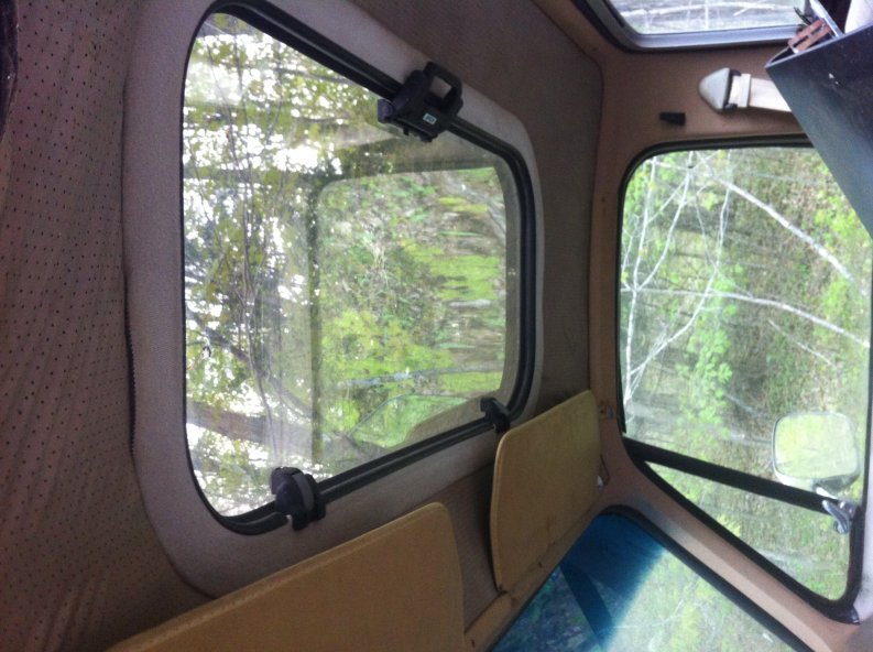

Gonna be getting this truck one of these days and thought the sunroof was pretty unique and looks very professionally done. just wondering if anyone has ever seen one before or what ya think of it

I've seen them. Most are leaky

got ya. i think this one is good. i know its been sitting out back for at least 10 years and my brother clams its never leaked but i guess ill find out when we start restoring it

Yeah...just give it a good look over and make sure it's sealed real well. I think they are cool myself. :)

My '84 has one, besides that trim strip around the inside, it looks identical to the one in the pic. It pops up at two different levels and is also easy to remove completely. You can do it all while sitting in the truck. It doesn't leak either.

Looks cool! See if you can find a replacement gasket :) kinda wish I had one

I have had an unused one sitting in my shed for about 10 years now - never had the balls to cut into the roof to make the install.
A heads up on these aftermarket roof windows; As far as installation, you're probably going to be on your own. Due to a very high incidence of leakage after the installation, most auto body/auto glass shops will not touch them with a ten foot pole.

Yea I have an old sky-top sunroof in my crew cab, its a PITA. Its one of the huge motorized ones. When I bought the truck it was stuck closed, so I had to use seam sealer to seal it up. It still leaks, but at least now the drains can handle it. I wish I had one like the OP, it looks a lot nicer and looks easier to keep sealed!

I put one in 84 k20 that i had never leaked and looked good i had to space inner and outer roof apart by half inch so it seal

I had an old ford pickup, years ago, it had a leaking sky-rooof init when I boughtit. Leaking sunnygun, I removed the durn thing, removed all the previous layers of sealant, installed the spacer brackets in proper, so it`d have a squish affect when the screws was tightened, resealed the goofy thing and it never did leak after that, except for one little drip, right where the ends of the glass gasket come together, a spot of silicone fixed that.
