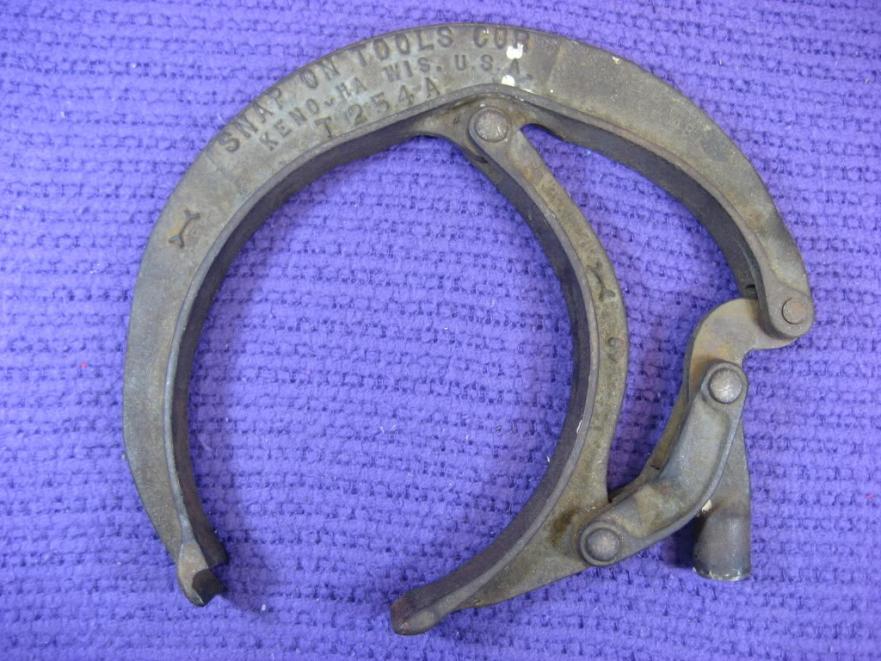

Change one set of tires and this tool is paid for more than once. :waytogo:
http://www.harborfreight.com/bead-b...-782A-E011-B31E-001B2163195C&mr:referralID=NA
This is the tool I used to use, I can't figure out wtf happened to it. It grew legs I guess. :flipthebird:
