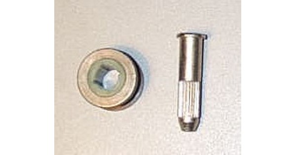

Huh. GM parts even. Nice! Do you by chance know of an upgraded replacement for the tension roller pin? I have to replace them on my '90 and the Dorman replacements seem to be questionable in the quality department.

I wonder if you can modify to use this pin/roller?
I believe it is too short, but I have not measured or even compared the hinges. I think the reason that the truck style pins are the full length type is because they need the double shear strength since the roller is mounted further away from the hinge.
Mine are broken where they enter the lower part of the hinge. They are still there and functional, but they cause a very annoying 'pop' when the door is pulled closed due to being broken and at an angle.
On passenger side mine is broken as well. F body uses a two piece where the stop pin then has the roller attached to it with a press pin. Might be similar workable set up with gmt400. I had dorman pieces to be installed, but might look in to making an actual gm roller from different application fit
