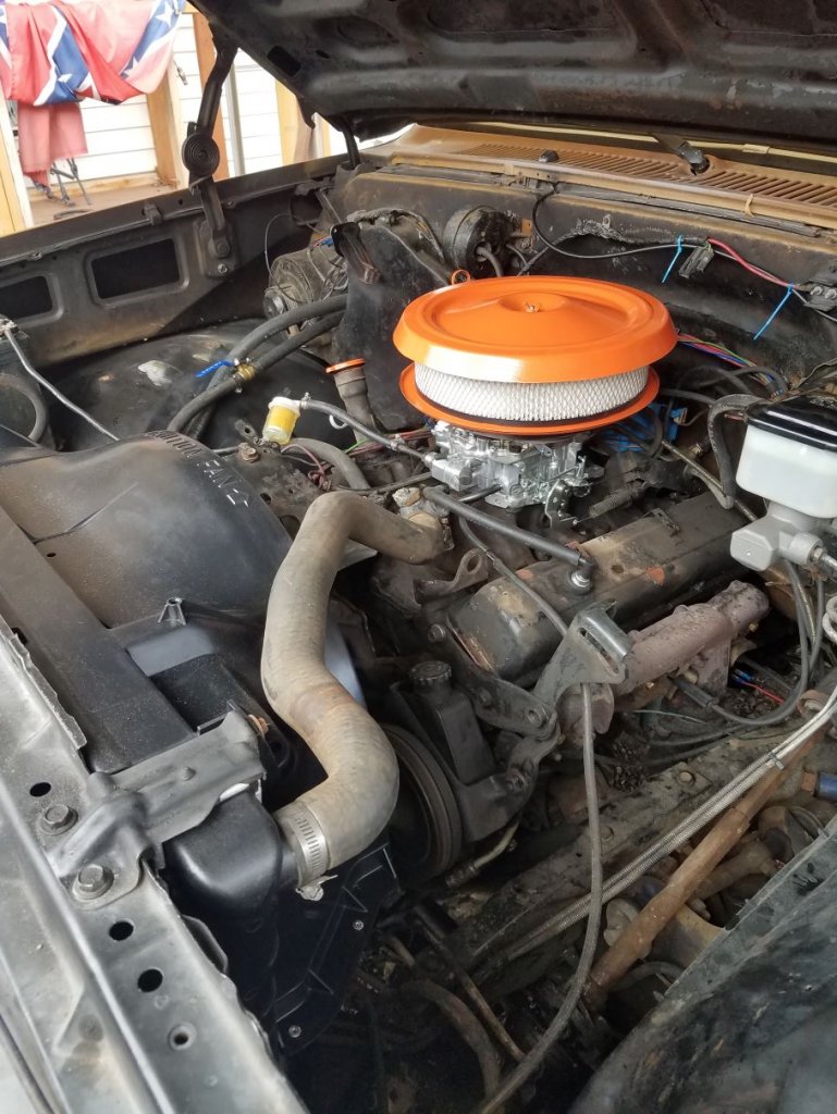

Setup on my 1988 V30.
Big block.

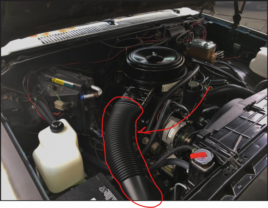

@Craig 85 or anyone else reading this, what is this part called? I can't seem to find it for my K20 or the air cleaner for that matter. I've looked up variations of snorkel tub and carburetor intake hose. I also think I'm just dumb however that's a different story :D
RetroC10Sport
Sep 29, 2010
17,250
2,702
Green Bastard Parts Unknown
Jay
2001
pontiac aztek
3.4
Air Inlet Duct. Part No. 14024595 discontinued.
