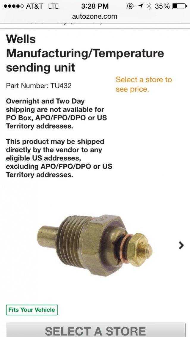

Next I replaced the temprature sending unit. I have an immediate change in cold start idle. It appears to be running smoother. Is the sending unit related to any other operations such as the electronic choke? Also, my temprature gauge is reading well past the 240 degrees now. I also believe I might have heard the ping again this morning but could not confirm because it wasn't consistent. When I popped the hood I was still able to grab the coolant lines. No smoking. Smooth idle. What the heck?!
My current plan of action is to place an stick thermometer in the coolant line where the it connects to the thermostat. I was also going to use a laser thermometer to check the radiator for plugs and hot spots on the engine.
Should I consider a gauge replacment next? If so what is the recommend reliable budget gauge? Are there other things or parts to test that may be going bad? Is there a possible connection or issue that is a result of the engine conversion that I will need to consider adapting over? I love the engine in Bertha but I'm scared to burn it up.
