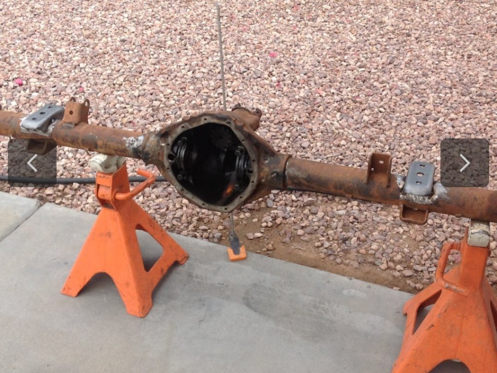

That’s great news then! I won’t be towing anything with this truck. Just after work and weekend cruises around town.
We question for you sir. Will a flip kit handle high horsepower? I just put a built 383 stroker and a new built 700R4 trans in the truck and it rips!
Will the flip kit be ok with the power?

If your worried about it install it and have it welded in place to the axle.
I have seen people running a flip kit on the 10/12 bolts that drag race theirs some probably welded some might not be never looked that closely.
Mine is a 9" with a built-in flip so no personal experience banging on one with a trans brake only that I've seen others do it.

No need to buy a "flip kit". Summit sells perches starting at $15 a pair. Weld them on and be done. No extra weird parts
The thing is if you use the flip brackets you don't need to sort out pinion angle or anything it forces everything in place where it needs to be by using the stock pads to line up the axle and set the angle then just weld them solid to the axle and the stock perches. They also have an offset hole to move the axle back, so you don't drive the yoke into the tail housing when the suspension compresses.

Its the old "two ways to skin a cat"
I just prefer a "cleaner" set-up. I like to ask myself, "how would the factory do it?" And I don't think that GM would use adapter brackets and move the axle back. Nothing wrong with them, just not for me.
I weld new perches on, cut off old perches. Cycle suspension to measure and shorten driveshaft. Perches are $15, driveshaft is is $200 shortened, balanced with new u-joints. About 3 hours work and no extra brackets that possibly interfere with lines or shocks.
