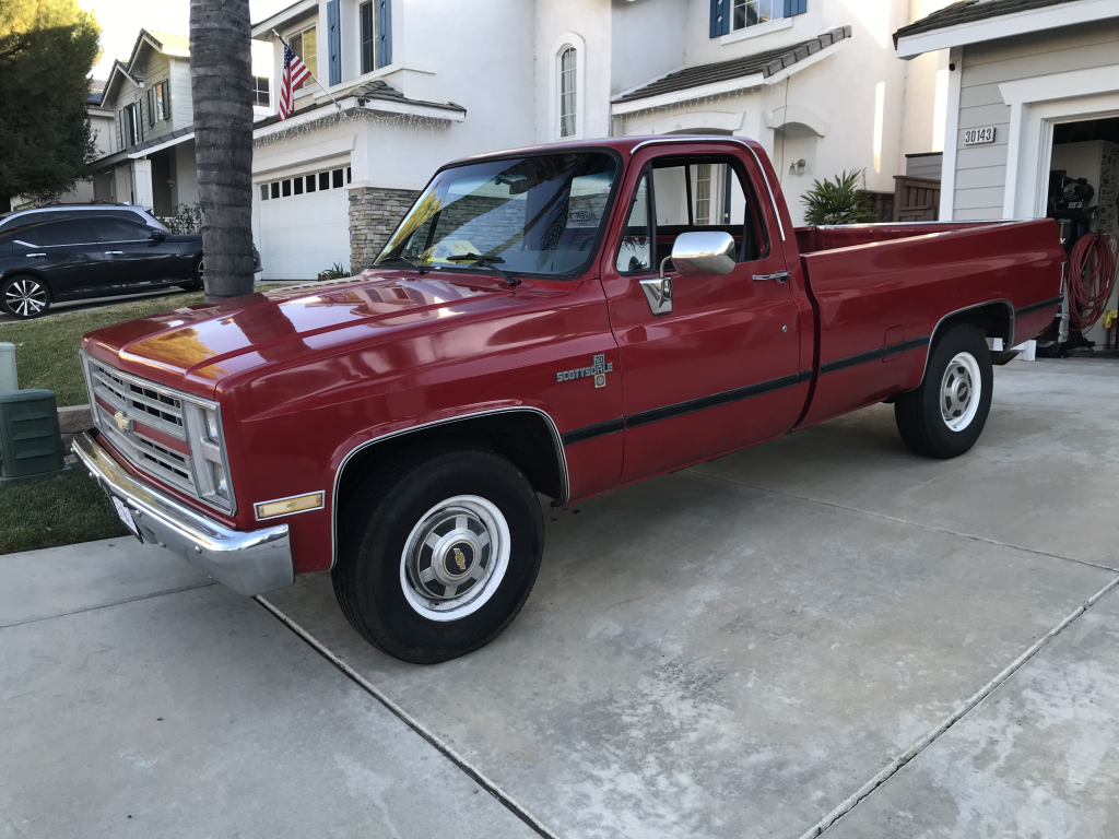

    I just picked up a 75 c20 and I've been doing research myself about a 5/7 or 6/8 setup.
    They recommended 28" front tires with their kit.
    Most likely I'll use their rear flip kit and pull a couple springs from the leaf pack. 1.5 coils cut off stock springs and 2.5-3" drop spindles as well. I "hear" a lot of guys just go to c10 axles but I want to keep my stock wheels/axles. [​IMG]
