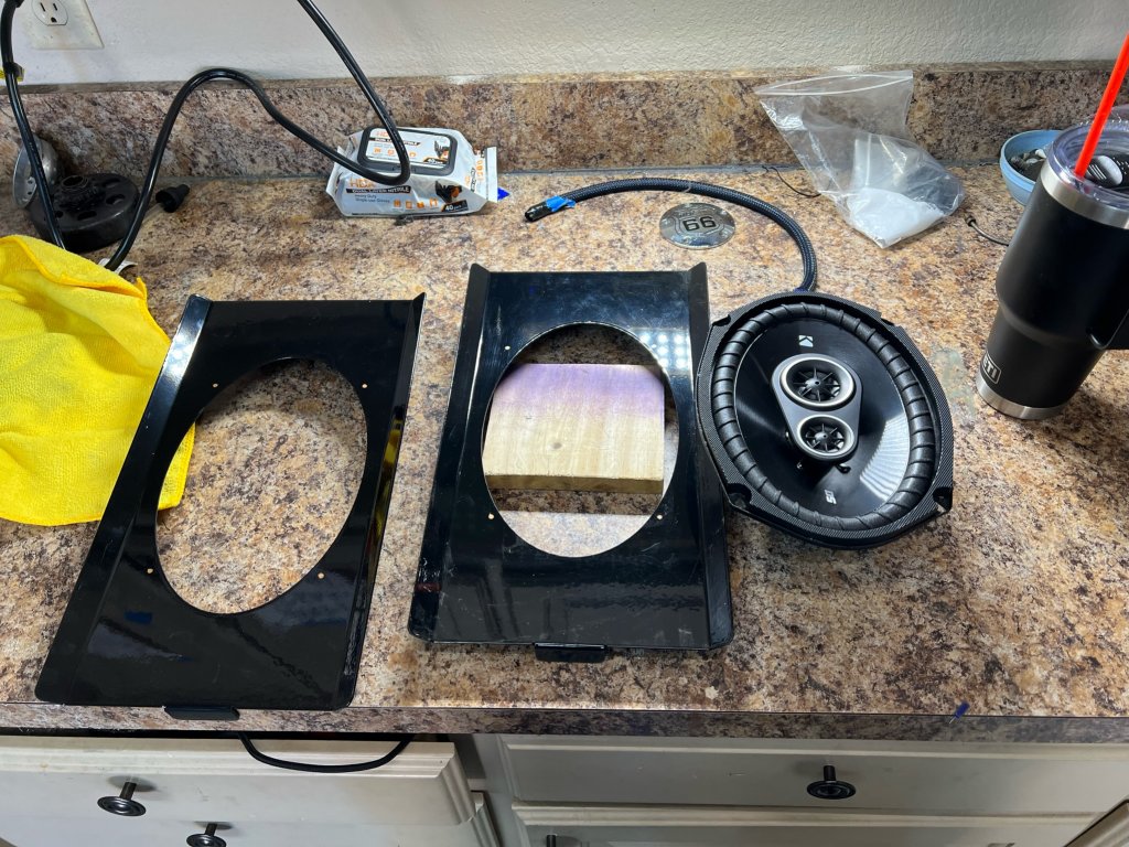

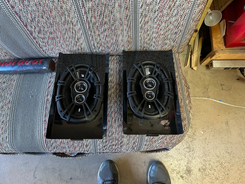

C-10 LWB
Yes with Kicker 6X9’s

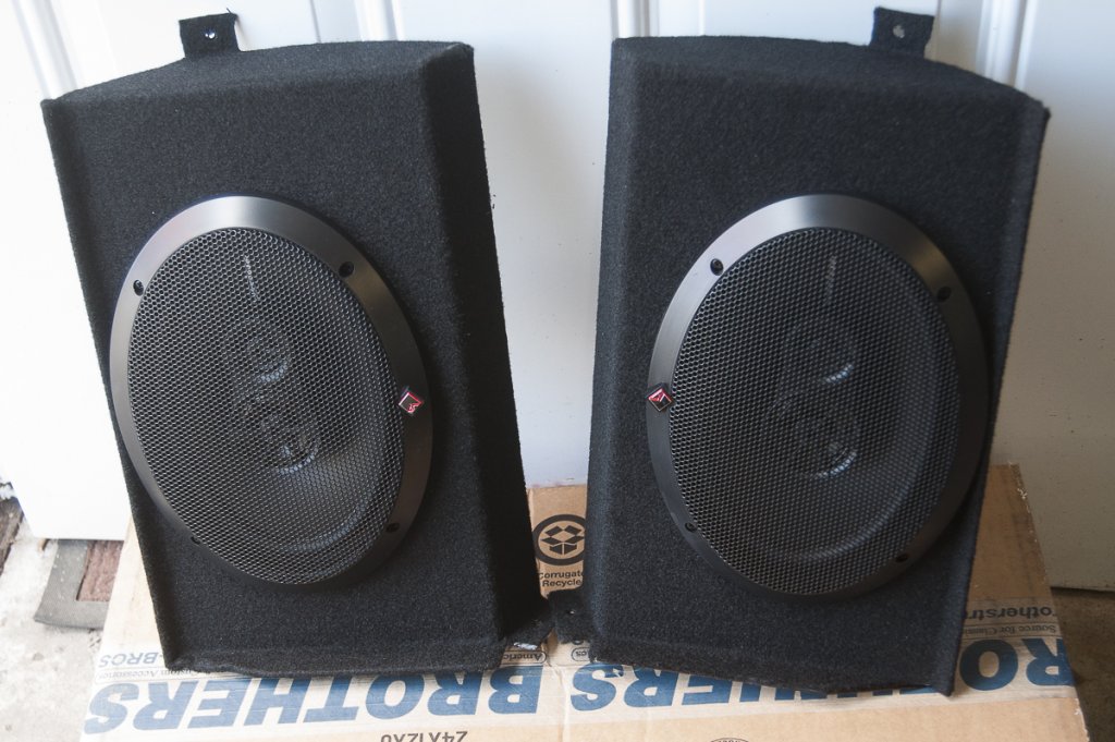

The magnet size is determined by power handling and magnet type. If you aren't planning on using an amplifier then a bigger magnet will just take away from the sound as you won't have enough power to run the speakers correctly.
If you are planning to run an amp then I usually do like 45tt and build a basic speaker pod out of 2 pieces of wood that fits what you are installing and cover it with matching carpet.
it shouldn't be much at all like under $20 to build both speaker pods.
Feel free to ask if you need any more help. I have been an audio installer for almost 30 yrs and have 2 Squares plus built 15 or so nice Square trucks.
This is the only one on this computer but it came out nice even before paint.

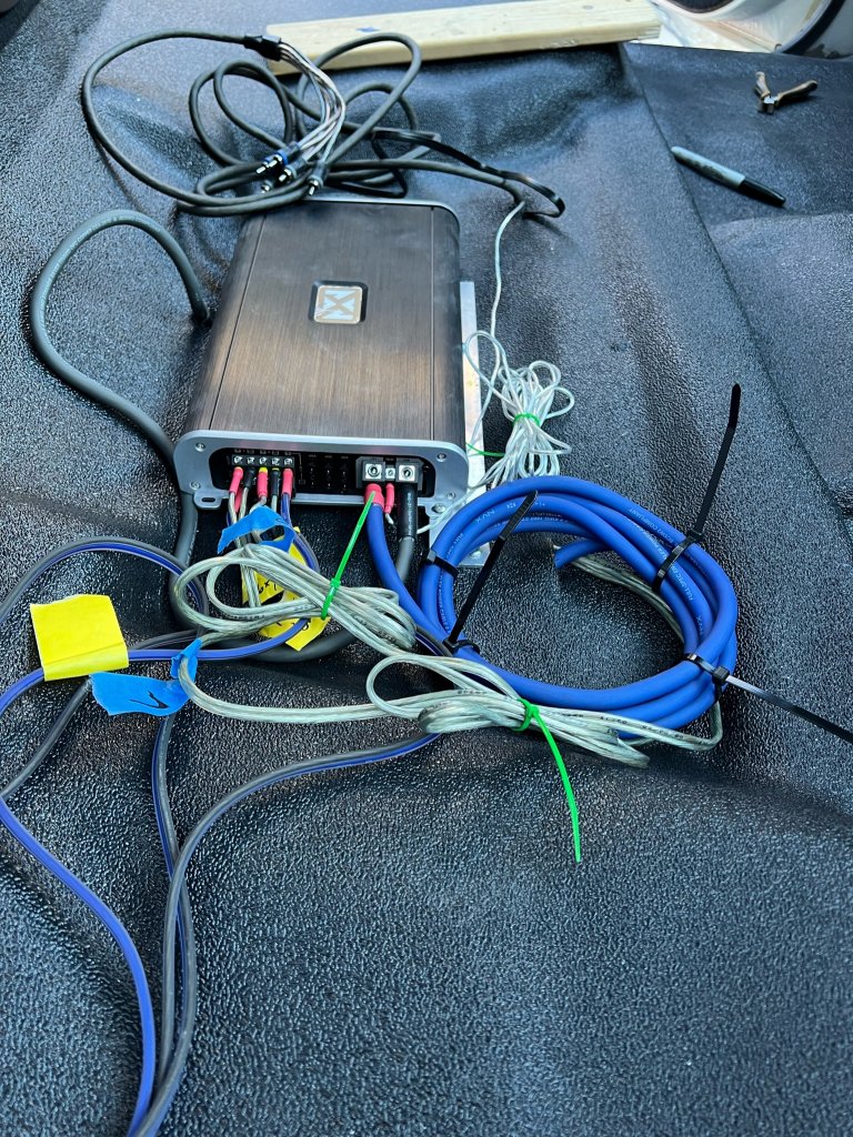

Are you guys running amps or not?
I'm running 2 Alpine 2 channel amps that I bought new in 1989. 1 for the front speakers, and 1 for the rear. Plus a cheap Kenwood 2 channel amp, bridged, for a single 10" Subwoofer.
I'm not into thumpin, but using a sub helps keep the other 4 speakers more bright sounding.
