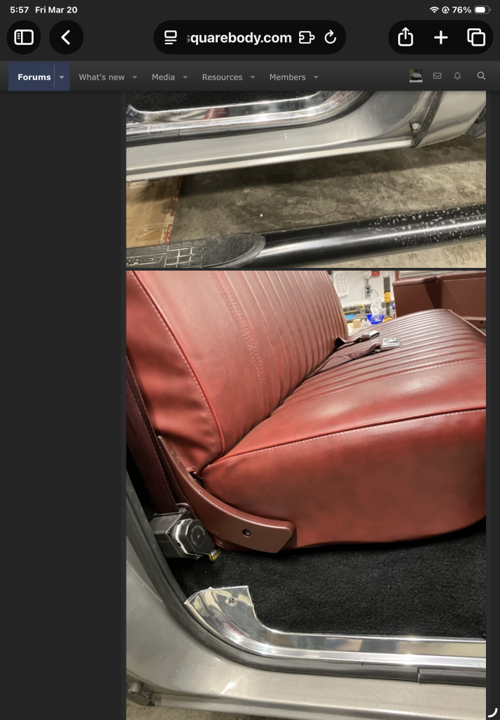

Without pics it's just wind....
The "Search" function here will show numerous seat belt discussions.
Those big original plastic colored seat belt covers... in my '78 the retractors mount to the floor and the covers were basically just cracked plastic bits.
The replacement retractors I've found don't have covers, and with them there's plenty of room.
It would be a good 3D printer project to make one....

I'm assuming you have the same retractor as our '76 shop truck. Without having one of those brackets on hand, hard to say, but I think it'd be pretty easy to modify to work. I think you could get away with cutting a slot for the bottom retractor mount to slid into the speaker bracket and just slip the speaker bracket behind/around it.
Oops, I had just assumed his '77 were like mine... but I didn't have a pic.
There's another difference in these trucks to make note of. :)
I already replaced the dash speaker with a 4x10 from Classic Industries. I was looking to find someone who might have a pic of a custom corner speaker mount for the rear corners behind the seats like the pic above. The problem is the brackets you can get for a 6x9 are too tall and you can't mount them in the corners or cut them down because the seat belt retractor is in the way. I might have to do some cut, chop, rebuild stuff to some sheet metal or figure something else out.
7,057
26,354
Without seeing your retractor this is just a shot in the dark. But the retractor I posted has plenty of room behind it for the speaker bracket to slide behind it. It mounts up top to the rear cab inner panel, then it only has 1 leg mounting it (that silver bracket on the bottom of it) at the bottom that's up against the door jamb. I could def make a 6x9 bracket work in this truck with nothing more than a notch to clear that bottom leg. If you have a different retractor, I could see how it might be more difficult or impossible but with this style, it's definitely doable

Here with the same search. Normal corner setups will not fit due to the mid-way up the door mounted retractor that Hucked posted. Currently considering just throwing a couple of small boxes in behind the seat.
