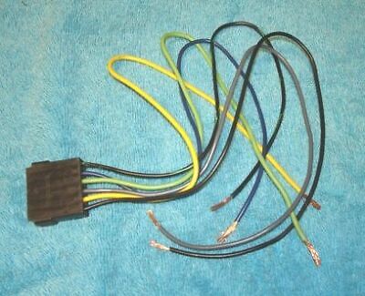

Looks like it does have the terminals for LR and RR and a ground right above the front speaker connection. I guess it would be in mono but at least it has the ability to push 2 rear speakers. Does anyone know what kind of harness connection I need get for that? Could I just wire directly to those metal prongs if I can’t find a connector to fit that?

I wonder if that radio was maybe added by the dealer? In a Google search, that style radio plug wasn't used with GM radios after 1972.
But anyway, a '71-'72 car would probably be a good source for the needed connector. There's some on ebay right now.

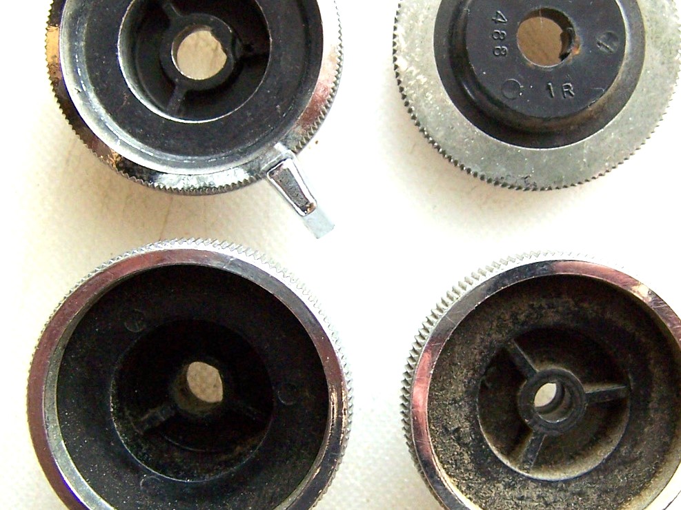

They did use that style connector into the early 70's not sure when exactly it changed. Just because it appears to have output for stereo doesn't mean it is connected to anything.
Picture below, top are stereo knobs bottom are not. Shaft for stereo knobs has a cut out that indexes to inner raised area of knob.
Yeah I will have to connect a speaker to it and see. It’ll be the only way to know for sure

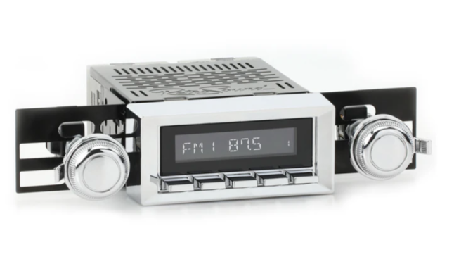

If you decide to set the original radio aside, you can get a more modern type head unit from Retro Manufacturing. The truck I bought actually had one (poorly) installed when I got it. Now its wired correctly its not bad. Also has bluetooth/aux cord connection capabilities.
This pic is real similar to what I have and would be super simple to get all the extra speakers you want, even a subwoofer if you're into that sorta thing
