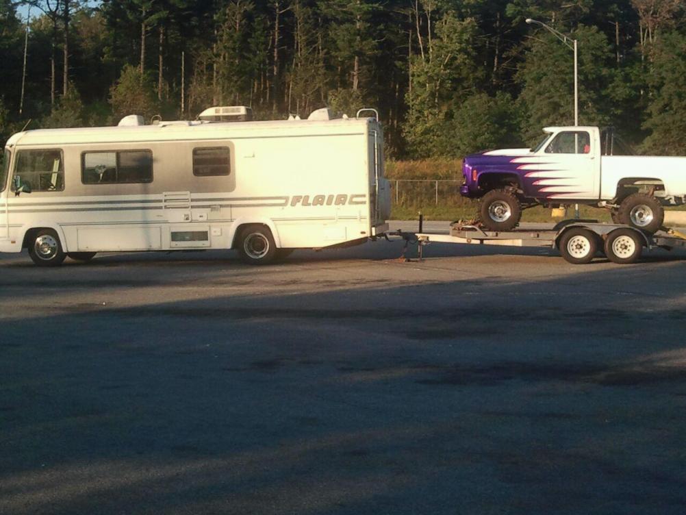

My RV is all stock with 100k miles. I dont like to push it but it will do 85 mph with out the trailer. I feel it cruises @ 60 -65 mph getting 11 mpg .With the trailer it is struggling big time. Its a 28 foot p30 chassis 454 tbi with a OD trans looks like a 4l80 that has been rebuilt. GVW of14,800
I just want to go to the mud runs 4 hrs away@ 65mph and not to have to drive the ford pulling the truck and the camper 2 x the fuel and tolls .
I wonder what fleetwood spec. cam was
