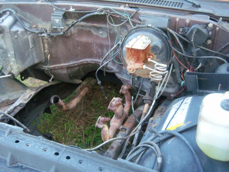

Pisses me off. I have the left side of that one on my 85C20 bent frame truck, but they kept the passenger side unit. I hope someday to find the match to make the set.
