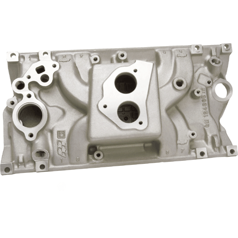

Here is a link to an intake manifold that fits for my exact application but does not have an EO number and I can therefore get no input from GMPP regarding smog:
Assuming I paint this intake manifold satin black/factory color, would you think that I would fail visual?

I don't think anyone can answer your question definitively. It's probably going to depend on who does your visual inspection. But the emissions laws state factory, so you know they are going to be looking for a EGR valve and smog pump. I doubt that most of the guys looking under your hood are going to realize it's got vortec heads on it and even if they did IDK if they'd actually fail it for that. But certainly it needs to have an EGR, smog pump and cat. All of which you could run full time, all the time and it's not going to hurt anything or rob you of any power if done correctly. Good luck with whatever route you decided to take.
