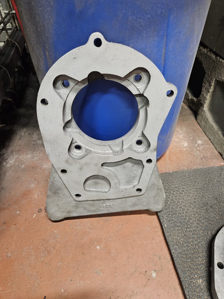

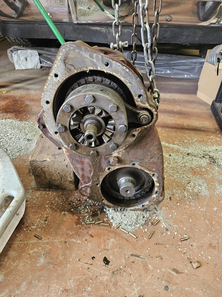

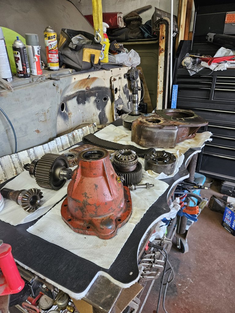

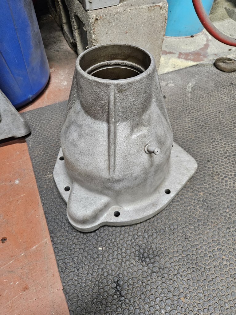

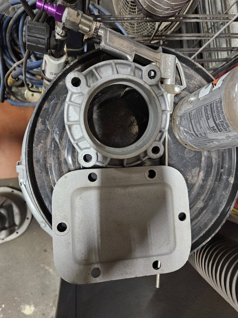

Got my 203 disassembled (mostly) Looks good on the inside. Gears look good, no major wear. Everything got a diesel bath. Started laying out the parts. Still have some disassembly to do. Started sandblasting to prepare for powder coating.
I have a question. I have a 10 spline front yoke. Should I change out the front shaft for a 32 sline like the rear? Does it matter? I want to upgrade to a 1350 yoke, 10 spline 1350 jokes are hard to find, or really expensive.

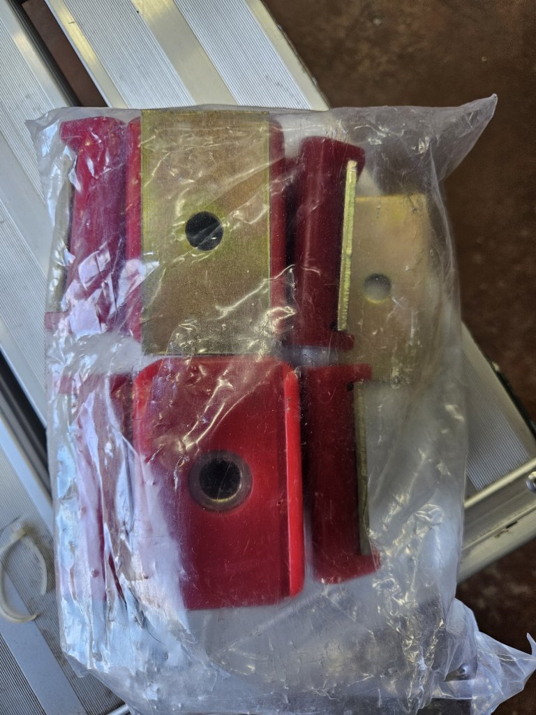

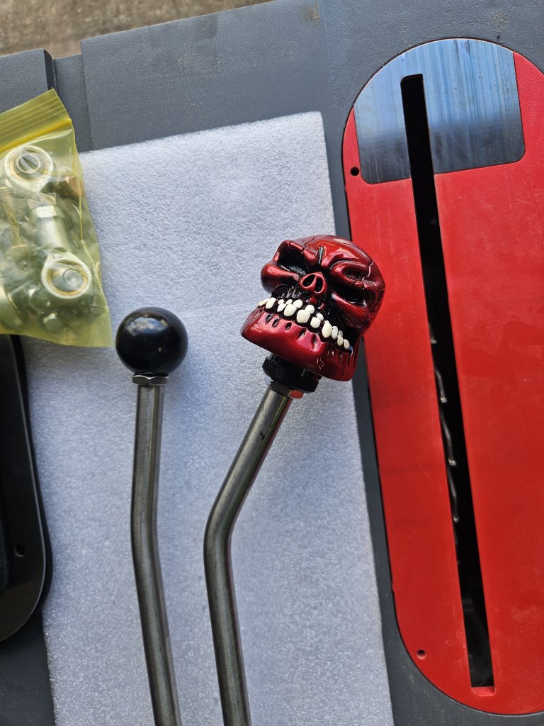

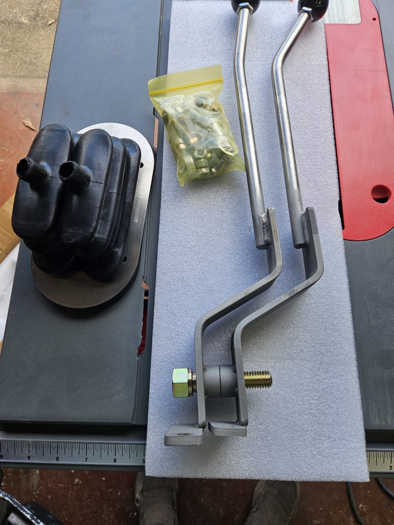

Got a set of twin sticks. Getting another skull for the knobs. Also got the polyurethane transmission mounts.

Ebay... they are for a 205. It was 100 bucks ish
