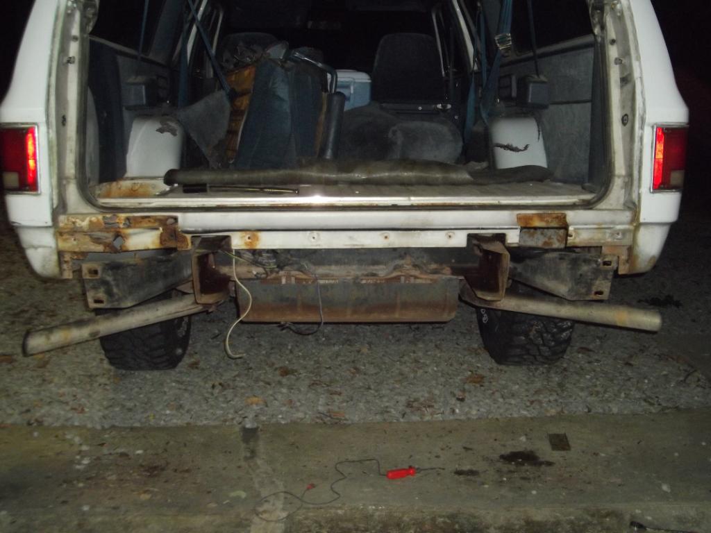

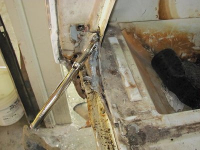

I tried finding someone to do this for me but no one seemed to interested so here we go. So far all the bolts have came right out on the top side. I've had two hing bolts break on the tailgate hinge but thats ok it' should come out no problem and i'll get new bolts all the way around anyway..

i got a couple up thats all i got tonight i'll work more on it tomorrow.. trucks not going anywhere for awhile until i get this fixed

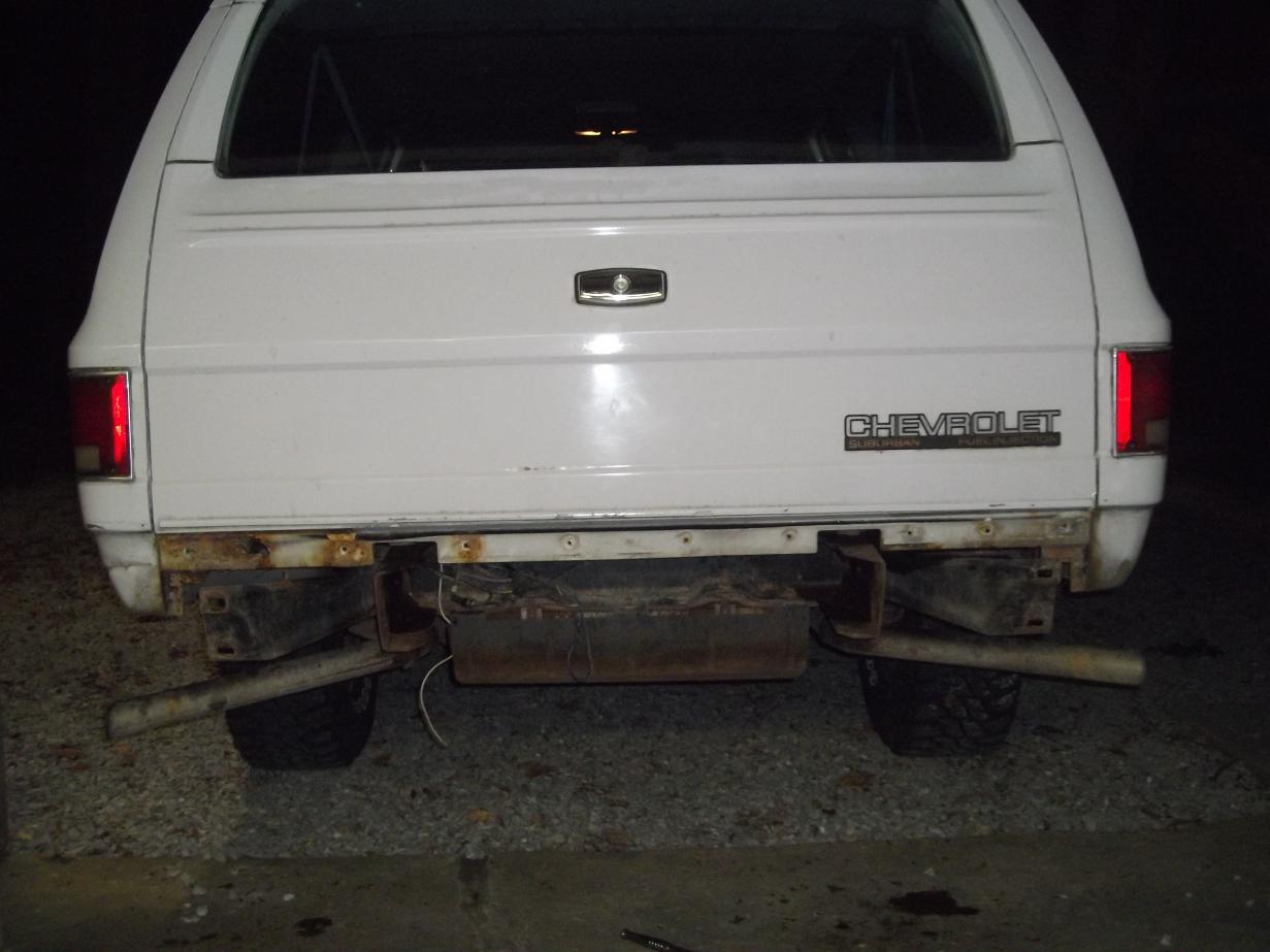

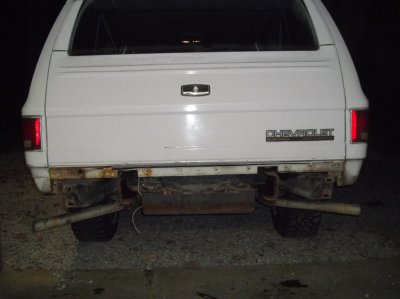

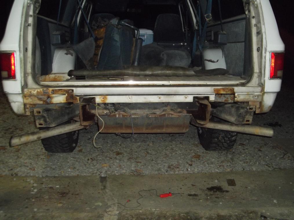

Day 2 of Step by Step Removal
Step 1-3
1. Remove Bumper
2. With Help Remove Tail Gate
3. Remove all bolts, then pry corners away from seam

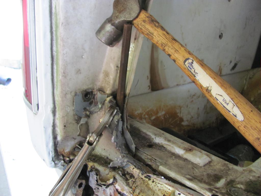

Step 4
Start pulling corners outward and with a cold "harden" chisel pop the spot welds two on each side

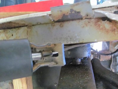

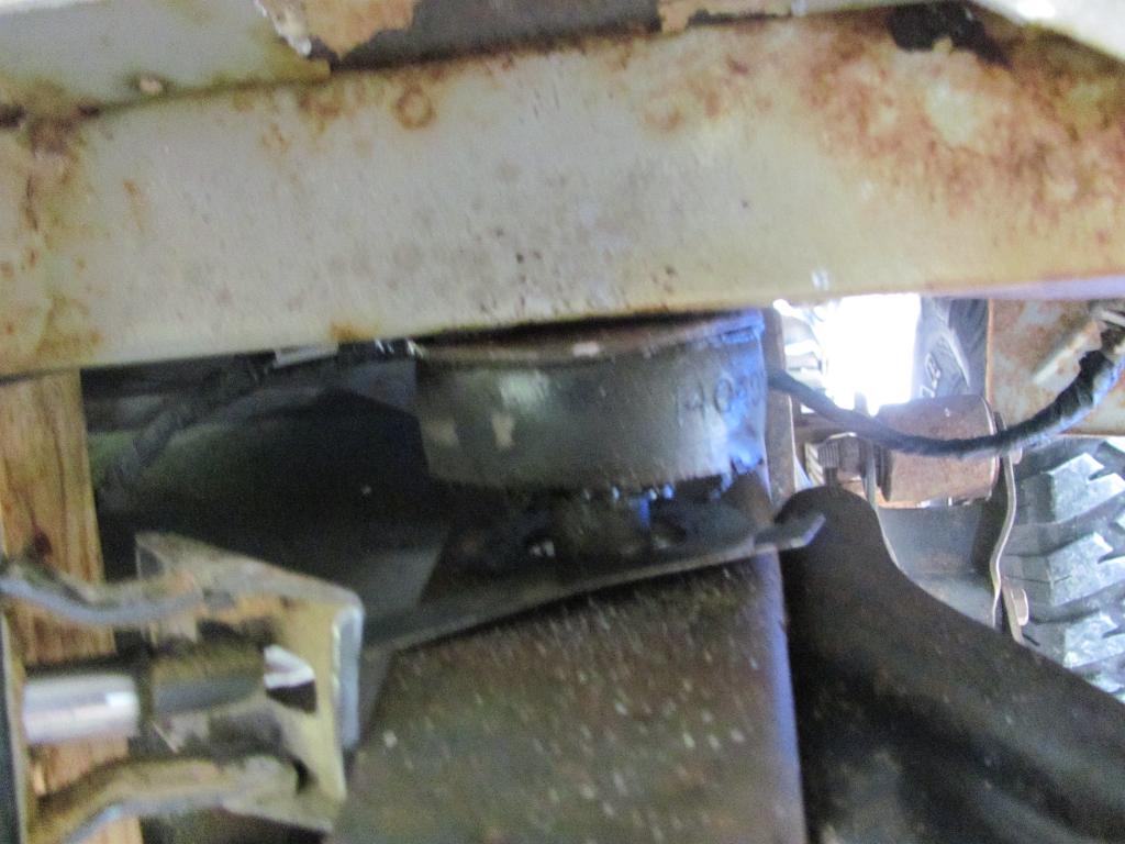

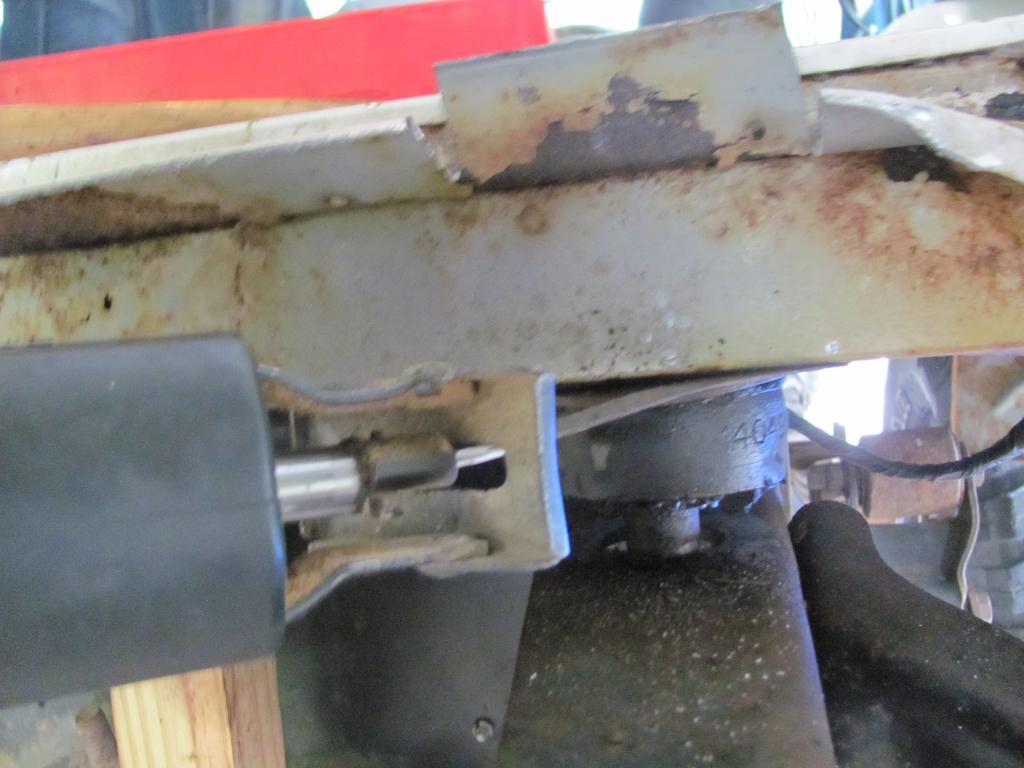

Jack up the tail pan about two inches enough room to cut the body bolts .. only if yours are siezed like mine were, cut on both sides of bushing.

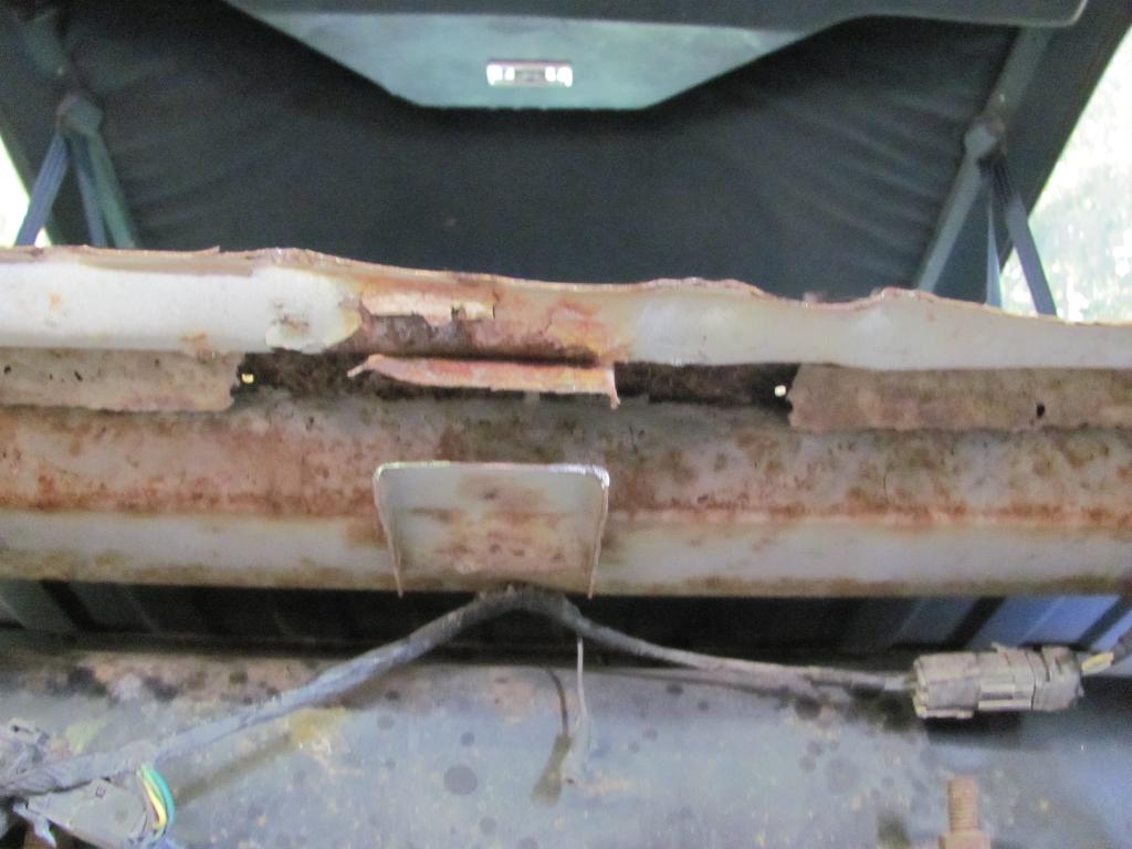

After all bolts are removed and body bolts are removed, lower the tail pan down and slip something between the tail pan and the bed, very gently pry it down then cut it into three sections, makes it easier to remove clean up and inspect inner fenders.. i'll be looking for some new inner fenders now so it will be awhile till i post again i also need tailgate posts.. we'll see what i can find, LMCTRUCK is my best friend right now LOL
