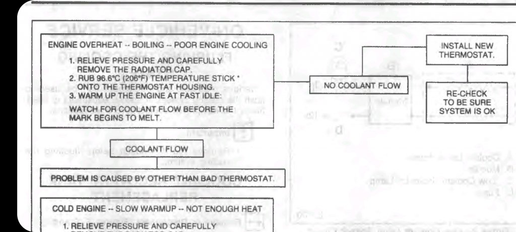

check the thermostat operation like this

if thermostat is ok, next in the list is radiator cap. is it new like the radiator? I am assuming no visible coolant leaks. after that is the serpentine or V belt tension (your pics show the 87 is a mixed belt system). after that is upper hose collapsed. after that is obvious radiator blockages (check temp across radiator as described in manual). if all that checks, I'd suspect the water pump or plugged passages somewhere as described in the "unusual" problems section.

@gmbellew is a coolant stick something I can get like at a store? I read it was just a pencil like wax stick. Yes the radiator cap is new I bought a new one when I got new radiator. The belts are new(all three) and there is no tensioner, you set the tension by moving the alternator power steering etc whatever that belt is spinning. The upper radiator hose is new approximately maybe 7 months? I’m going to try and get a temp reader thing today and read the temps of the engine all over, check radiator in all spots, hoses, thermostat housing, heads, block, intake manifold, etc.

I am not sure if those wax sticks can still be found. if you plan to have an IR thermometer, I'd just use that to monitor thermostat operation to test it.
