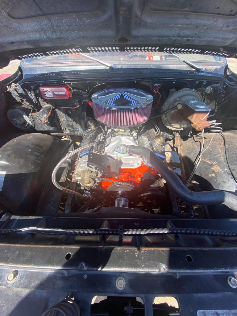

Ok, the new engine is installed and running, should have some track times soon when the track opens. One thing I noticed is it spins the slicks in high gear from a roll now, it didn't do that before. From my estimation I put 20% more TQ to the rear wheels on this build. Shooting for 11s in street trim with slicks and mid 11s in race trim. My next move is a aluminum drive shaft, then possibly shortening the bed to a short bed, then I'm done. After driving it around yesterday, it drives every bit as good as the 327 did, and its exactly what I was looking for.

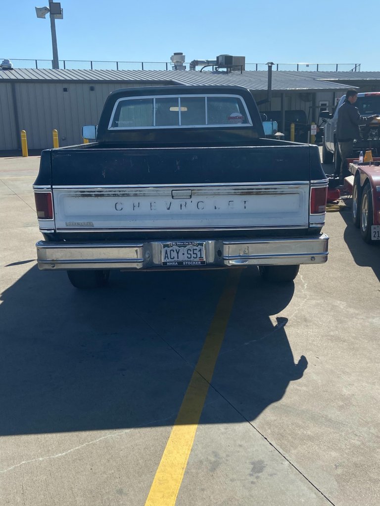

Well I got Shop/Race truck
to the track today. As usual the condition were good not great. I ran the truck as I drive it on the street, power steering and all.
1325 DA
29.52 Barometer
70 GOW
Run 1.
60 foot 1.59
660. 7.28
660 MPH 92.7
Run 2.
60 foot 1.42 rolled the light, foot brake wouldn't hold
660 7.33
660 MPH 93.1
Run 3.
60 foot 1.56
660 7.22
660 MPH 93.15

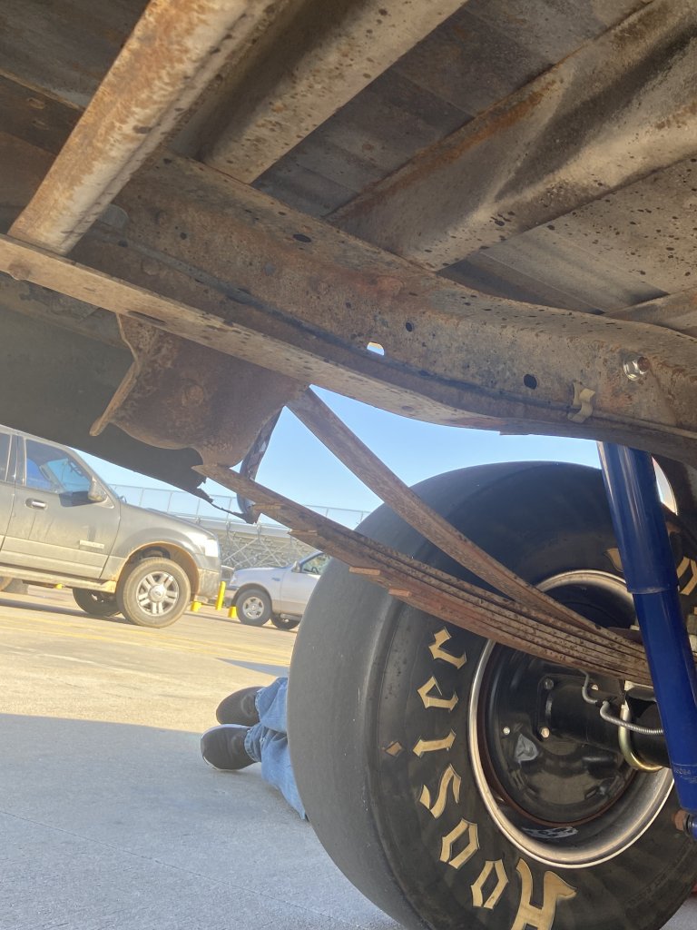

Damaged the leaf springs which ended my testing.
I will post video and pictures of the testing. If the conditions get real good I will put the truck on kill and get the 7ohs.

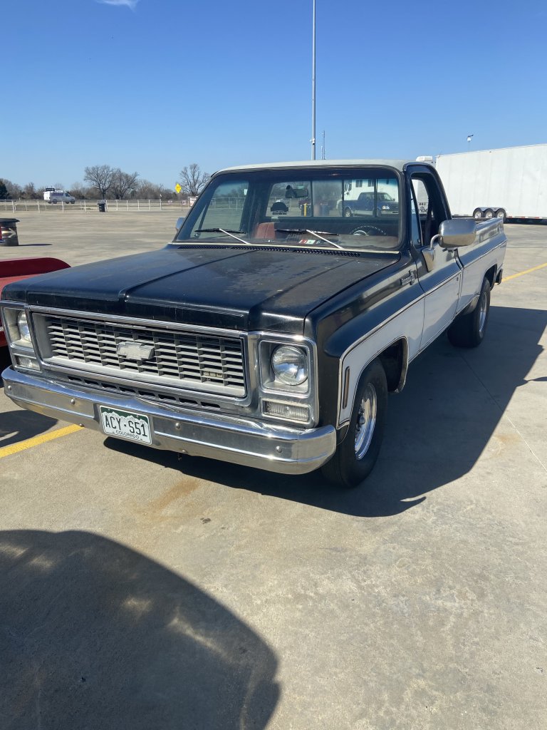

Ran a new best today:
7.04 @ 94.15 1/8 mile
1.50 60 foot
So close to having a 10 sec truck, its making me want to do just a little more............
