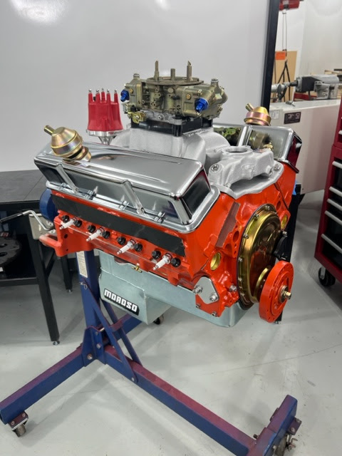

My new goal is to make my Big 10 run 11.50 ETs at the drag strip. We did a complete rebuild of my Turbo 350 transmission and found several things my previous builder did that will slow the truck down, I believe the trans rebuild will be worth at least .2 off my ET. My new engine will be a .060 over 350 with a solid lifter cam and 291 double hump fuelie heads with 2.050/1.60 valves, Performer RPM air gap intake and a 850 Holley. MSD 6 AL ignition will be used. I will post pictures as I go.

Look great Mark. The shop where I work has been in the same location for about fifty years, and they are Chevy guys, have a bunch of 2.02's....watching the progress. What are the cam specs?

Cam is a solid flat tappet 264 @ .050 .528 net lift, 108 lobe separation, with a 1.5 rocker, might go 1.6 on the intake, very mild lobes that will live on the street. My 327s cam was 480 240 @ .050.

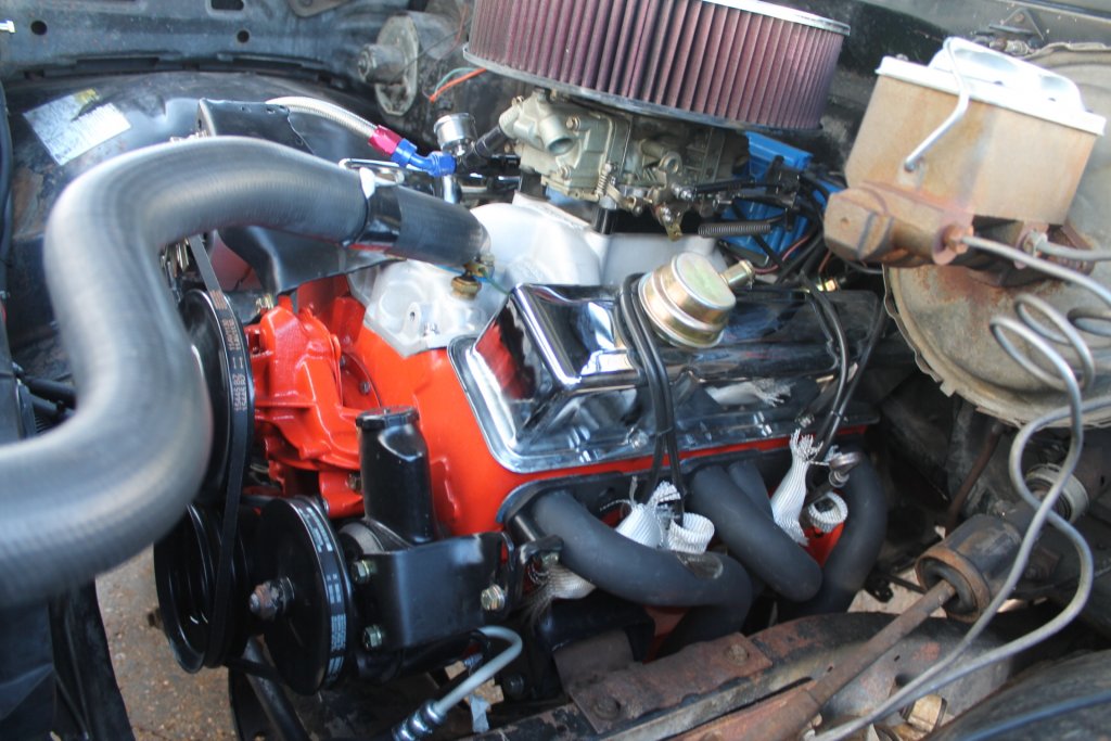

I like production parts, no rules, I just want the engine to look like my older 327 did. I drive this truck a lot and enjoy it, its certainly no show truck, we just like it how it is, a picture of the old 327.

Killer mouse! I'm curious at what RPM those peaks were?
