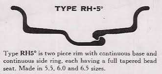

I understand that, but anything is dangerous if you don't know what you are doing. Daytons are NOT the "widow maker" rim. The rims that got the widow maker name can blow apart and kill somebody just when driving down the road. I just looked it up to be sure, the Firestone RH-5 rim type is the design that earned the "widow maker" name. The rim is two halves and if there's any corrosion or imperfection in the locking ring grove, the two rim halves can separate. It's a very old design and other types got grouped into the "widow maker" name just because people didn't exactly know what they were talking about.

Daytons don't just unbolt themselves and kill someone, somebody has to actually make a mistake. That RH-5 type is a two piece rim that DOES blow apart all by itself and kill people, and an exploding rim has a hell of a lot more force than a rim/tire combo popping off of a hub. Really any locking ring type design is extremely dangerous if not done right, but the RH-5 type is the one that earned the name. By comparison, the Dayton type is very safe and is not a locking ring type.

I think these are the ones commonly called the widow makers, Firestone RH-5
