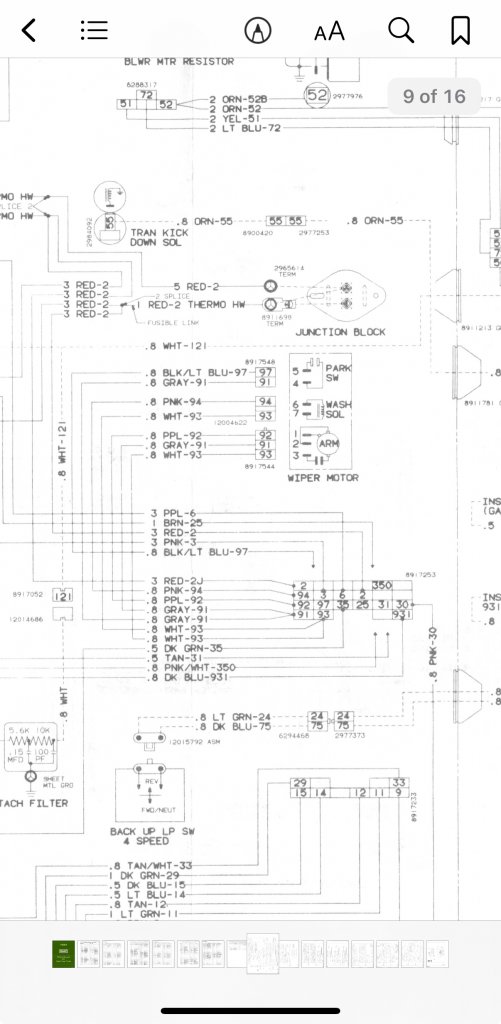

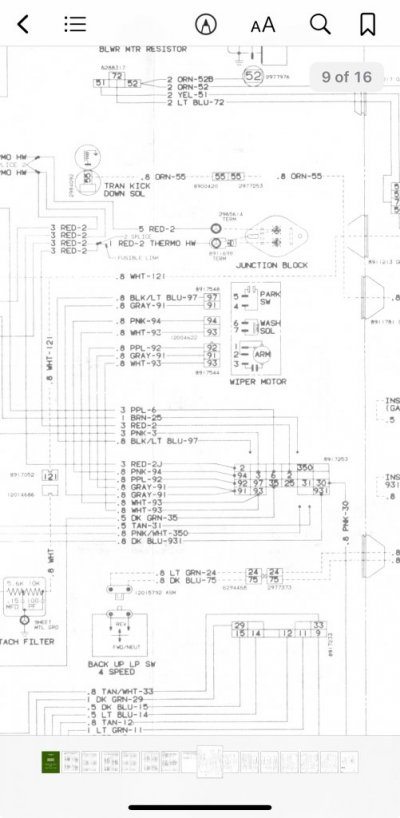

I have a 85 C10 two speed wiper system. I bought a new wiper motor and replaced it. I also replaced the wiper switch in the column. This does not have the delay system. So when I turn on the wiper switch it turns on the dash lights and not the wipers. I performed the wiper test using a jumper at the connector at the base of the steering column and when using the jumper to ground I can get hi and low speed to work.
Did I short out the new switch possibly? Any help would be great. I’m to the point that I may just run a toggle switch to ground to at least get the wipers working.

Broken85
Jan 14, 2024
310
449
Cumberland, NJ
A
Officially, Lights don’t cross on that system, nevertheless, here we are. I think The purple wire (but someone will correct me if not) in the harness is the ground and the motor is ground triggered. Unplug the switch from the harness. Check the switch for continuity with the purple and also the gray and white as you move the switch. For the hell if it, check for voltage. If the wipers work at the harness when you jump purple to gray or white, your problem is somewhere between the switch and the connection. Something is plugged in wrong or the purple wire is not grounded and it is somehow pulling a ground through the dash lights (sweet Jesus don’t ask me how that is possible). Check continuity to the purple with a good ground. If you don’t have it, then that might be what is happening. Good luck, sounds like a real head banger.
