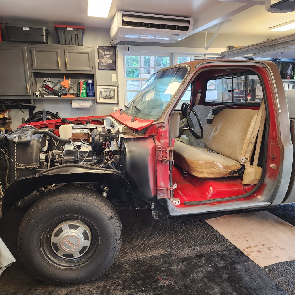

Hi There
Long time lurker, and I am having a problem that i could use the wisdom of the crowd... We have my son's 2500 broken down for paint so thought it would be a good time to fix misbehaving wipers. Long story short, first motor died, i replaced but the new unit was never right, first we lost low speed, and then was super slow and weak on high. SO - I bought a new unit and kinda worked, but wasn't quite parking properly.. and low kept backing off the nut..
I took the unit off the firewall and tested it and this is what i've found
- high - seems ok
- low - spins in reverse --> hence why the nut backs off -- is this normal? - i could just add a locknut if so... just seems weird..
- park after running- cycles over and over - doesn't seem to stop - i don't think it could know it's actually installed in the car?
Just want to verify before bolting it back in and possibly damaging the unit... i know the controllers on these trucks can go bad and are not sourceable..
Very worst case i can return the new motor and go for a detroit speed unit..

Update. I removed the unit and carefully tested the pin out. I think the motor is wacky. And I think the original issue, possibly which burned out the prior is a bad ground. Any idea where the wiper motor ground connection is on these trucks?
