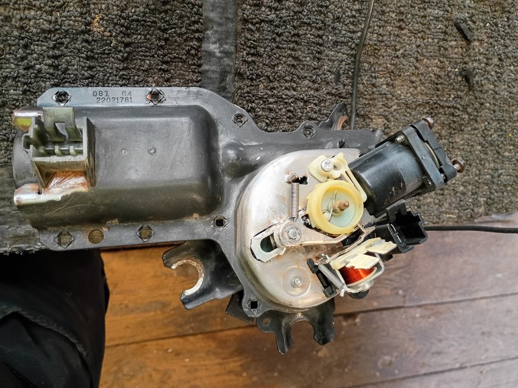

Good Morning everyone. I was wondering if there is a way to clean the wiper motor on my 84 Sierra? I live in Arizona, and although it's not near as cold as other states, my wiper motor is very slow when I first use it in the rain. I think I read somewhere that the old grease in the motor might be the culprit so I want to try a clean and regrease before replacement. My motor has the washer pump on it, but ti doesn't work so will try to see if it's plugged while I have the motor cover off, if possible.

wiper transmissions are most likely dry as well. Remove wiper linkage, 1/8" drill housing on back side, use a grease needle to lubricate. Seal hole with RTV.

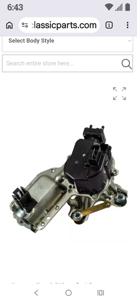

Another question about the motor. Looking at new ones online there's a ground strap on it. Mine doesn't have one so should I add one or does it matter?
