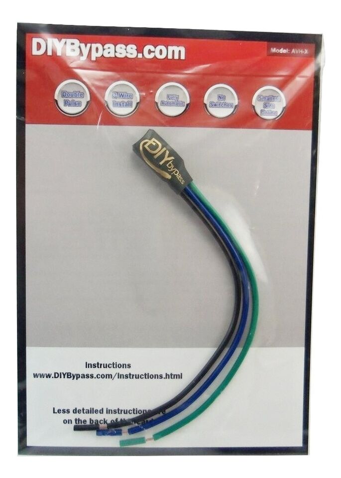

No “parking brake bypass kit” needed. You simply tie the brake wire into the ground wire. That’s all it needs.
Those days are over for any of the name brand units. For Pioneer, it is looking for you to wire it into the "positive" side of the parking brake, aka a parking brake dash light, instead of just grounding a wire. And....it wants you to engage, disengage, and engage the parking brake, before you can access a lot of menu settings (or play video while driving). Luckily, on ebay for like ten bucks you can buy a little module that you wire into the radio harness and it fools the stereo into thinking you've done this automatically.
I guess it depends…my $1700 KENWOOD DNR-1008RVS that I installed last year in my older Cummins just took a ground. Same as the other 3 HUs I’ve installed in the past couple of years, none of which were off-brand or low end.
Old school head units used to work that way, but modern ones don't.
They have made ways to make it harder to bypass. For example, some require you to apply / release / apply / release and then apply and leave on the parking brake to play a DVD, and if you release the brake - the DVD stops. Its so cant just ground that wire - it wont work. Some require you to cycle the ignition a few times and then do the same to parking brake. You could all of this with a system of toggle switches, or you could buy this for $10. Its just little computer chip that simulates the inputs that stereo requires from parking brake / ignition cycles, etc.
$1700?! No thanks, I'll listen to road noise and exhaust lol.
