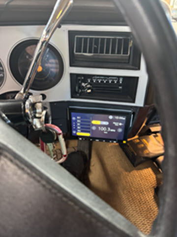

I bought the Sony XAV-9000ES head unit for my 2018 Outback and took it out because Subaru replaced my stock unit for free after lots of back and forth. Since it was sitting around and not returnable I decided try to replace my 15 year old Kenwood. The unit works great in my 1983 Suburban despite Crutchfield saying it would not. The unit wont clip to a 1 DIN housing but you can add heavy duty sticky back Velcro to the back of the screen (its metal) to attach to the dash and it's super snug. I will add Metra 89-30-0500 Universal Din Trim 1/2-Inch Border to finish it but it was delayed from Amazon. It was easy to install in the stock location once the dash is modified to fit a 1 DIN bracket (required for any square body truck). Because the screen is below the top of the unit it won't block the AC controls, and yes- the screen is lower than the ones like Boss that Crutchfield says will, but its easy to see from drivers seat and easy to use. If order one from Crutchfield and you still have the factory harness you'll want to order the Metra-70-1677-1-Receiver-Wiring-Harness, Item # 264MASTER Vehicle specific instruction sheet and may want Metra 87-99-3052 Dash Kit (I did not need this).

I really wanted to put a single din big screen in the 86. Thought it would be cool (dash came pre - hacked from someone in the past with a pet Wolverine and a dull hacksaw…). But truck doesn’t get used much and cost became the determining factor.
