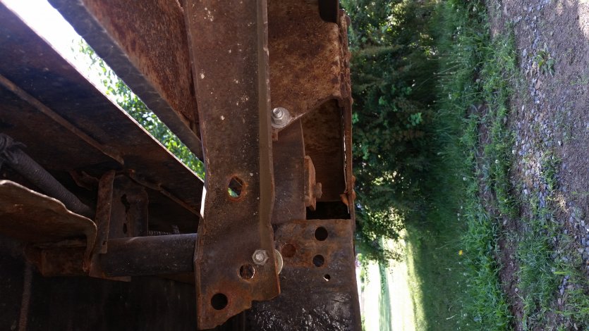

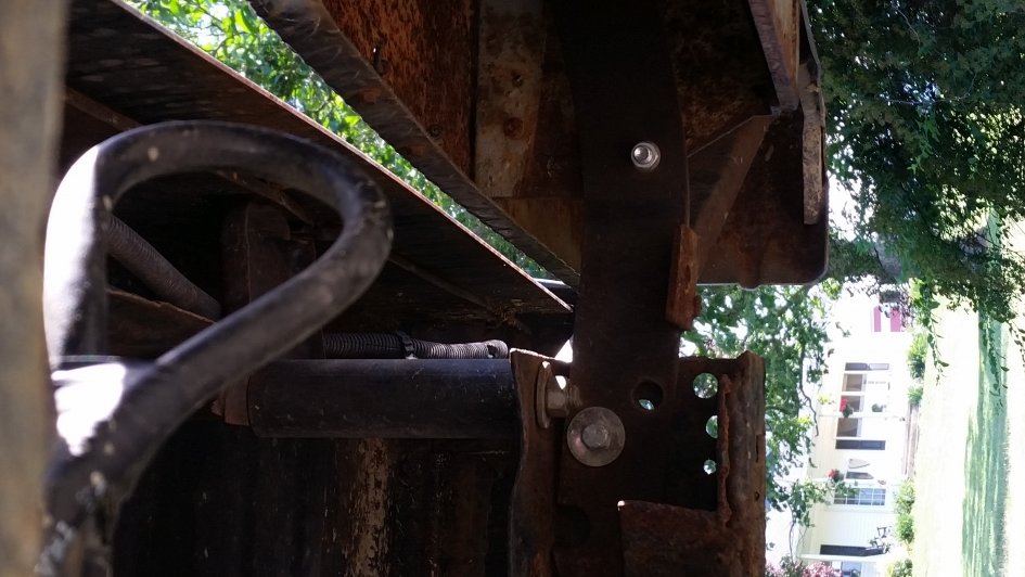

Think I found the problem...... I feel like an idiot for not looking at this closer..... but someone rigged the bumper up a few inches higher to compensate for the gap from the body lift
I knew it I should get a star whohoo !!! :big_banana_Dance:
I figured that was your problem after doing all the math that was the only explanation left.
Now you have to find the factory bumper brackets and ditch the body lift and find a set of stock wheels to use for the inspection then put your 36s back on to have fun with. I would keep the small factory set just for inspection time lol
