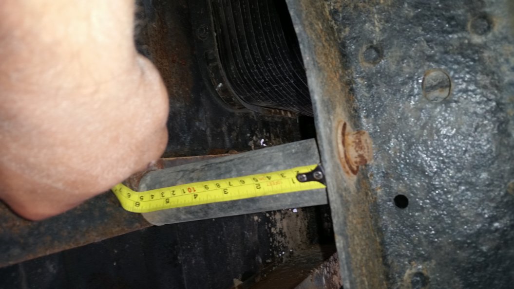

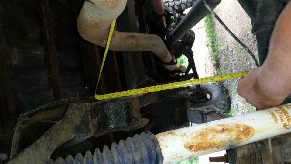

Yes it's a 6 inch body lift. I measured the blocks. The guy put 6 inch pieces of pipes for the blocks. When you mean steering linkage do you mean the drop pitman arm or the actual steering column shaft?

Don5. I'm gonna take the body lift off but my main goal here is trying to figure out just the height of the suspension lift. I'm trying to figure out why my bumper is so high and how to get it lower to make it legal. Unless I can get it inspected then I'll just leave it alone haha if I could get some people to measure some of there bumper and fender heights that would be great. Body lifts don't effect the bumpers at all. So if my fenders are 52" high I MI us the 6" body and end up with 46". But what I need to know is how high is 46" coinciding with my 36" is over stock hight. If other people have trucks about that high that should tell me what I have....

Here is a pic of my 17" measurement

The 6" blocks

Sorry don't know why the pics are sideways lol
