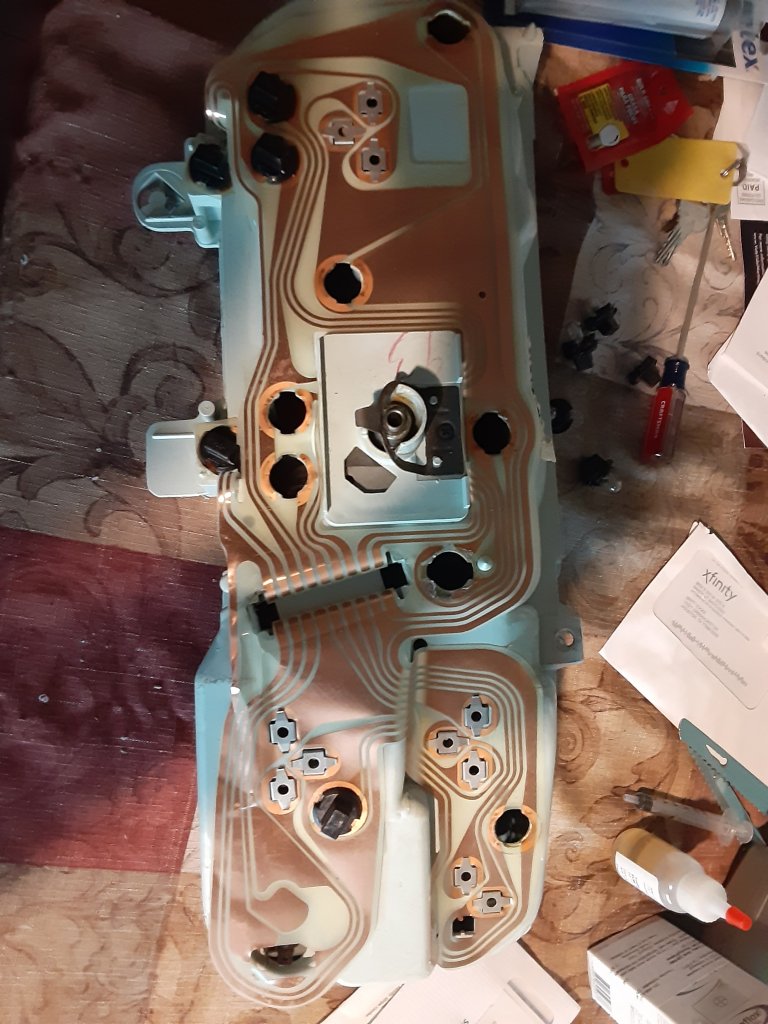

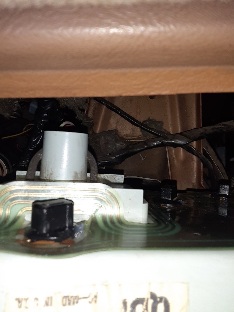

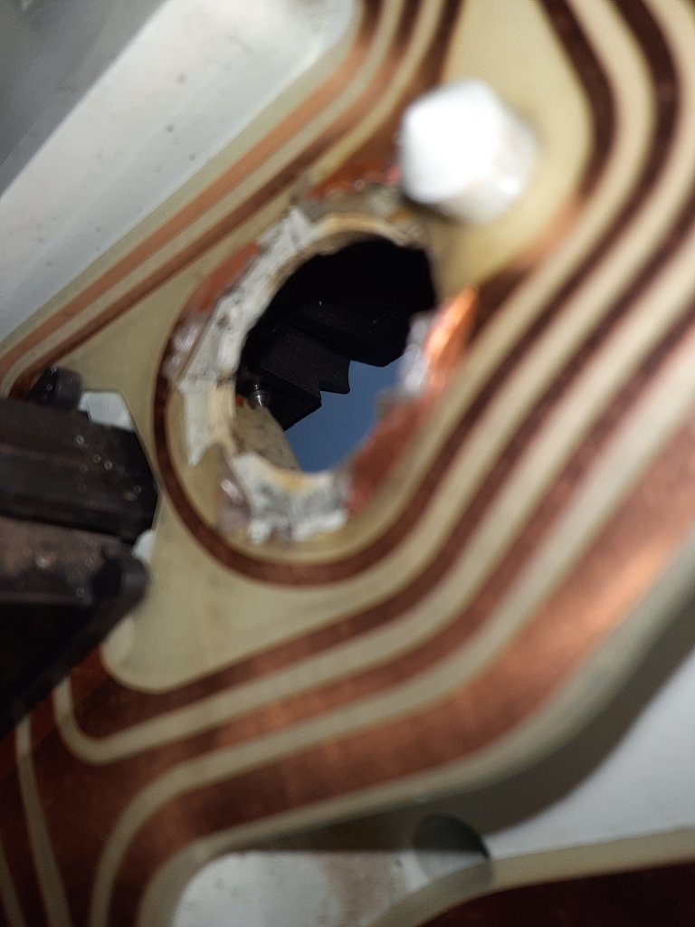

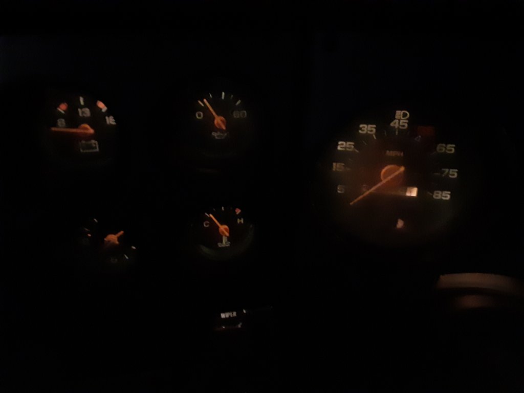

Got the dash back together after a 4 day (couple of hours after work each day) job of cluster circuit board R & R.
Find out tonight if it all still works as she got road tested on bumpy roads.
The LMC circuit board was not to blame - loose bulb holders and 4 years of reaching up to wiggle them or pull and put them back in were.
I just did not want to get back in the dash - real PITA job.
doing that to my gmc ,waiting on LMC for a new printed circuit. How was yours from LMC,also got some new bulb holders as mine seem to be loose in a few holes. Did you glue or silicone your new board down to keep it in place?? thinking I willl do that to mine when I get it
I don't think the LMC one is quite as rugged as the OE, but that is just based on the visual. Functionally it was 100 percent correct. And, flat when brand new so you have to shape it for the electrical connector spot and the turn signals.
I did not silicone the board down - probably help make the job a little easier, but you would also probably have to wait for it to vulcanize.
I would test the lights before you reinstall the cluster and if you need to silicone them to stay put I would try putting the silicone on the holder where it goes in the cluster housing, not on the outside like I did.
New bulb holders did not completely solve the problem for me as I think the housing is worn.
I should have also ordered a new clear lens, but did not want to wait.
Mine has ... patina.
:p
thanks , the area around the turn indicators seem to be a weak spot as well,I was thinking using some silicone to hold it down would help the plastic board get trained to the curves. I have had this cluster in and out 4 times chasing gremlins this winter so I will definitly check all the lights, latest gremlin was High beam indicator lights which is why I went a ahead with a new board
