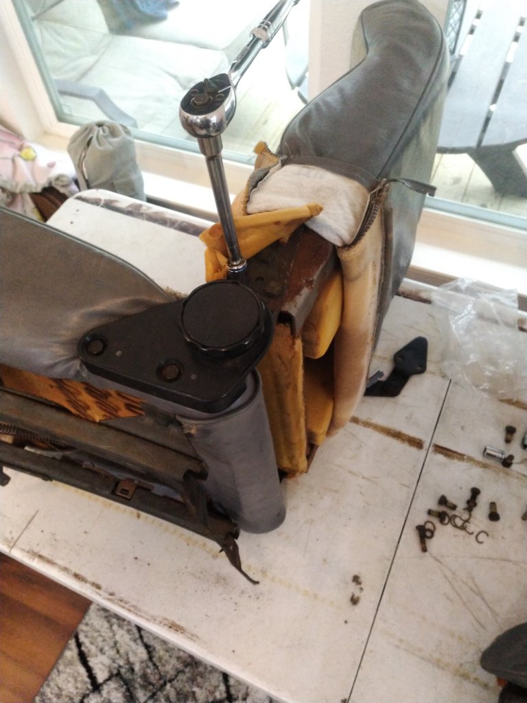

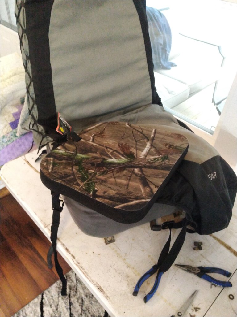

Driver's side bucket seat tilt hinge swap. I guess after 34 years, fancy things like reclining seats tend to wear out lol Was having a real bad gangster seat lean, "laid back" hahaha Thought of welding it in a fixed position but would of regretted it instantly as it is easy to tilt forward or back to install the bracket bolts. While I was in there, I added padding to the armrests and threw in a seat cushion under the seat covers. Works great and is pretty comfy.
Btw...Cabela's bucket seat covers for great on these and the color matches perfect in my silver/grey interior
