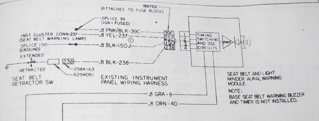

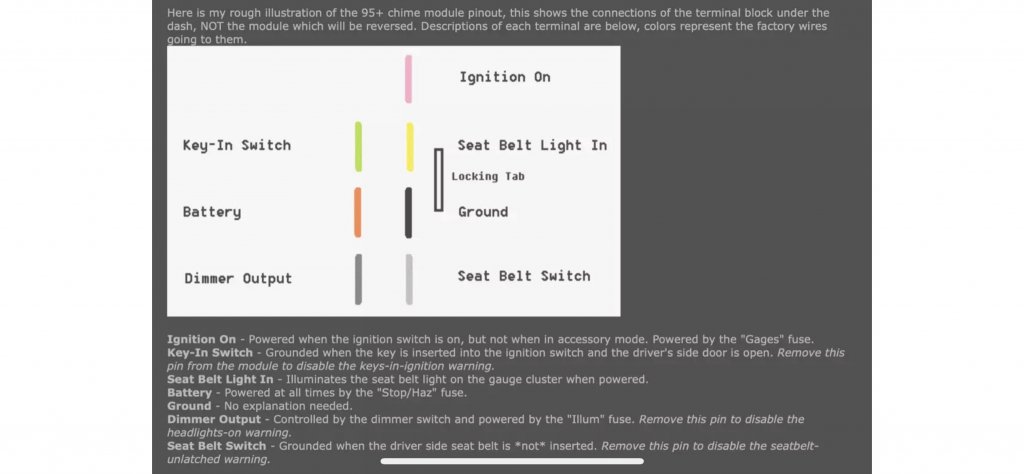

This sounds like a cool mod. How's that work?
Depends on the year of your Square. My buddies 89 was a simple plug in.
My 83 had a black box buzzer (seatbelt reminder). I removed it and used some of those terminals for power, ground, ignition, and added a wire from the lamps terminal in the fuse block. I mounted it near by and ran the loomed wires to it. Took like 15 minutes.
Now my kids get a pleasant “ding, ding, ding” when they leave the lights on.

I’ve saved this in the “**** I want to do to the truck” folder! Thanks for the directions!
My 86 should have a seat belt buzzer? Well I’m glad that that is the only electrical online that doesn’t work! Lol.
It does have a working key in ignition buzzer though!

I believe the ding started with the TBI (87?)
I bought several modules from PicknPull. They’re like $2 each. The F body ones sound the best. Pull the module and the plug for it. To the left of the steering column. 2 screws holding the connector in place I think.
