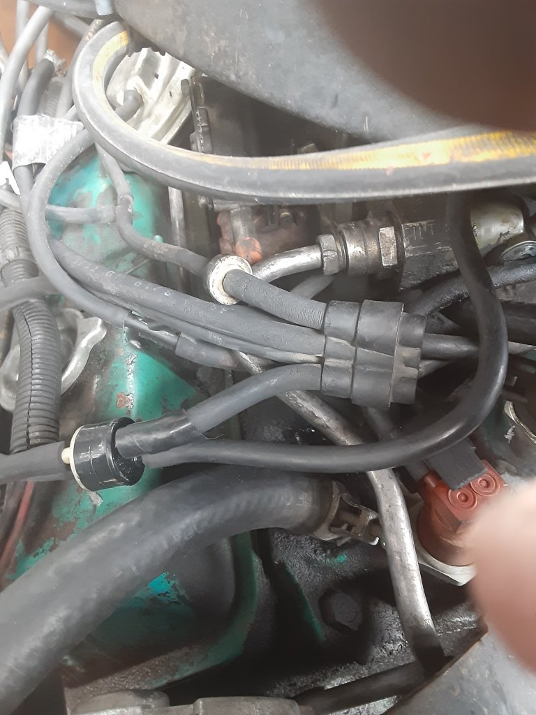

Just because I am stubborn/stupid/insane :eek: I hooked the vacuum line to the EFE back up.
Curious- if anyone on the board still has a EFE and the thermal valve installed and functioning, can you tell me if when fully warmed up there is still slight vacuum on those 2 lines permitting slight functioning of those 2 items ?
Easy to check- and get to - just pull off the vacuum line and put your finger over it. If you feel suction, there is vacuum.
Maybe they aren't really efficient valves and never truly close off.
Or, maybe both my remaining OE valve and the aftermarket 4 port one are bad.
Dont have another one handy to compare nor another vintage square to compare with.
Also checked the radiator after yesterday's fun - full, and so is the coolant reservoir.
No visible leaks, either , so I guess Goldie takes me to work tomorrow.
:driver:
84-C20
Dec 6, 2019
6,903
11,900
Chevrolet
@Goldie Driver when you say thermal valve are you talking about the thermac located on the snorkel for the air cleaner? If so yes I still have mine and it is fully functional. The way those are setup is the thermal part of it is set to maintain an incoming air temperature of around 90F so if it's say 50 or 60F outside it'll only open partially drawing some air out of the front scoop and some air hot air from around the exhaust manifold. If it's hot out the valve will fully open permitting outside air only to flow in. So what your seeing is normal depending on air temps.
Goldie Driver
Mar 19, 2018
4,380
7,573
Houston, Texas
Britt
GMC K1500 Suburban
Cool - seems like I read that somewhere. I got irritated at the TVSs and plugged the EFE hose again. Then I played follow the vaccuum hose vs the schematic and am sure the EFE is correct, but cannot tell on the EGR as there are 4 ports on my TVS 2 on top side by side and 2 on bottom.
The schematic makes it look like both hoses should just go thru the valve. Dont remember now, but it seems like that would be correct if the 2 tops were one line and the 2 bottom ones another.
At any rate, I think one if the Thermac valve hoses was switched, so I changed that. Got home from the grocery store, Goldie all warmed up, and the EFE was still full on (thus the unplug again- should be off by 180 or so and I have a 195 stat) and that Thermac was sucked tight shut.
I plugged it, too - maybe I will undo it.
If I could find good quality aftermarket ones, I would try replacing both of them.
The EFE one us from Rock Auto.
@legopnuematic was kind enough to give me his OE one, but...
The vacuum head broke when I was installing it...
Farking old school emmissions controls...

@Goldie Driver I agree and to my knowledge you have the hook up basically right but a couple of things for you. As far as I know all the thermacs were the same, on the air cleaner one vacuum hose leads to the thermal sensor which has two ports the other vacuum line runs to the thermac on the snorkel. All the thermal sensor has to have is manifold vacuum, any sensors switches ect, before that are best to be left in if functional but you could get by without. Case in point my truck. The former owner removed almost every vacuum line except the PCV and brake booster, so stuff like the temp controlled vacuum switches in the manifold were gone. For my EGR I'm simply running ported vacuum to it. If you wanted you could do that as well, the only down fall to that is it will open at cruise even with a cold engine. I have not had any runablity issues because of it, but I think the main reason was so the EGR wouldn't open when the heat riser is closed which could possibly cause to much EGR flow. My thermal sensor on the air cleaner is hooked directly to manifold vacuum.
