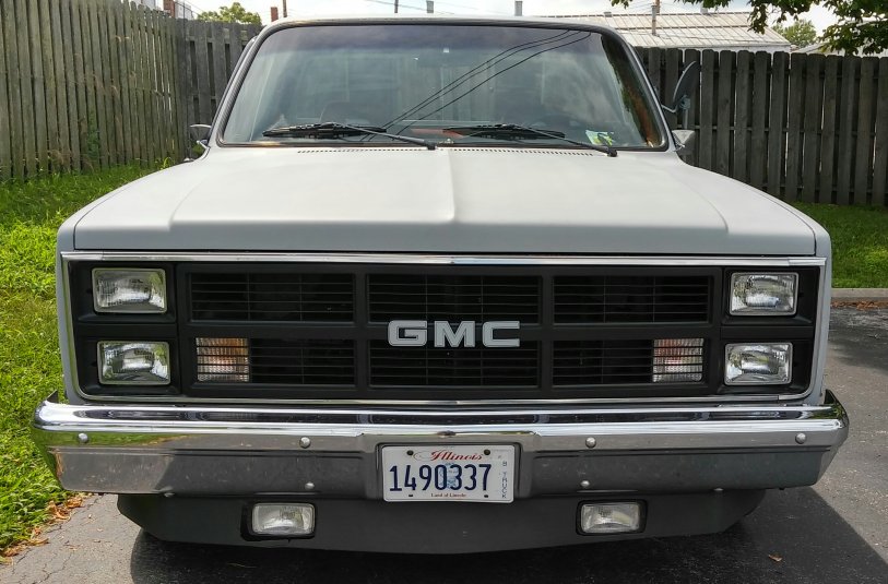

quick gmc emblem mod....lol
Got bored today and finally got the emblems primed since the rest of the truck is grey.

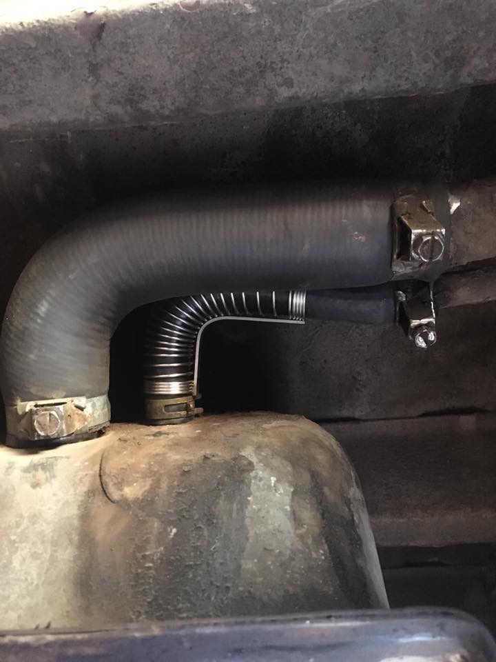

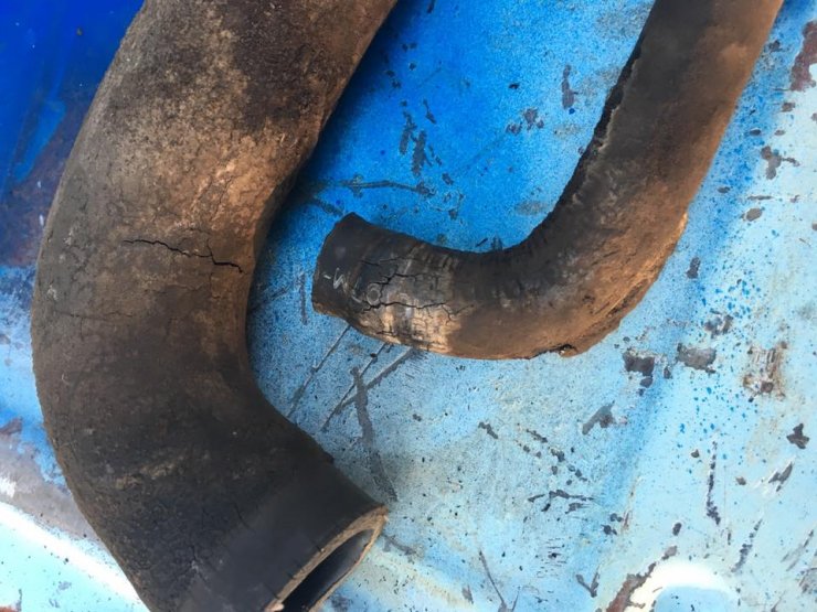

Replaced the fuel fill and vent hoses because I'm tired of gas hitting my shoes. Here's a before and after. I went back to the same pump I used previously and no leaks. And when I reinstalled them I put the clamps facing at an angle where I can easily get a wrench on them. The last person (maybe factory) put them all up on top which made it very hard to get to.

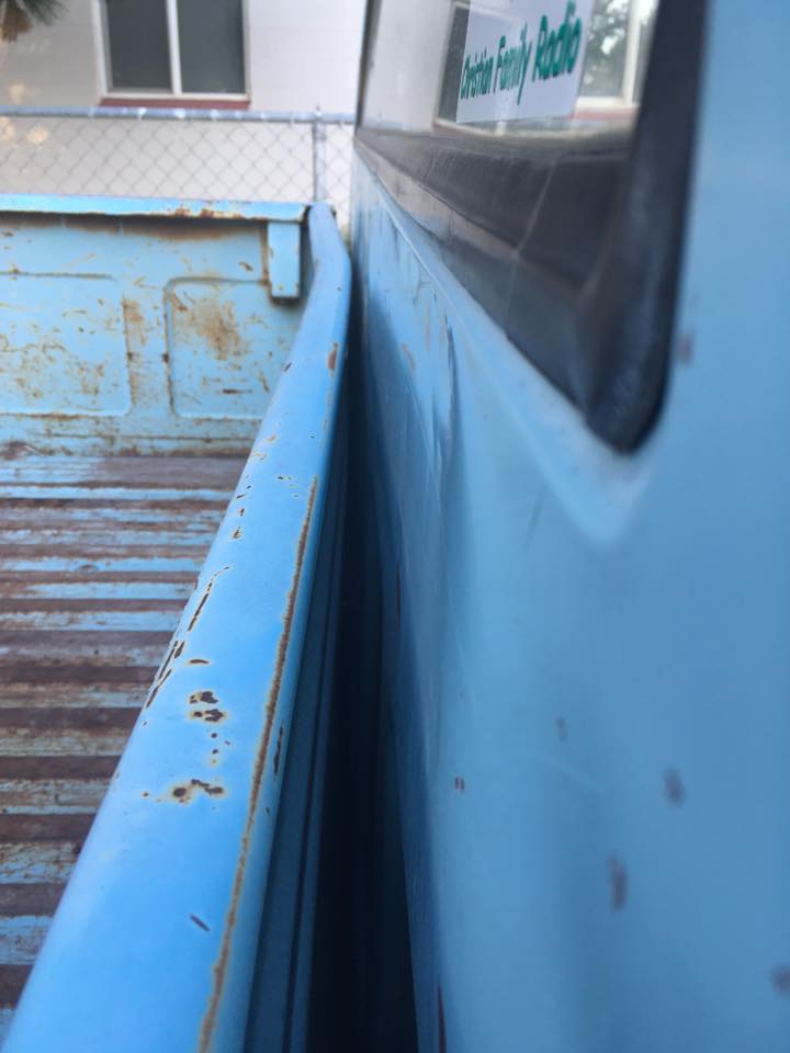

Installed the outside window felt on both doors. Pulled all the screws out that hold the front bed panel. It's bent so I want to pull it and straighten it in our sheet metal shop at work.
