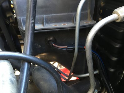

I spent some time today running my 3-speed conversion fan harness on my 86 K10. I mounted a Motorcraft RF24 4200 CFM fan inside the stock truck shroud as part of my stealthy fan install. I'm using a dual temp (180/195) BMW fan switch mounted in the intake to trigger the relay bank and fan speeds are adjusted via multiple resistors mounted inside the stock 88-91 fresh air duct found on 81-87 BB trucks.
This pic shows a grommet installed on the side for the fan wires to route through....

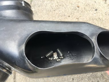

Coil set riveted to air duct....

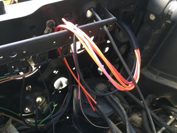

Relay bank found on a variety of GM FWD 90's cars. This is where the fan control relays will mount-just behind the LH side of the core support.

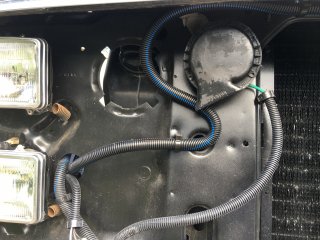

Harness routing...

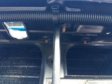

Harness mounted under the core support-normally no OEM looms route this way but a sneaky way to route an auxiliary harness....

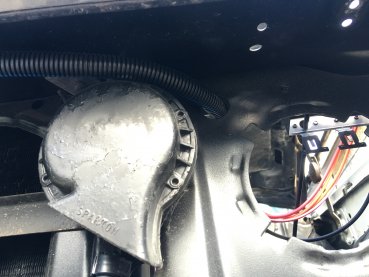

Core support has plenty of factory holes to run the loom through...
