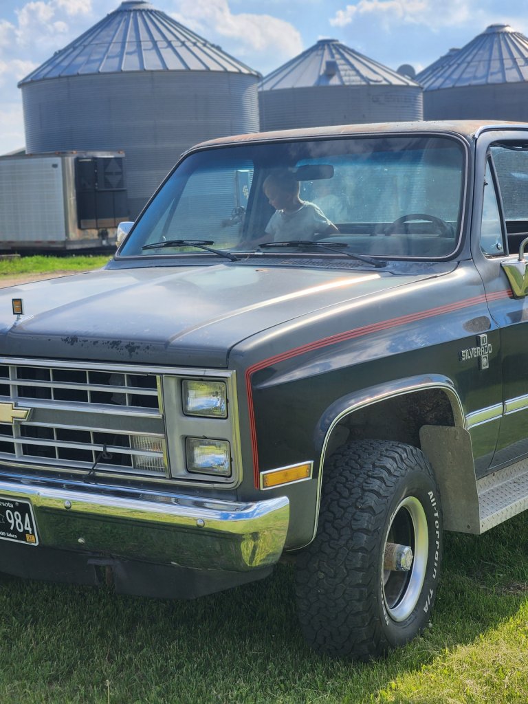

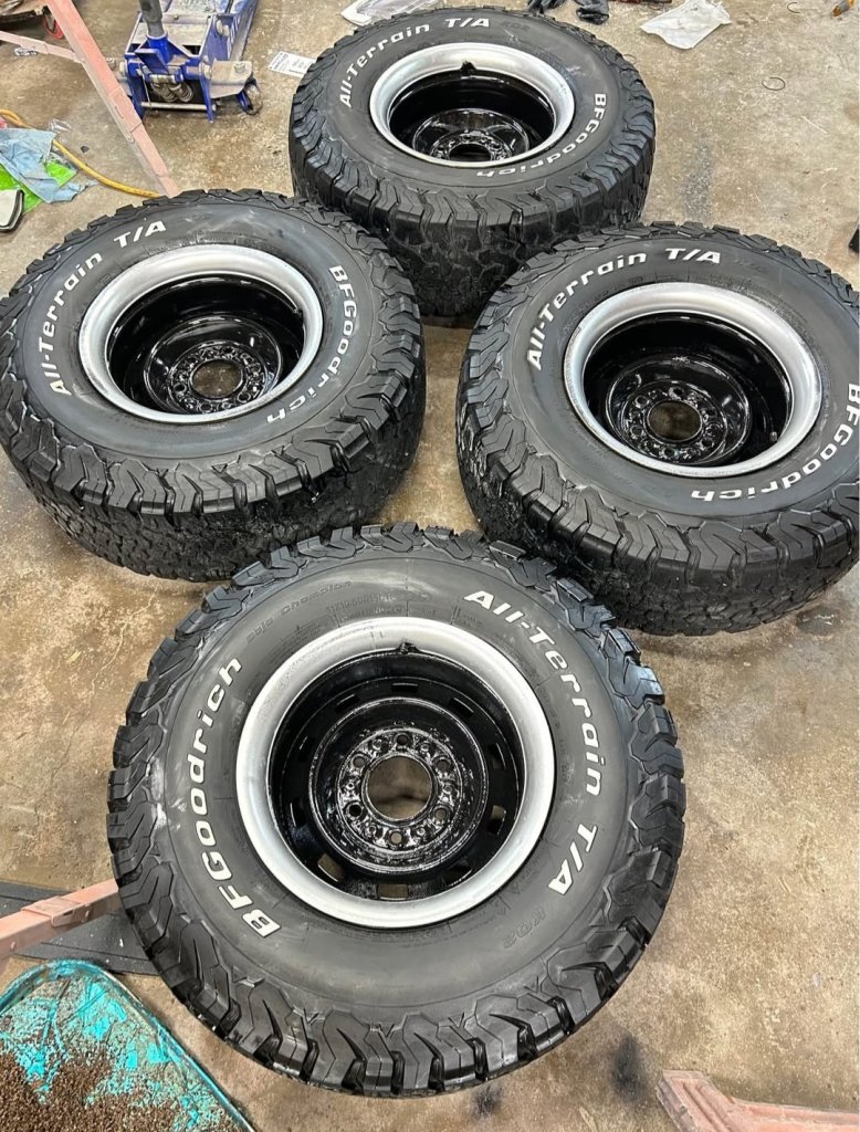

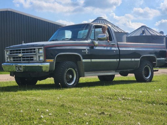

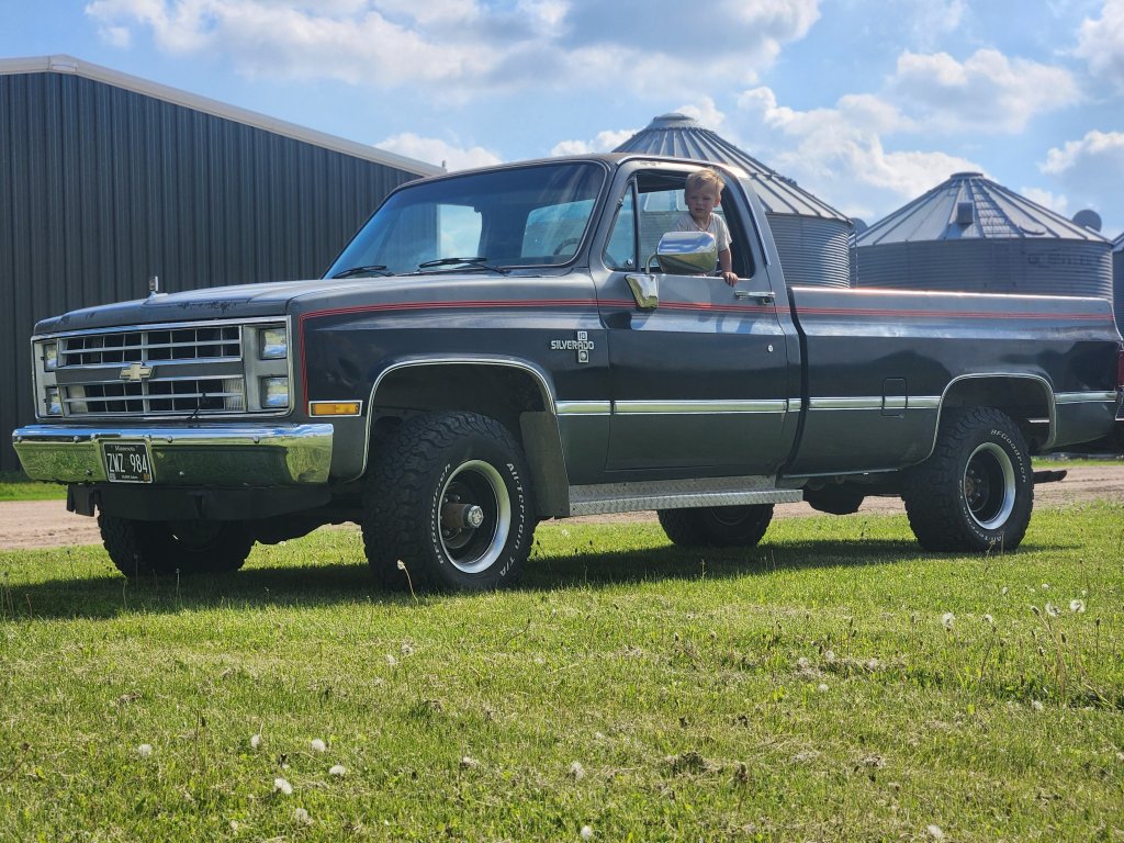

Finally found a set of 31x10.5x15's and even came with a decent set of rims, we'll see how the paint holds up but they were $600 and the tires are pretty much new. Got them installed today along with the new tail light lenses

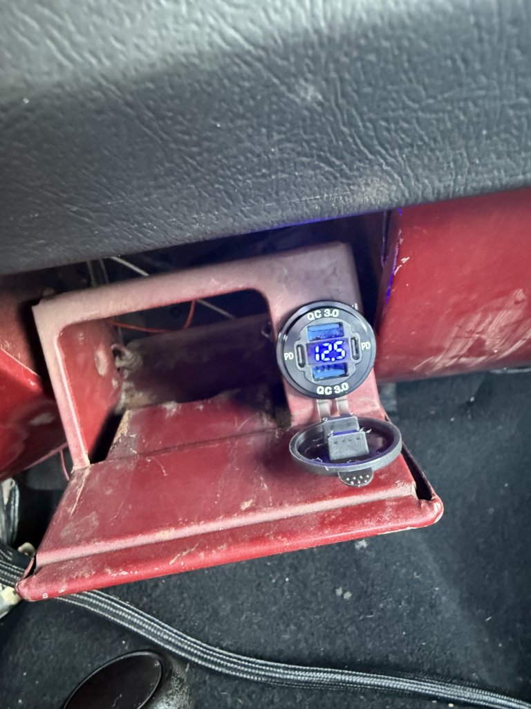

Cigarette lighter wasn’t working. Ordered a usb charger to replace it. Had to cut the hole a bit for the larger body, but I can charge a cell phone in the square now.

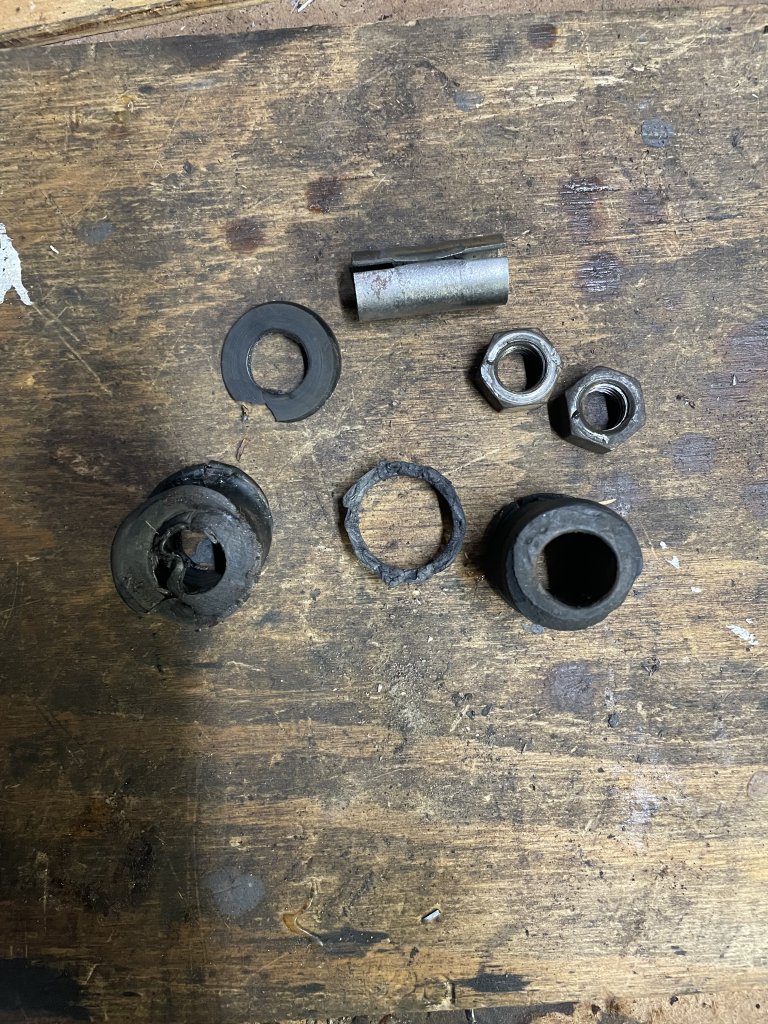

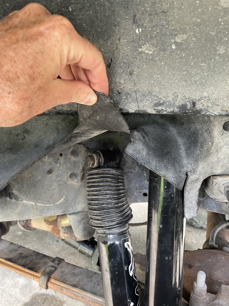

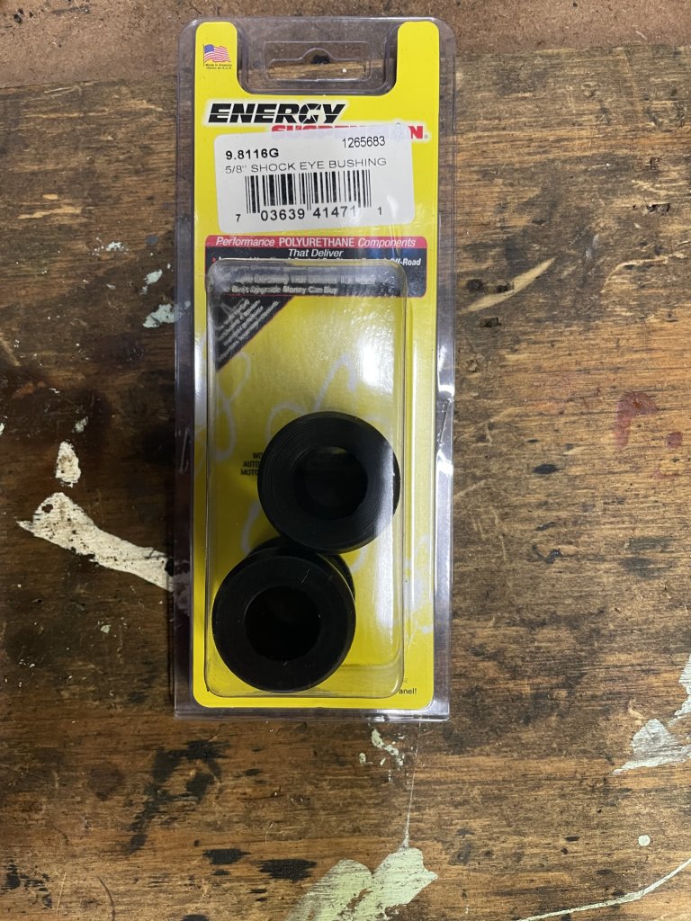

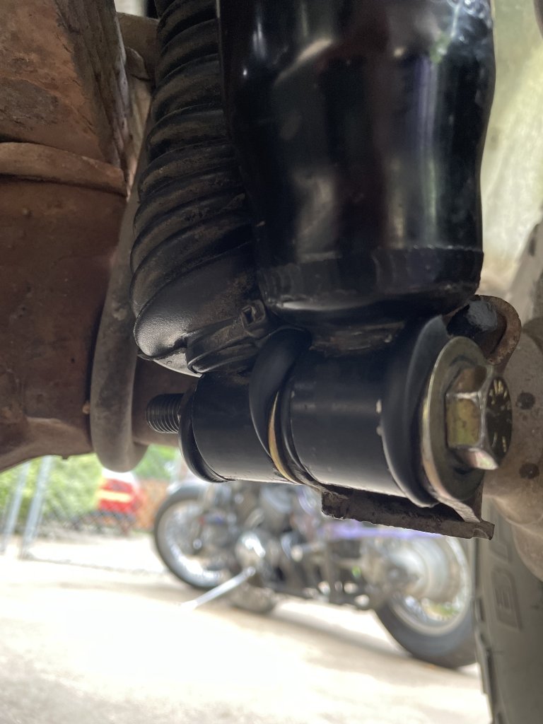

I found the bushings were wasted on the pass side shocks. The worst ones were on the top of the shock. I noticed them when I was replacing the starter last week. I’m disappointed with the quality of the bushings. I had to replace one on the drivers side a few months ago. These are the Skyjacker Black Max shocks. One shock didn’t even have a bushing left. You can see the worn sleeve in the pic. One of the shocks was about dead. I put it back on any way. The shocks are only about 2 years old.
I’m not sure if it’s the quad option causing the problem or the stiff azz springs. I went back with polyurethane bushings. I also went with one boot up and one down this time. They were both down last time. Diver’s side is still like that. The shocks won’t fit with both boots up.
