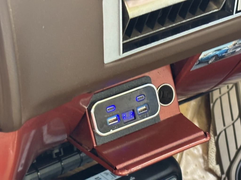

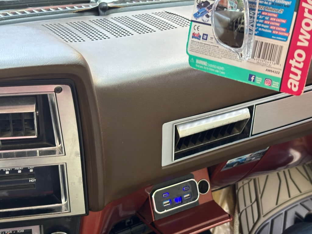

I've been working on a USB panel for the ashtray. I bought a blank 3d printed insert from Etsy. And mounted a 12v multiple USB with voltmeter from Ebay. But they have it on Amazon too.
I used the phillips screw that mounts the ash tray assembly for a ground. I ran a power wire to the fuse box and into the ACC for a switched power source.
USB panel mount on Amazon about $15
Squarebody ash tray panel on Etsy
hmm....be nice to put some digital displays in there for other sensors to display. I've got a small analog tach in there now. Sorry, thinking outside of the box.
