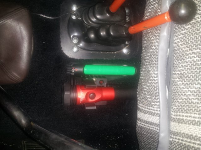

Mounted a flash light on the tunnel next to the shifters ..streem light..

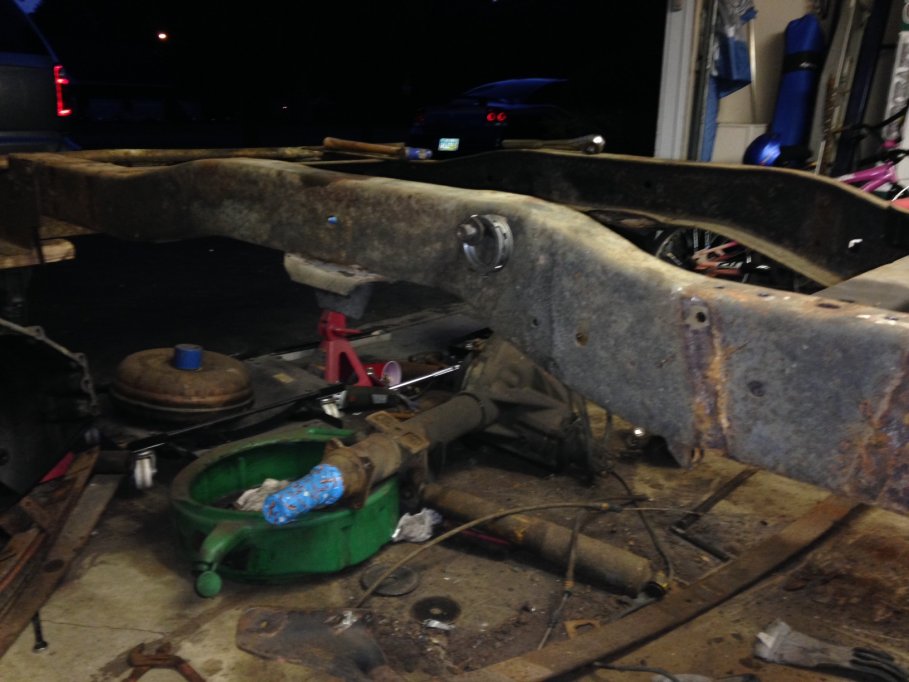

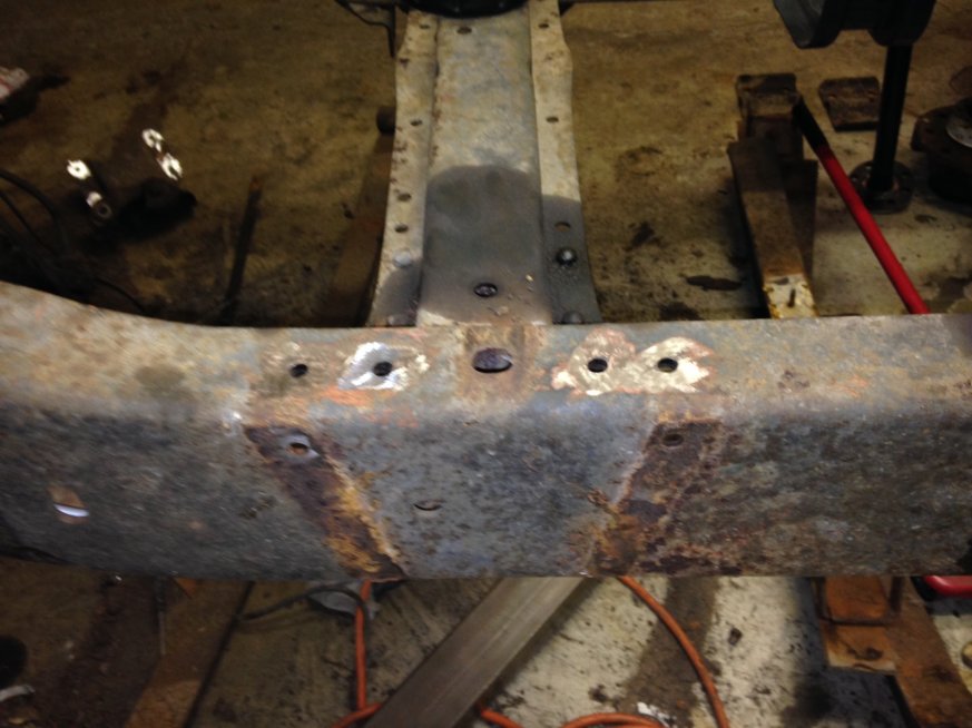

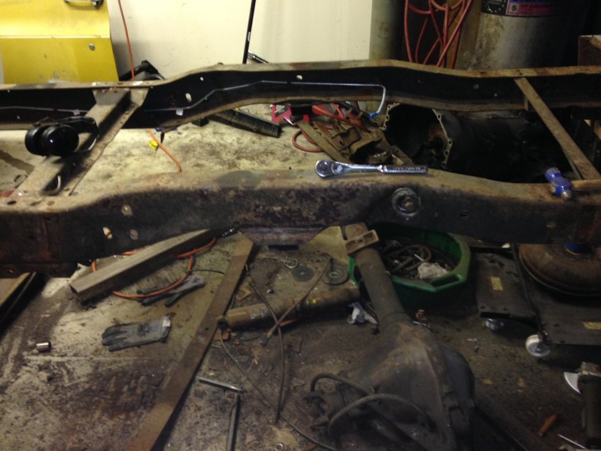

Getting rear suspension torn apart....I've been busy grinding rivets to remove leaf spring brackets too. Brackets, springs and 14 FF getting media blasted then powder coated prior to rear disc brake conversion and new bearings, seals & etc,.

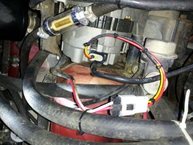

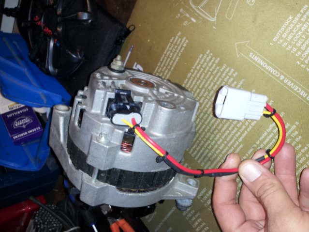

I put a cs130 alt on today got the conversion plug from orilys $20 then switched pullys to the vbelt bolted right on. The rear stud is lower on the cs130 kinda snug to the head but clears. Pushing 120amps now not 70 lights are brighter feels like it runs better. Less drop from the fans turning on. Working great so far.....
Did you have to change the pulley on it? I'm thinking I want to do this mod. Tired of my dim lights and slow windows & slow wipers.

Ya pulled the serp pully off and put the vbelt one on it with no problems. The only thing that didnt line up was the tube the bottom bolt goes through has a bracket that bolts to the back of the alt. But other then that was fast and easy

Did you just tweak the tube a little, left it off, changed out bolt?, What year/make/model came with a cs130? Gonna go get one tomorrow, want to know what to ask for.

I left it on just dont have it bolted to the back. Mines off a 92 burb 2500 454 with serp ..you can get a 100 105 120 amp maybe 140. My trucks a 454 wuth v belts 12 si 70 amp I might look at rotating the housing to get bracket lined up if it can . Not sure on 350 the bolt holes need to be 12-6 oclock on alt
