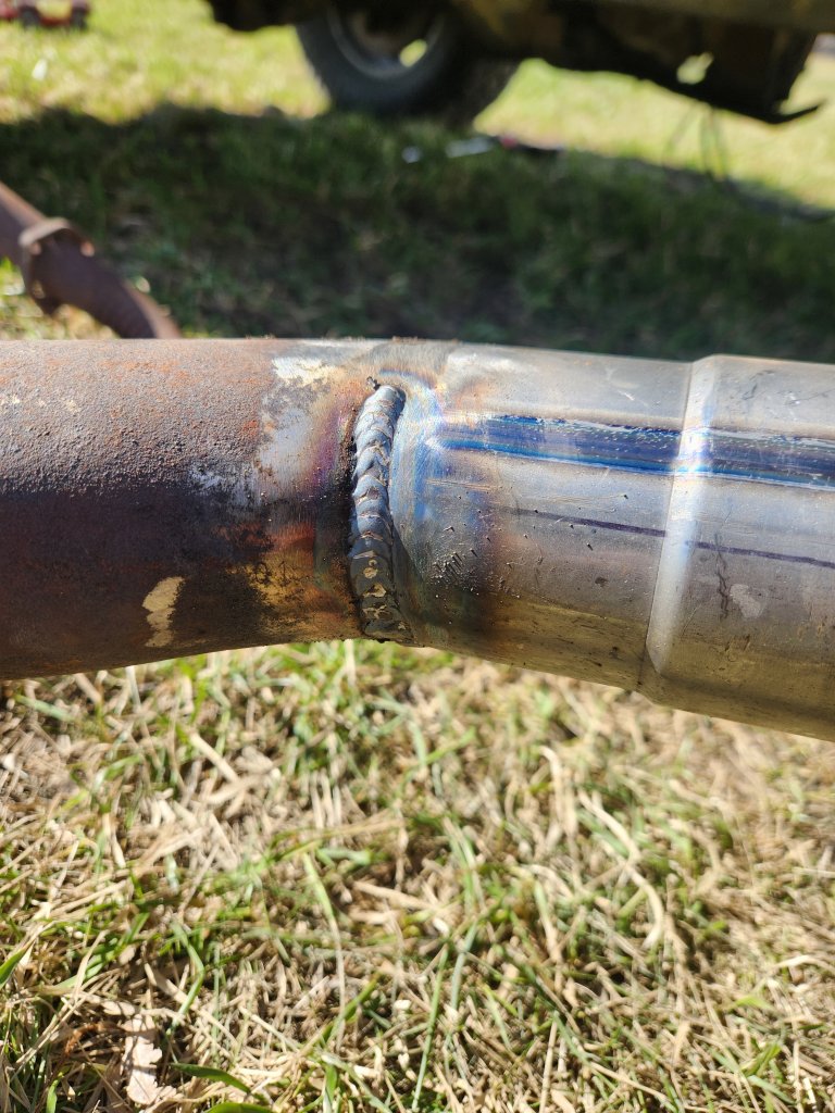

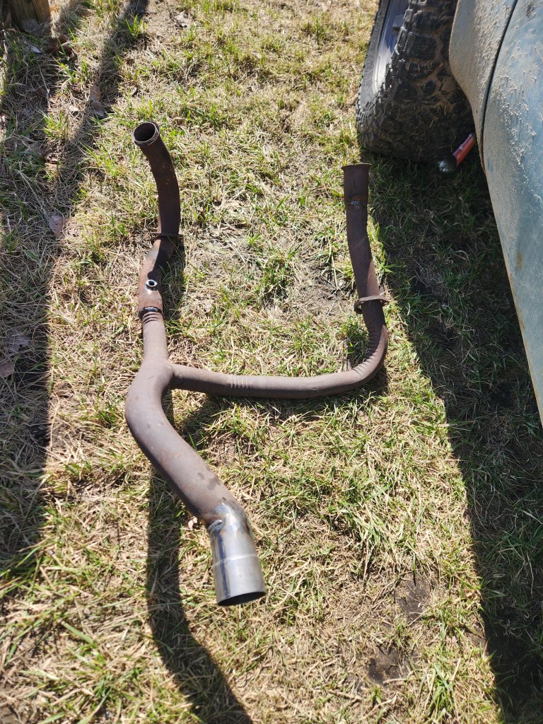

Started redoing exhaust in the suburban

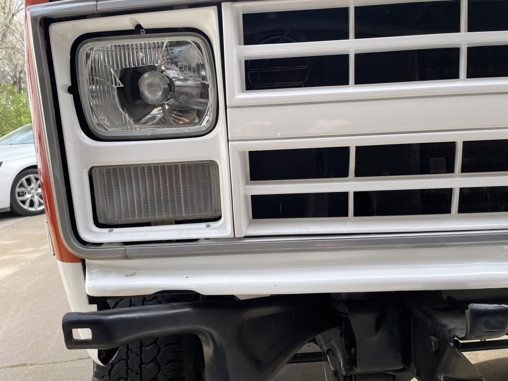

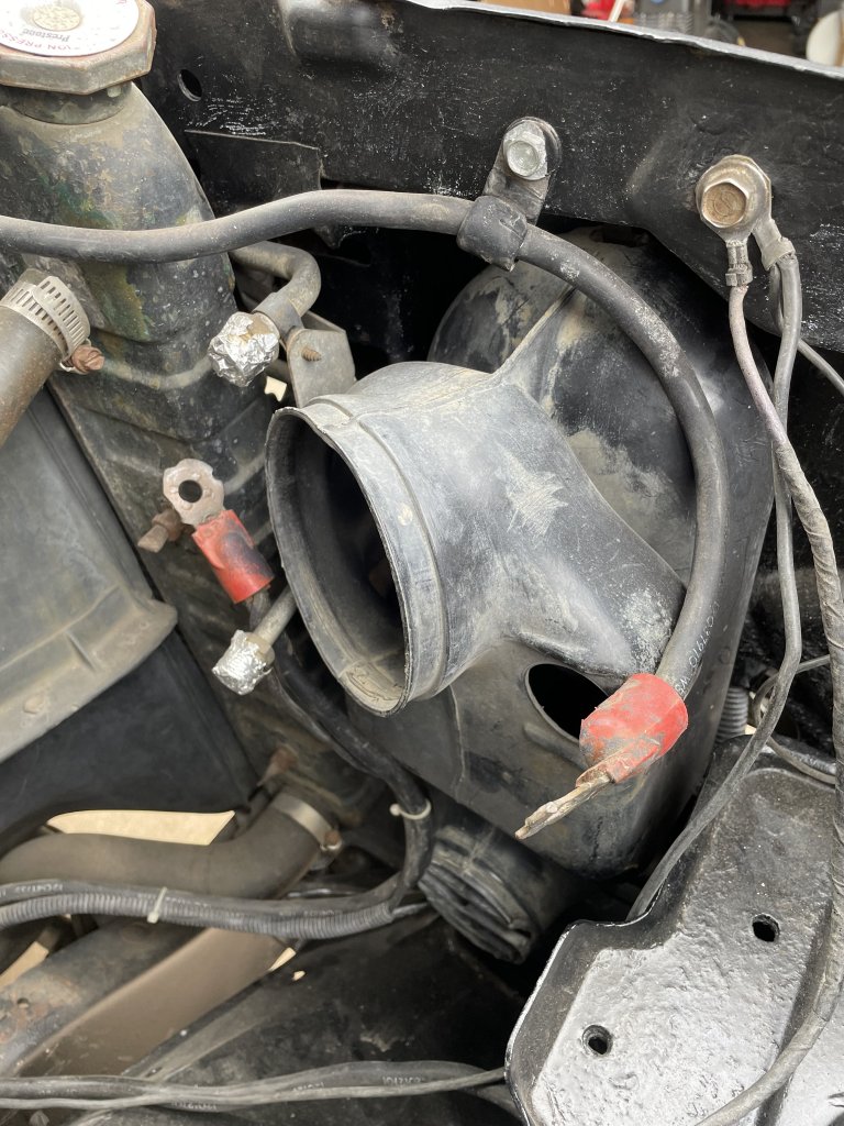

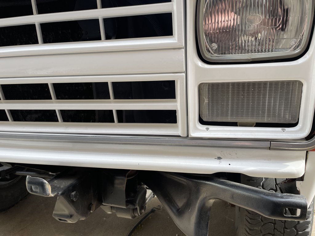

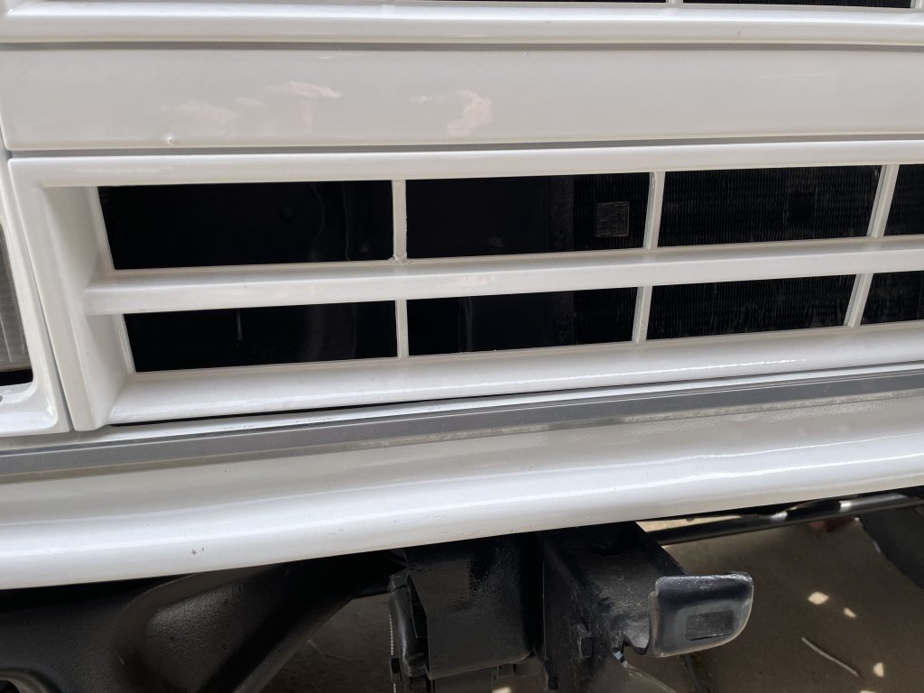

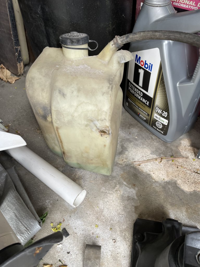

Test fitted front grill and chrome today. I haven’t tightened everything but the bottom valence and grill has a lot of gap variation from the center to either side. Is this old truck normal look and space tolerances? Also, was considering using the cold air intake but it interferes with the radiator overflow tank, any options available for this issue?

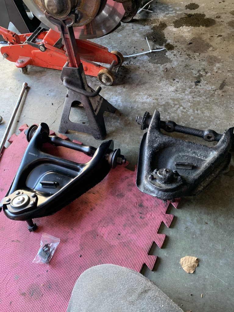

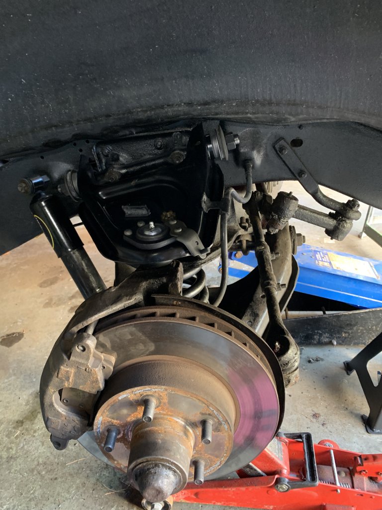

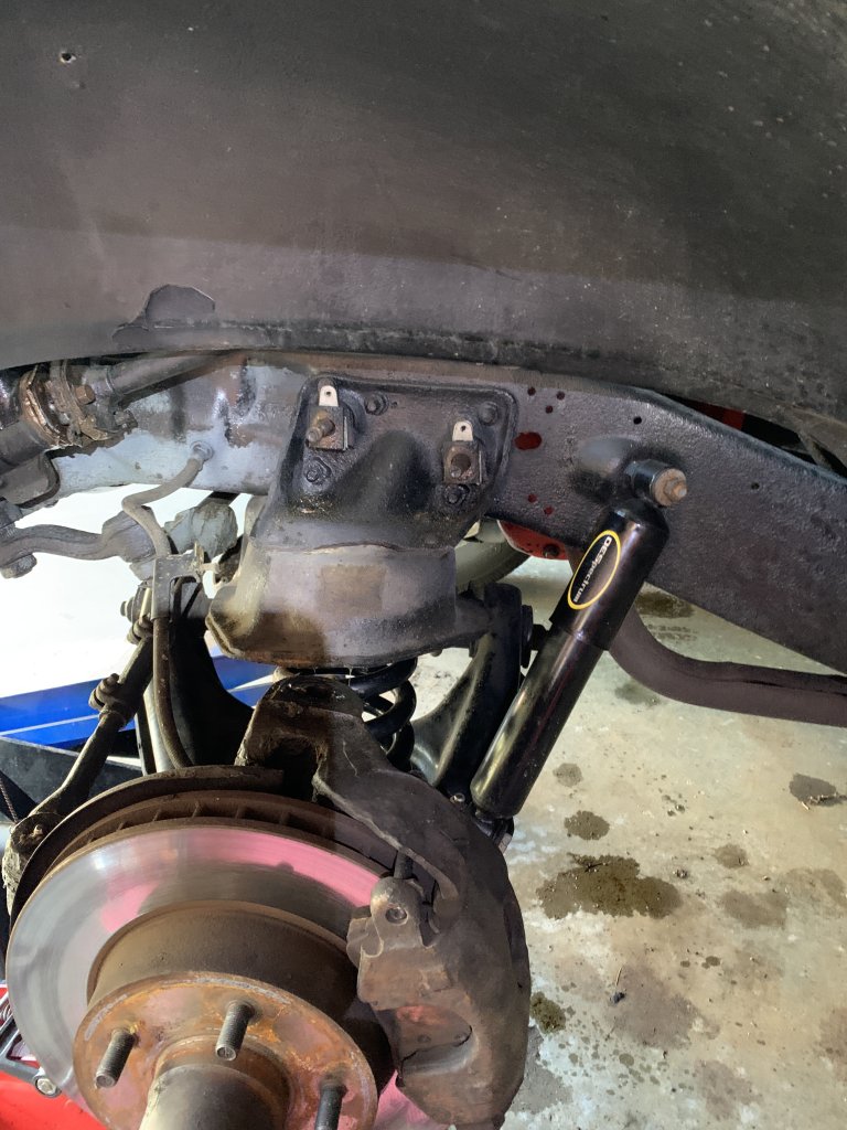

While I was replacing my front springs a while ago I noticed how bad my upper control arm and bushings were, so I decided I would replace them. Lowers are in good shape, so no need to touch them at this point.
I went with the Moog control arms. With the exception of the passenger side mounting bolts/nuts being very corroded and difficult to remove, the reset of the install went pretty smooth. Just kept the same shims in place for now, hope to get in and aligned this week.
