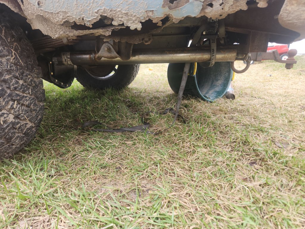

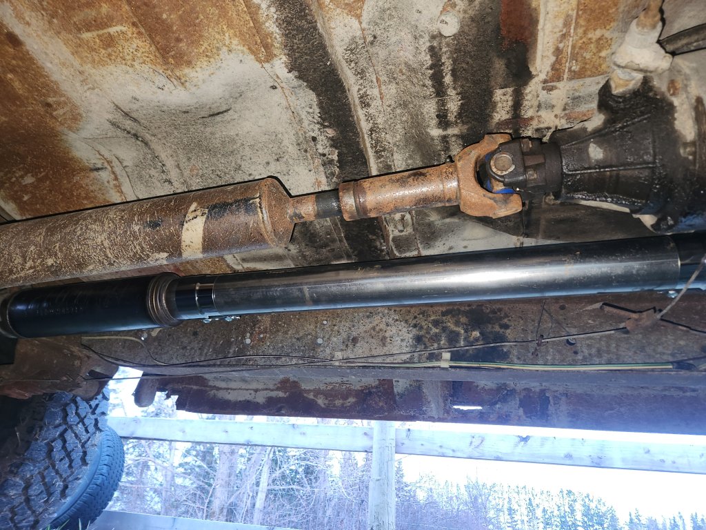

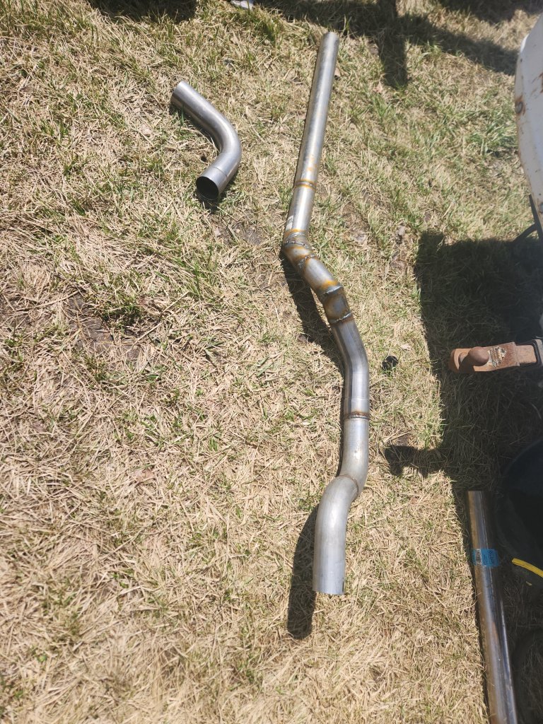

Finished my exhaust. Debating weather I want a turn down at the rear to get it under the reciever hitch or aim the turn down out and down and cut the pipe after the shackle

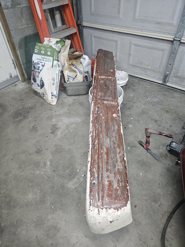

Didn't expect this. Old painted bumper removing paint with citristrip with saran wrap over it. I've only ever tried 24 hrs then repeat.
Put it on and wrapped sunday. Had the grandkids for a few days so didn't touch it until today. Absolute butter removal.
I got time at that rate. AC remover is better from what I've read, but they say the metal retains the smell for days. Wife would b|tch about it tho lol.
@bucket going clean and smooth on the front and let the rear bumper be the wear and tear look lol. Thx again.
