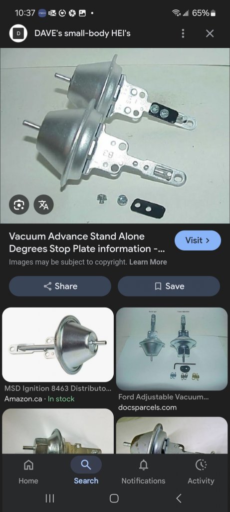

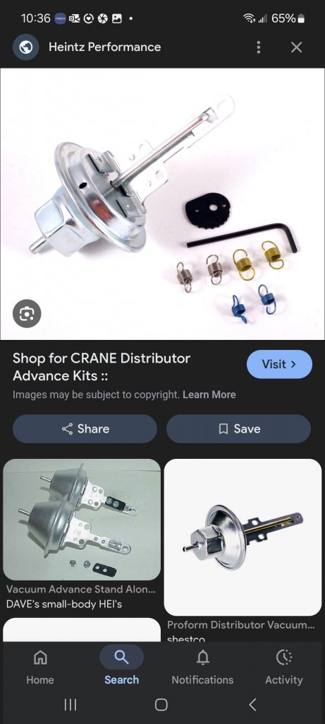

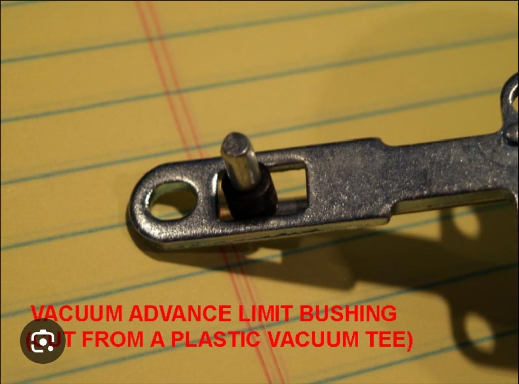

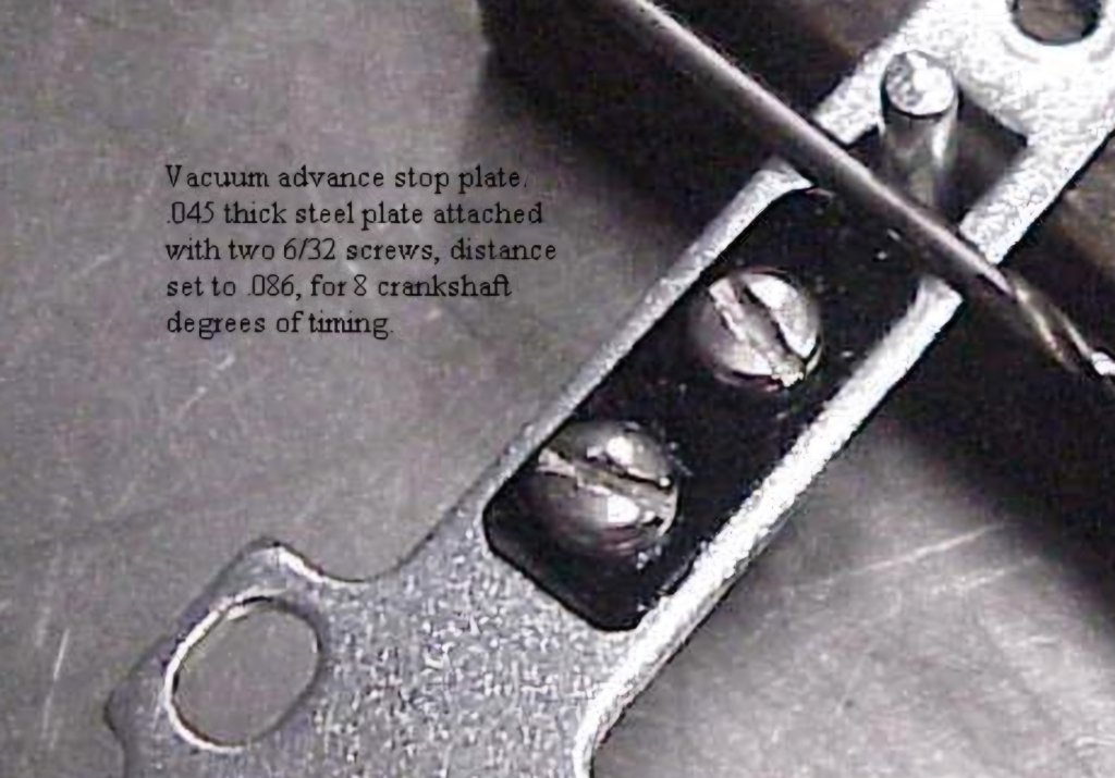

Most adjustable cans limit advance by upping the spring tension inside the can so the engine vacuum can't overcome it. Okay so it did limit overall but also made the can not come in as soon as it should. Investigate. My opinion making stops for the can is a better option. Loosen the spring back up so the can can work then make a simple stop to limit how much the arm can actually move. Lots of people don't realize GM used bushings on the vacuum advance rod to limit advance most are long gone,crumbled away or not moved from the old can to the new can when people changed a worn out advance can.Look at the pics, the good kits come with a stop plate so you don't have to make the can unresponsive. The other pic shows a simple homemade stop plate.
Interesting... I've never seen stop plates on a Vacuum Advance before. I'll have to look into it at some point. The adjustable is doing what it needs for the moment. I had it disconnected for the longest time and just upped the mechanical advance when I had first built the engine at the advice of the machine shop, but later learned that his assumptions weren't on track with reality.

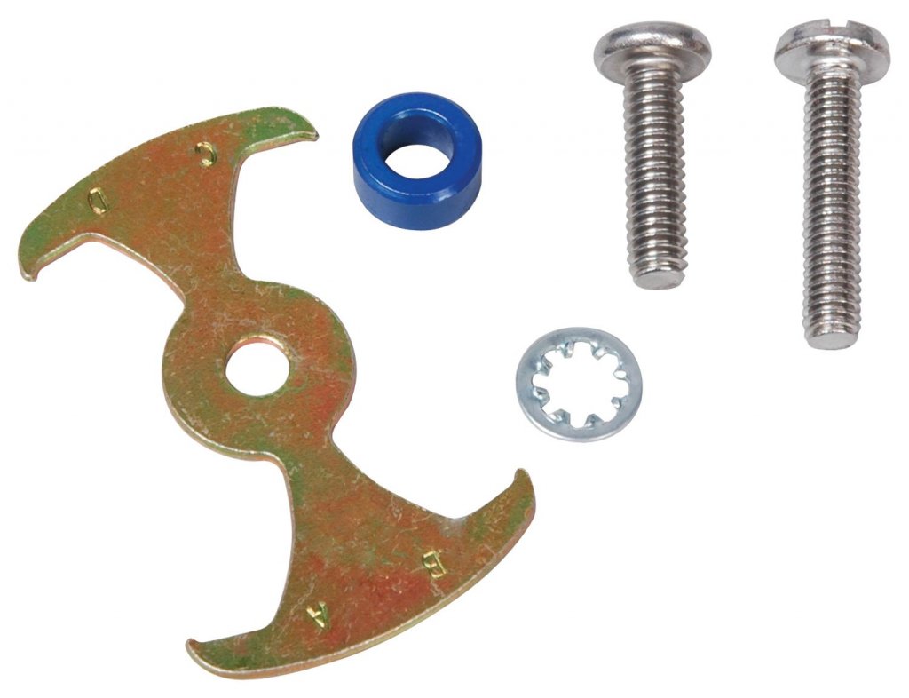

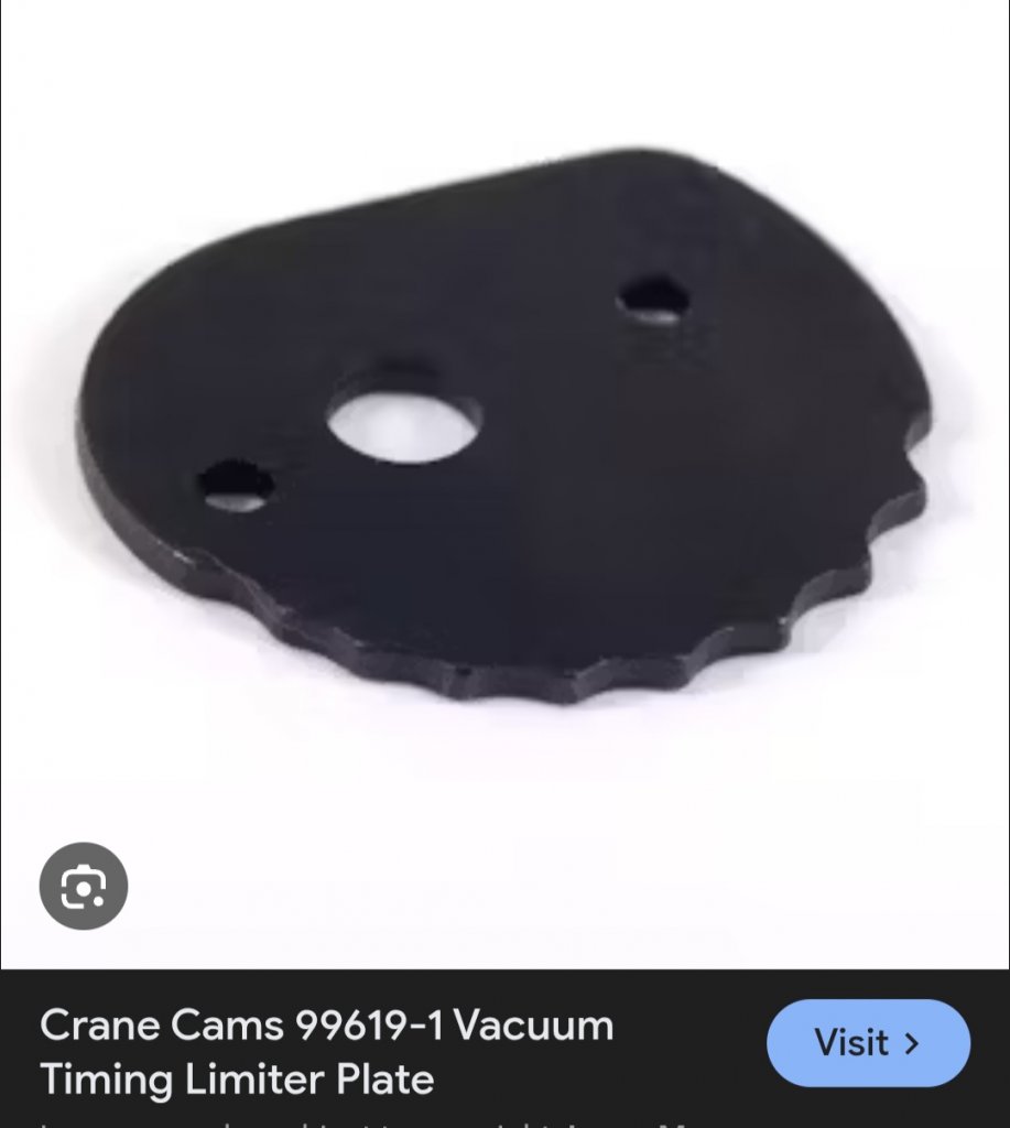

Relying on an adjustable can instead of a stop plate creates the same problem as your too tight springs on the centrifugal side,yes your vacuum advance works but not at optimal times because you have the spring tension up to restrict it. MSD makes stops ( not good ones IMHO.)Crane makes stops ( good but need mods) best bet is make your own . Go online "home made HEI Vacuum advance stop plates" Lots of info,how much movement equals how much advance. Easy home made designs.

I use the MSD one. Wasn't worth making one to me for what it cost. . No cutting, drilling, tapping, filing or welding. Phillips screwdriver to put it on and its adjustable.
