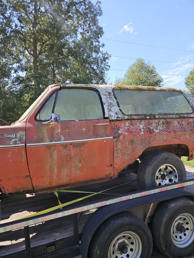

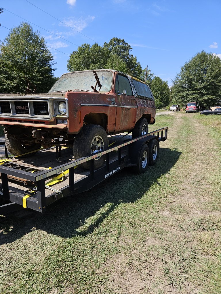

Got a 73 K5 for the Mistress... it is rough...rough. my thought is to cut the windshield frame off, and weld it to the Mistress. Some of you know I've wanted to make it a roadster for awhile. I just wanted the header to look correct. If anyone needs and thing from it, let me know. It has good fender emblems, good grill.
