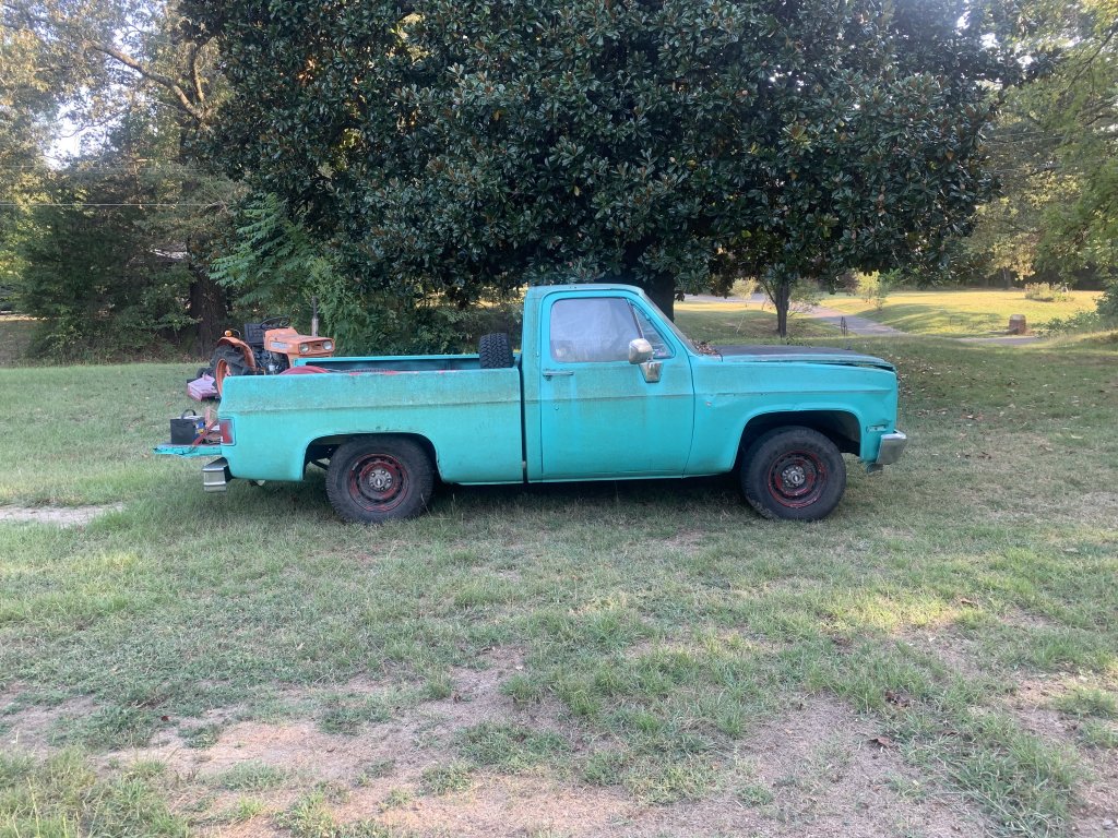

Drug it out of the orchard. Still needs to be closer to the house before I pull and cut the front coils.

Getting ready to do the front?
Yes, as soon as my K3500 dually is back on the road. It’s dead, where I need to park Ralph. Going to trim 2 full loops per coil and run shorter front tires. Will get 2” spindles if absolutely necessary.

How tall of a tire? I had 2" springs 2.5" spindles and a 26" front tire and ended up putting stock springs back in because the cross member and a arms were so low I could not roll a low pro jack under the front if I had a flat.
205/70 or more likely 215/60. Stock was P205/75 all around, have P235/75 rears with room for 30-9.5 or 31-10.5. Truck is on 15x6 van wheels, that are stock per the spid label. Will fine tune the rear height via tire selection. P235/75 up front with same model 31-10.5 out back would be ideal.
You're gonna wanna do spindles instead of cutting that much off the spring. You'll never get it aligned, 1 coil cut of = 2" of drop fyi. I've got ~1.5 coils cut on my truck and can't quite get the camber in spec. It's not too bad but instead of getting 40-50k miles out of the front tires, I'm getting 25-30k
