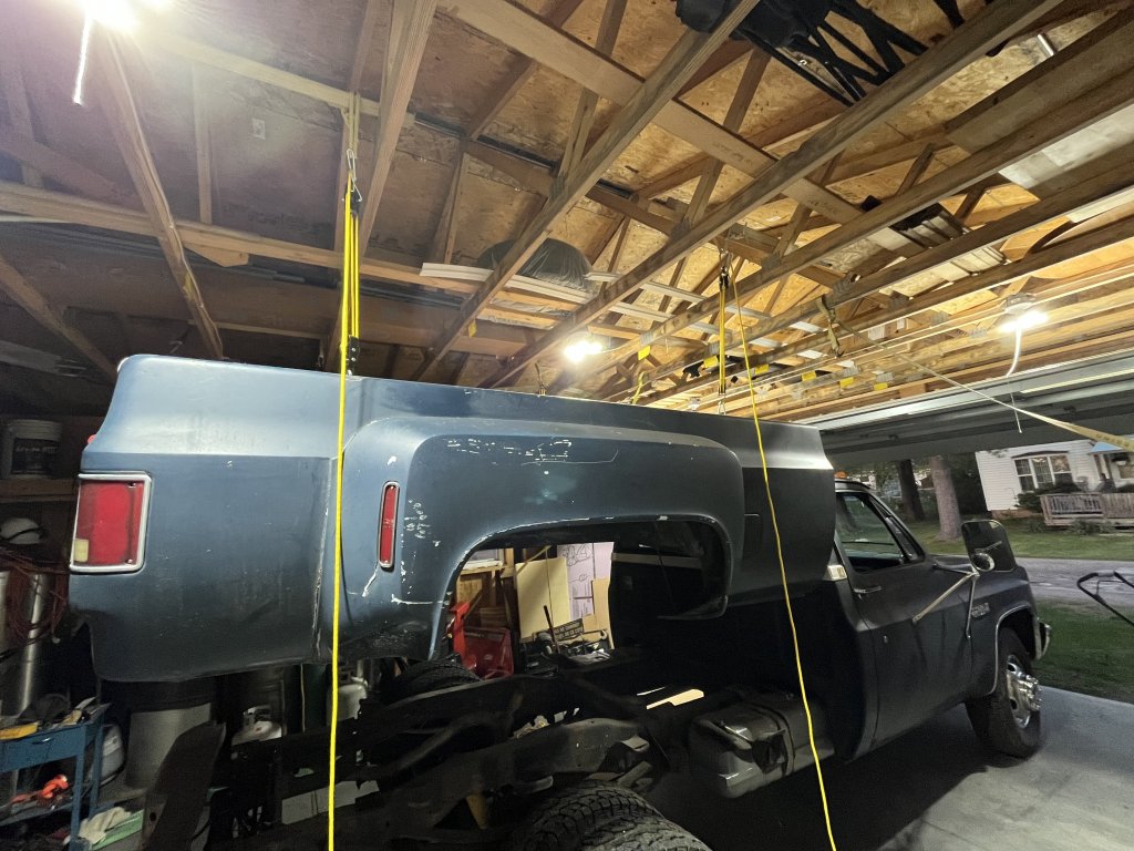

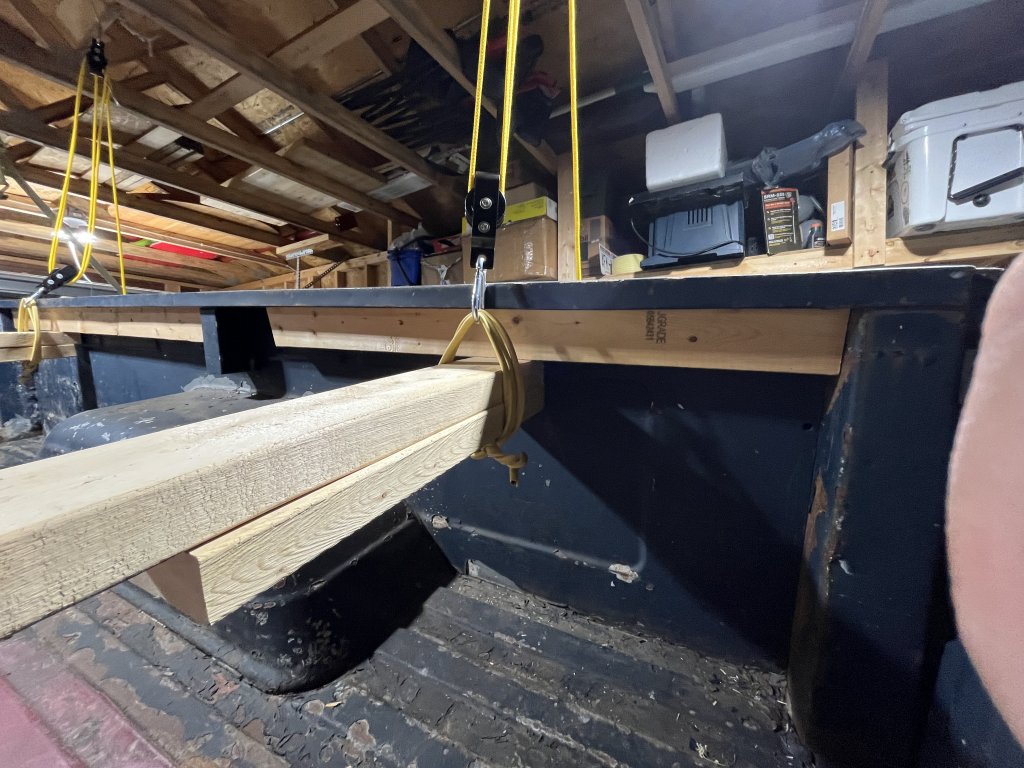

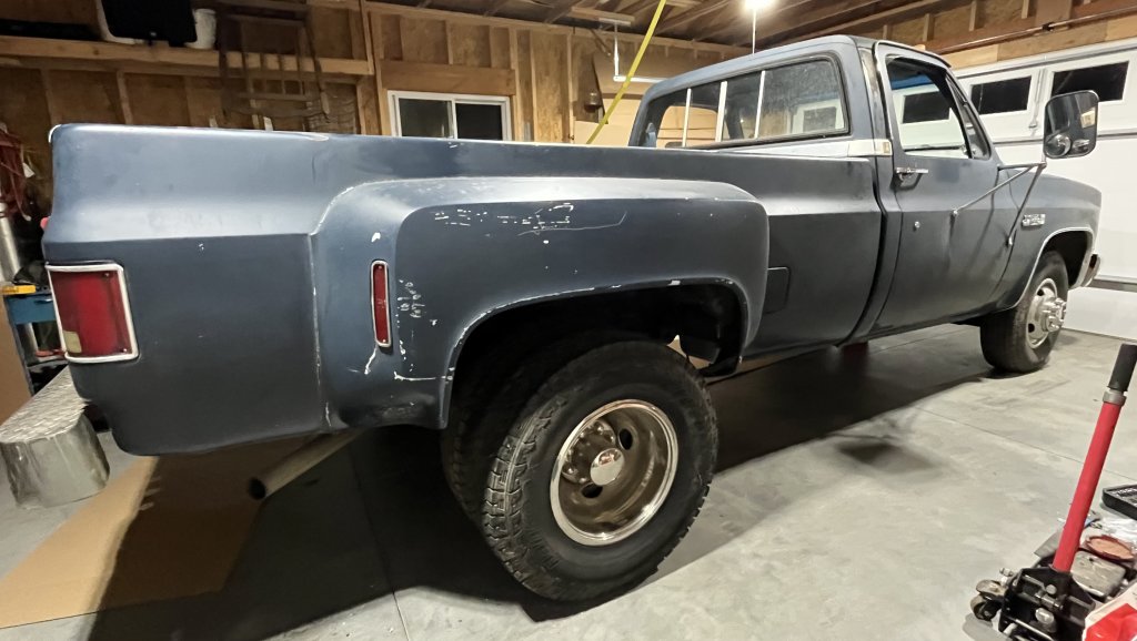

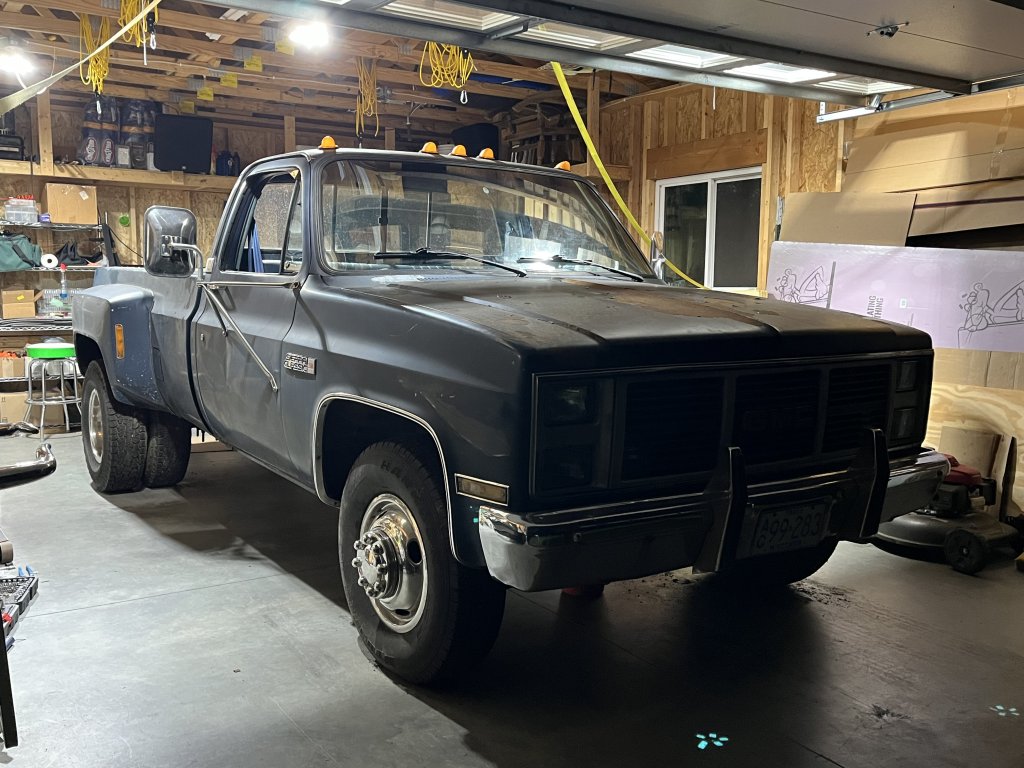

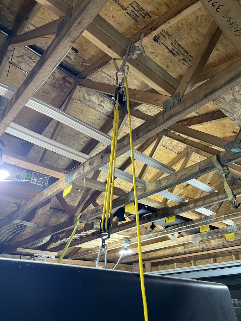

Finally put the bed back on today! I had used 4 block and tackle pulley sets (from deer/game hoists) and a little redneck creativity to lift the bed up to the garage ceiling quite awhile ago.
Now that the new tanks/senders/selector valve/lines seem to be functioning properly, I’m hoping to get her onto the road soon. It’s nice to finally have her looking like herself again!

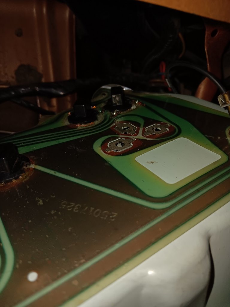

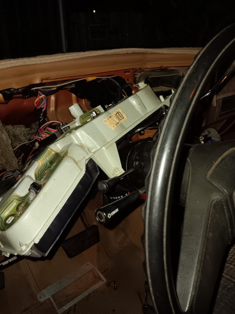

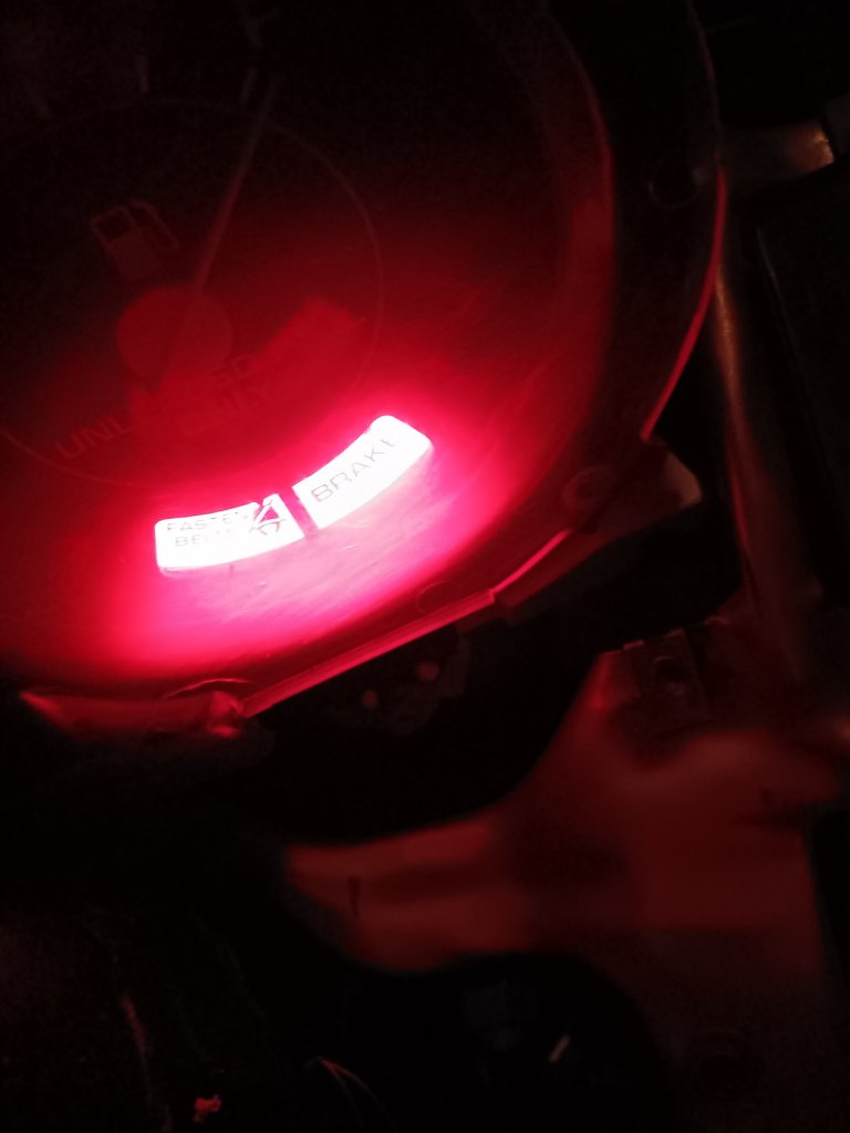

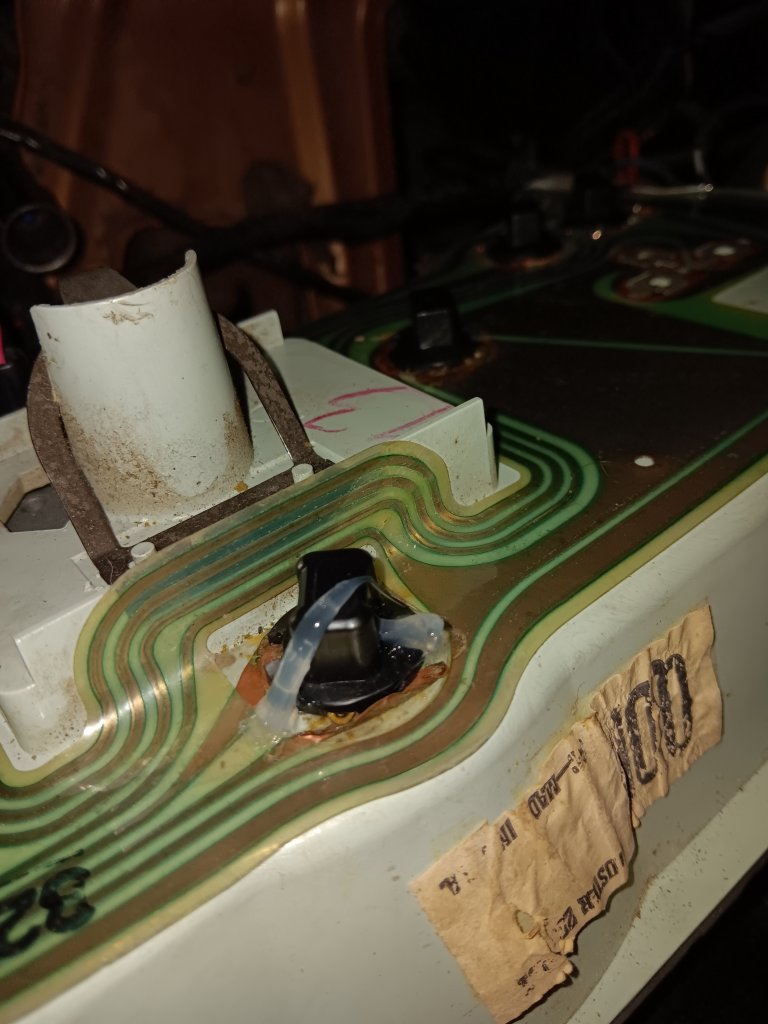

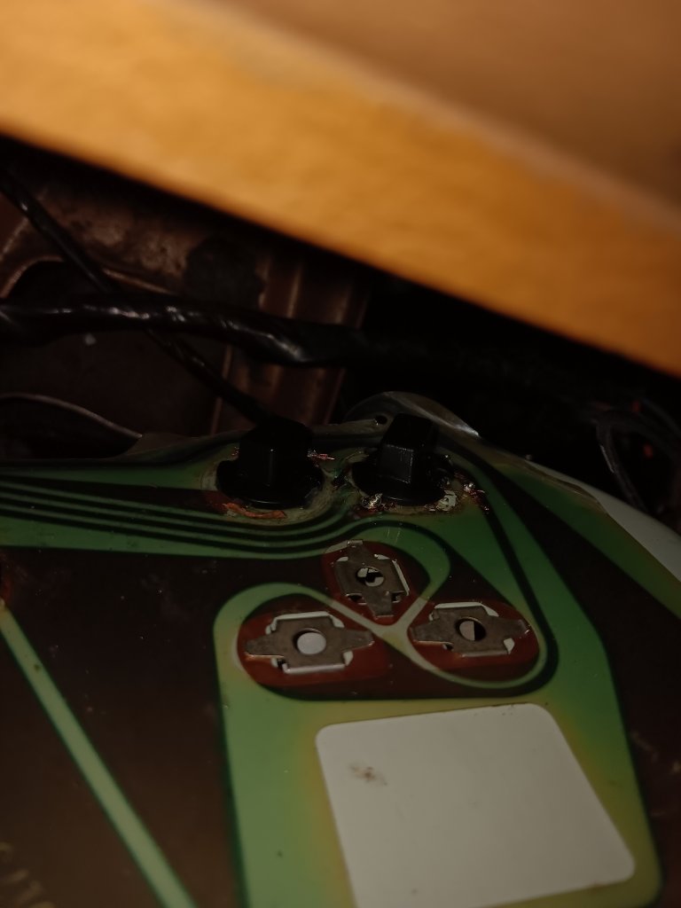

More dash work - had to check out the ac switch since BOTH blowers would randomly quit working. I think it is the pin in the ignition switch or the plug is loose. Since I was there, and the brake light bulb had quit working due to a bad trace, more engineering. The fuel gauge trace was messed up, too. Twisting the bulb holder out destroyed the rest of the trace for both the seat belt light and the brake light. Working now, but still got to resolve the original problem.

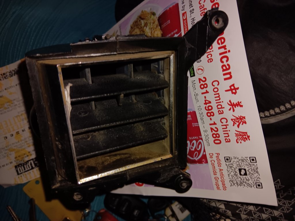

To solve the original blower problem the column has to come down. And, hopefully the super glue holds on this vent. Some of the mounting ears broke.
PITA. :mad:
I hate getting into it due to the aftermarket stereo and the engineered solution for the shift indicator.
Who would have thought a loose wire or plug on the column would have been the cause of a blower issue. :confused:

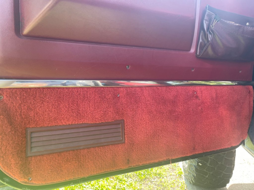

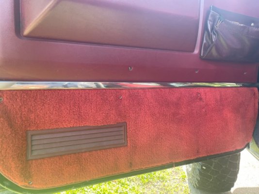

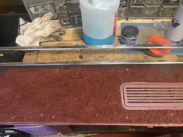

Installed the carpet door trim that I've had from the original carpet. I like the original color better than the red. I would use the factory one, but I only have the one. The other side got wet and fell apart. The red ones are from LMC and are 8 years old. They are holding up well.

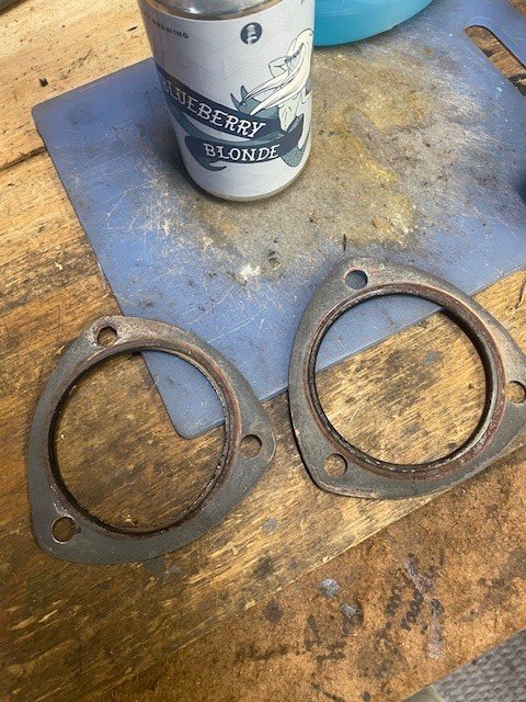

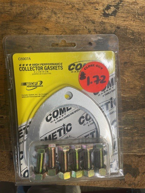

Replaced the collector gaskets on the headers. Chasing an exhaust leak. I think it's a weld on one of the tubes. I have replaced all the gaskets. Check out the price for the new gaskets. Great deal.
I really like the Cometic style header and collector gaskets.
