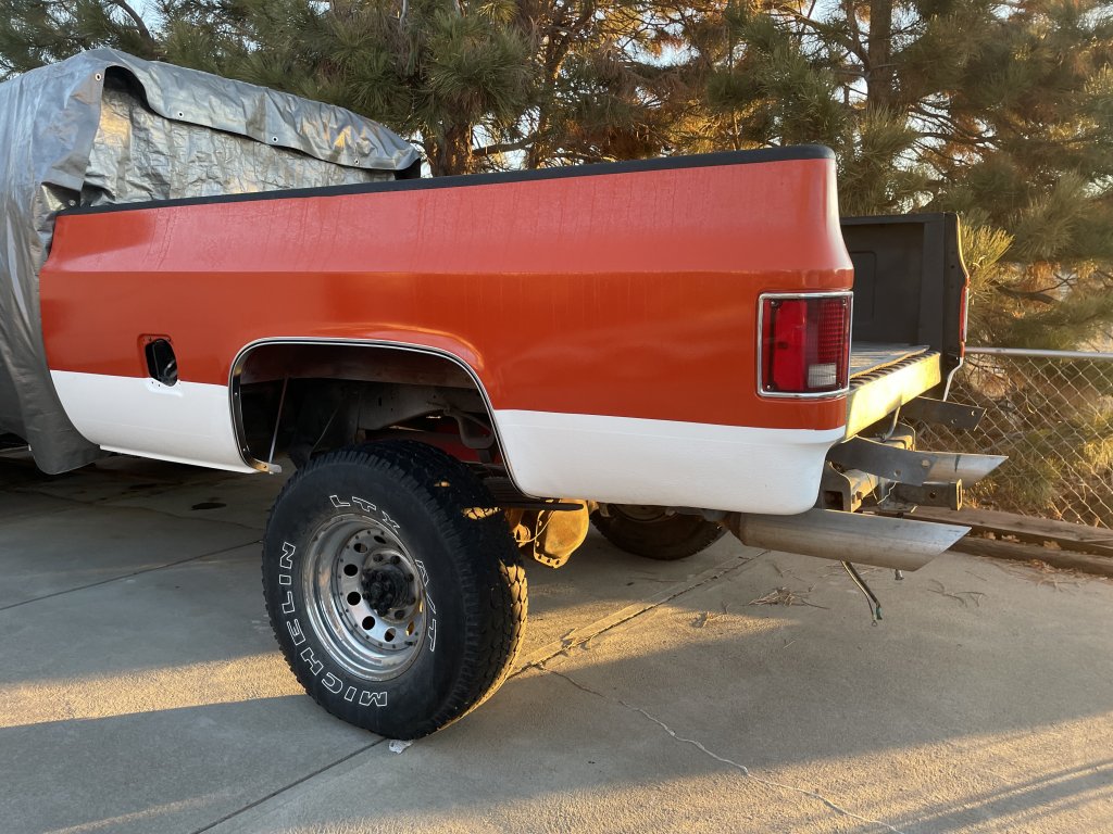

Yep, me 2. My bed is hammered, I don’t feel so bad now; yours is well used too…..working trucks, lol. Its looking good, keep up all the efforts.
