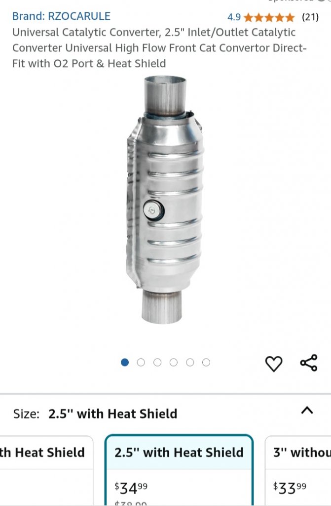

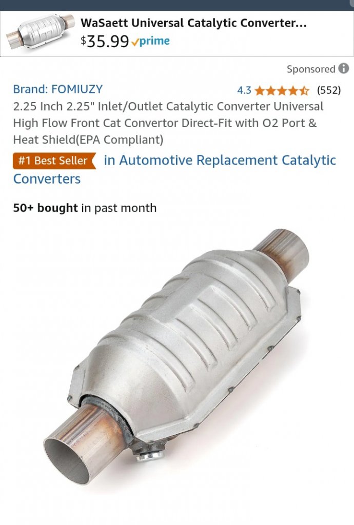

It appears the catalytic converter is not required on a vehicle as old as mine, or any of ours, here in VA.
If deleting the cat won't mess with the driveability of the truck it is the cheapest option. (It seems like there is only one O2 sensor I have seen and it is directly below the exhaust manifold. I saw it and laid my hands on it because I was going to replace it but gave up. When buying the O2 sensor only upstream was available for 1987 Chevy V10 5.7L V8.)
FWIW even if a catalytic converter is not inspected in VA. It is still a violation of federal law to remove it and not replace it. Chances of getting caught just about zero. I'd still put a modern converter back on it,they remove over 90 percent of the carbon monoxide and a lot of the smell from the exhaust,and modern converters don't rob power.
All the ones I have found are cut and weld required.

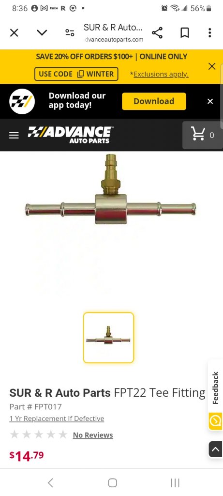

Bought a fuel filter to see which attachments I could use on the truck with the pressure tester guage I borrowed: a Betooll 0-140 psi kit. Nothing fits GM TBI from it. Does anyone have an affordable, or reliable definite go to kit they recommend that has an attachment to test GM TBI?
This and a couple hunks of hose with clamps. Doesn't even need to be this,just a tee you can clamp in place with hoses in place of fuel filter. That's the cheap way, you can buy the correct fitting to go between the fuel line and throttle body. Supposedly the 38.00 action kit on amazon has the throttle body fitting.

This and a couple hunks of hose with clamps. Doesn't even need to be this,just a tee you can clamp in place with hoses in place of fuel filter. That's the cheap way you can buy the correct fitting to go between the fuel line and throttle body. Supposedly the 38.00 action kit on amazon has the throttle body fitting.
I think I can rig that up from this kit actually.
