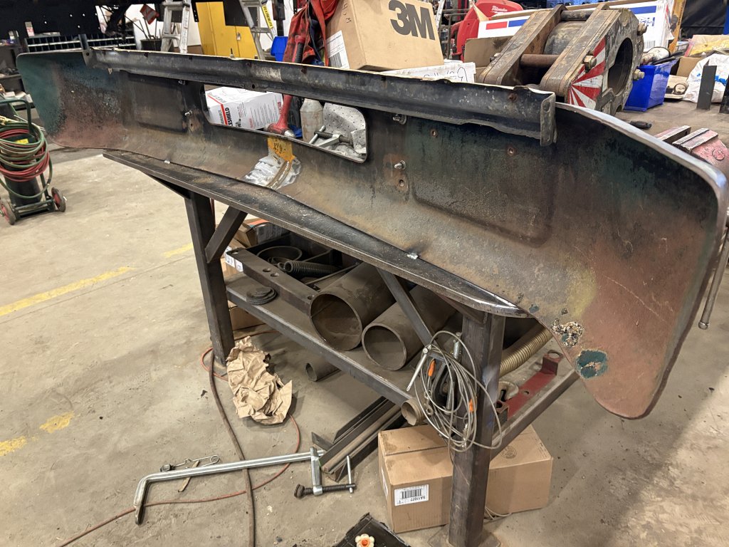

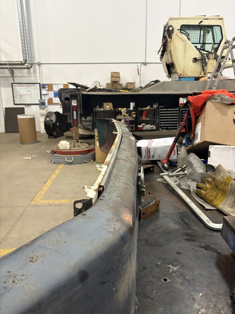

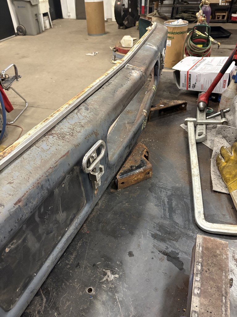

Took the bumper to work today and used some Oxy-Ace to reform the top edge, just a side project within a side side project - Hey Look! Its a squirrel!!
