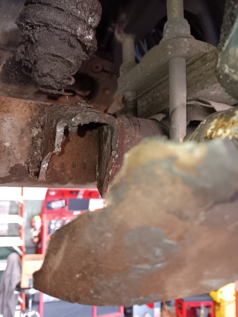

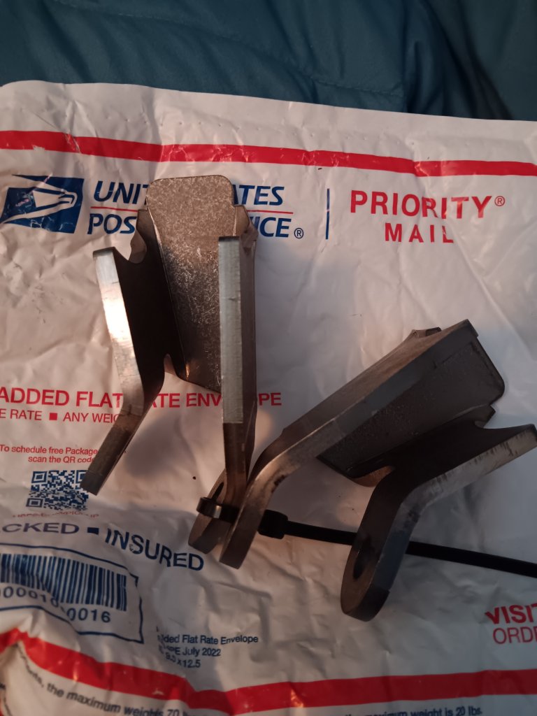

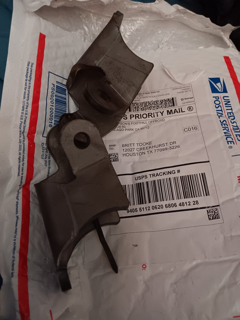

Shock mounts arrived. They look pretty beefy.:waytogo:

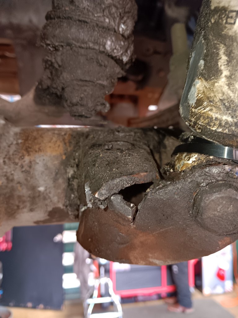

I must have missed it, where did you buy those?
Foothill Offroad Products on EBay.
Item ID 203715811538.
45 bux plus shipping and tax. Matching them up they are thicker than OE and seem to have the correct angles. They may be shorter by a hair but it is hard to tell with the original still in place. It also looks like the upper extension for the axle is a bit longer but I am assuming a welder can make it work.

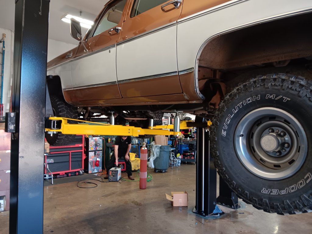

Made some room in my shop. Pulled the body off of the 4x4 frame. Had to see what it looked like on the 2WD frame.... So stoked.

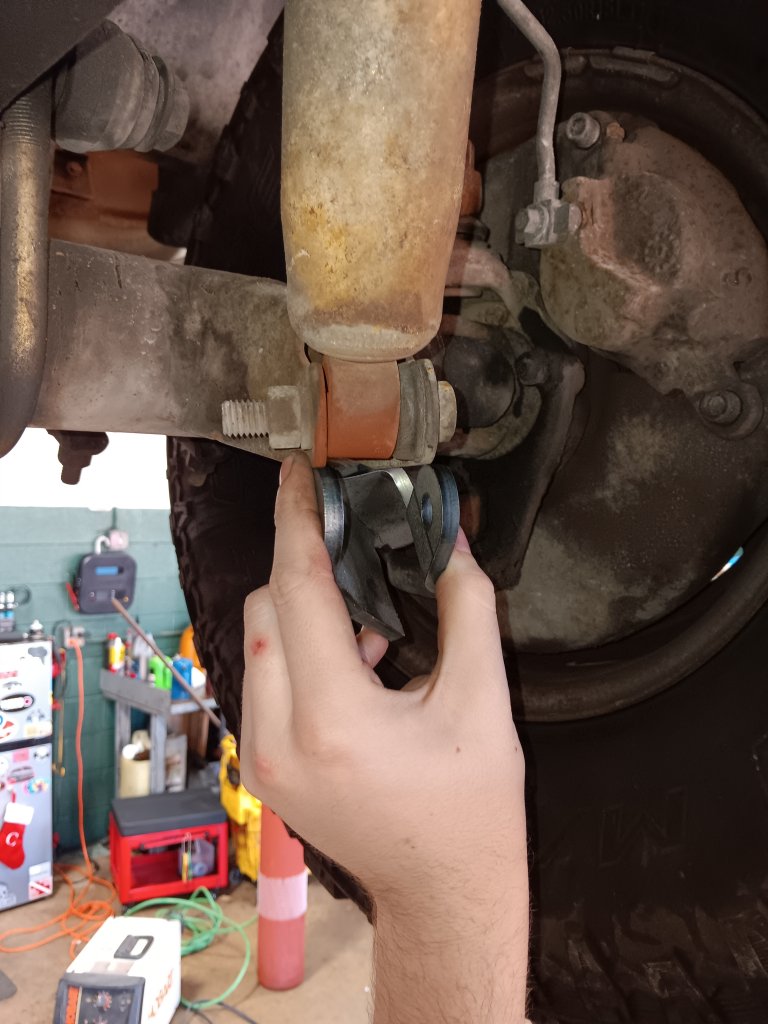

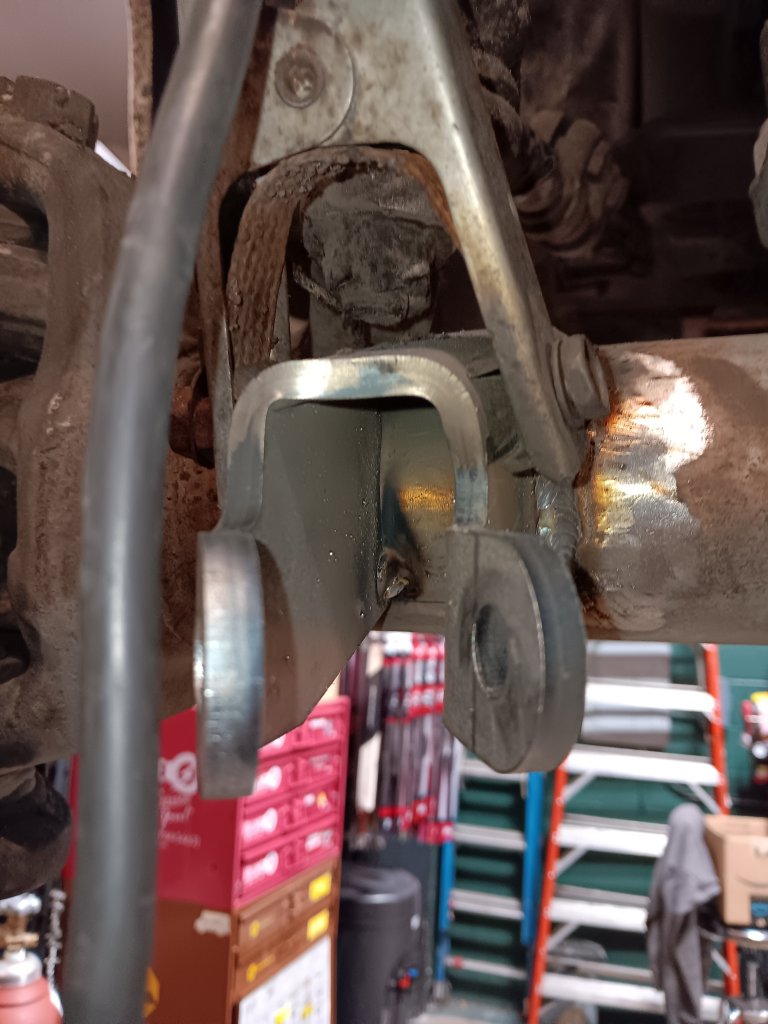

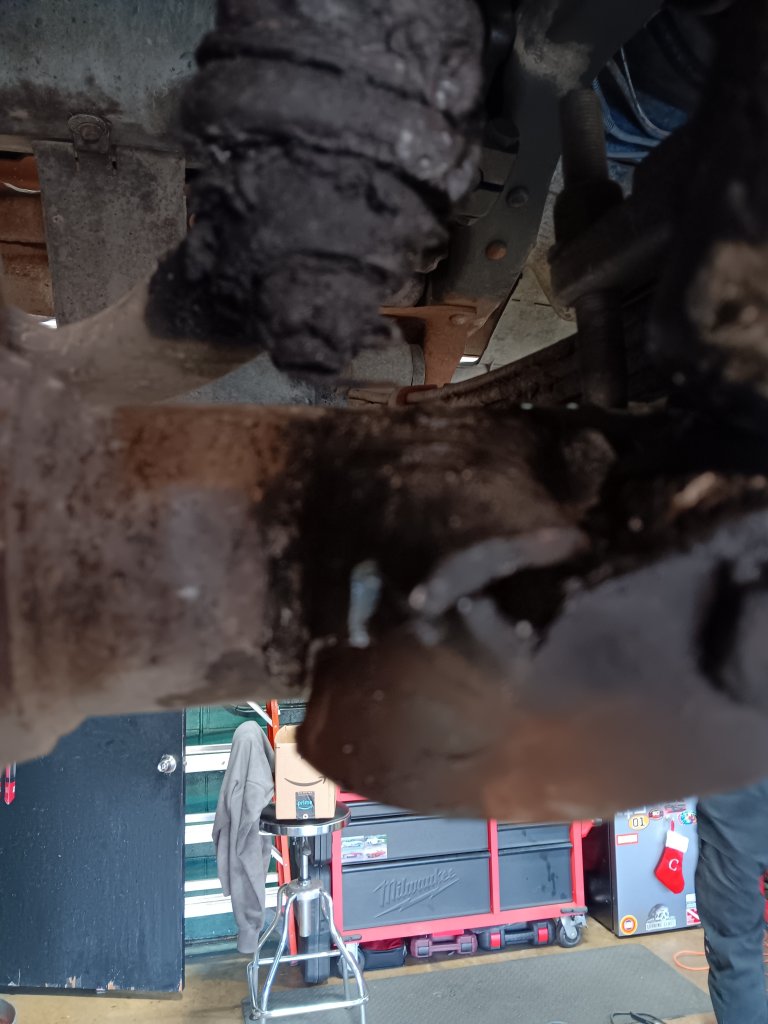

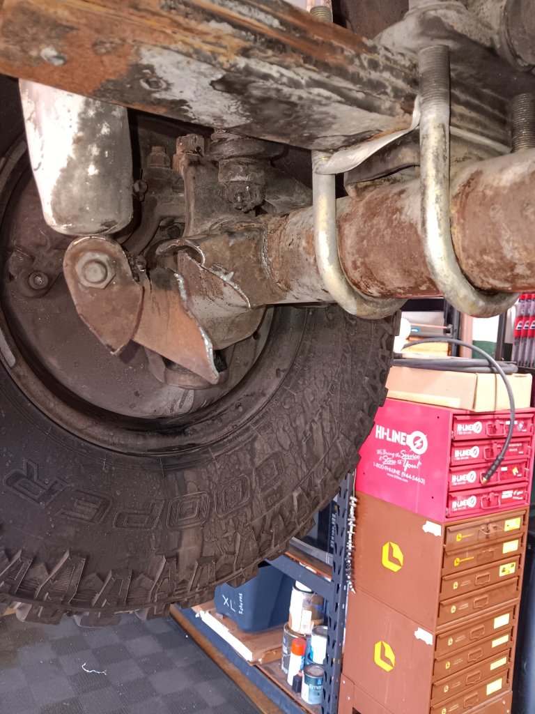

It begins !

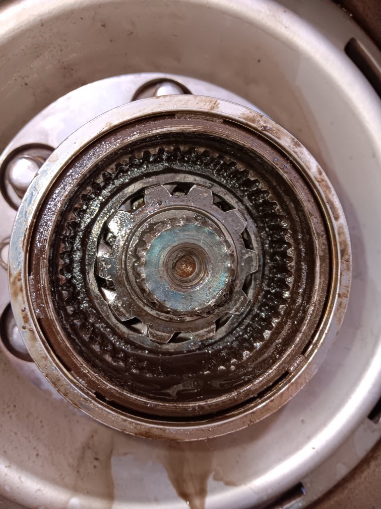

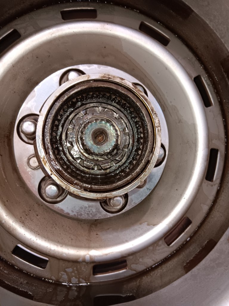

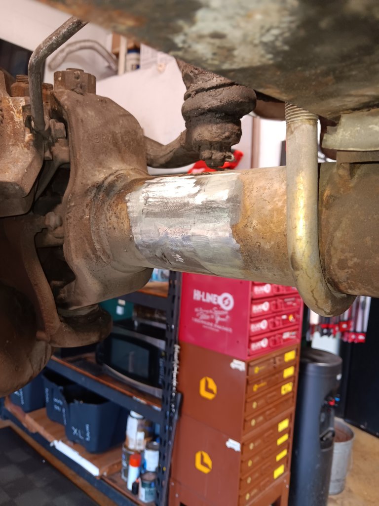

Ground down.
And, a sticking passenger side locking hub.
Must have got water in it ...
BTW, does the axle shaft normally have some wiggle or have my spindle beari gs gone :dancingpoop:?

35,095
43,613
Ground down.
A little bit of wiggle is normal.

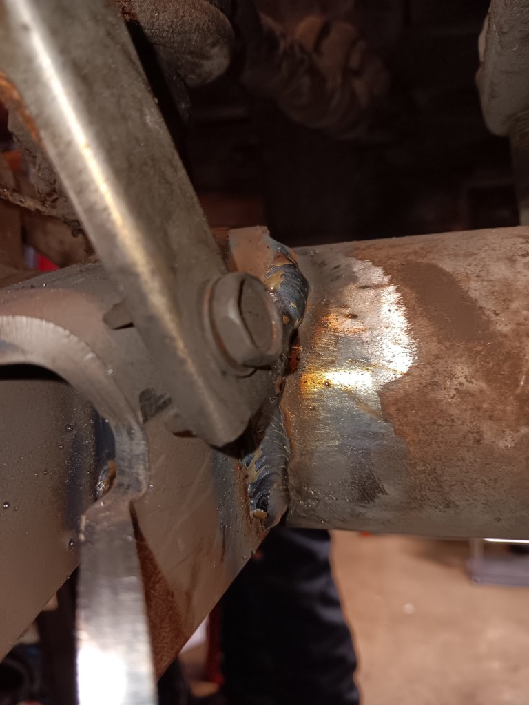

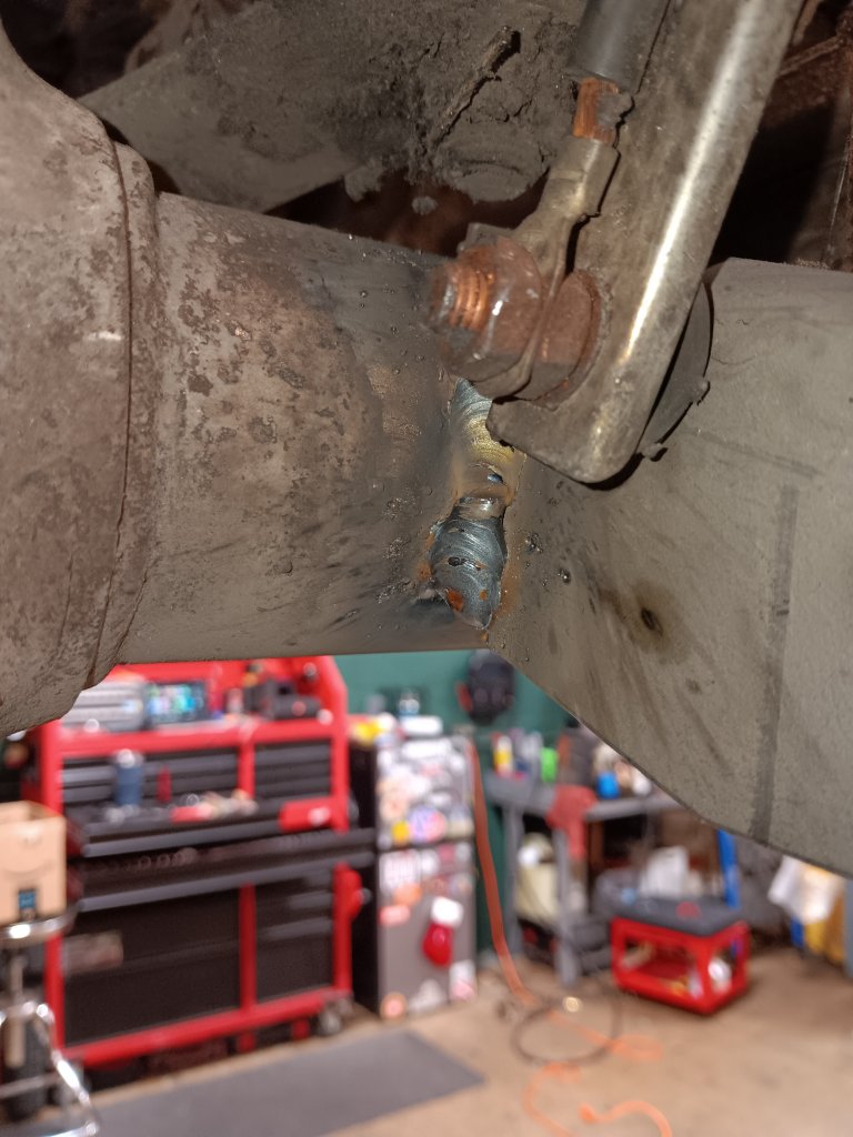

Technical difficulties with the welding machine but another spool later good to go !

35,095
43,613
I'd keep a close eye on those every now and again, for any cracking. Those welds look a little cold to me.

GMC K1500 Suburban
Well, if the welds crack, hopefully the new mount won't. It almost twice as thick as the OE.
