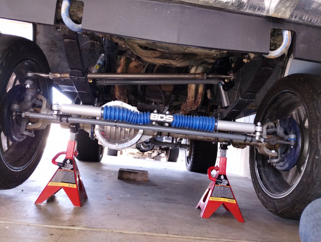

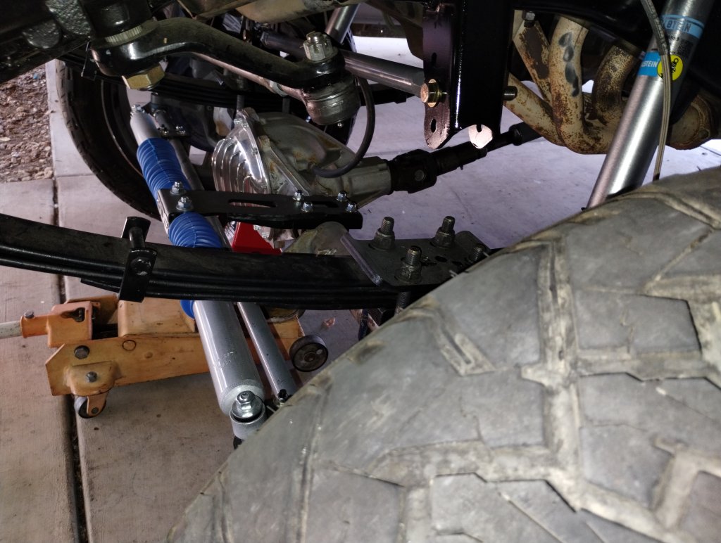

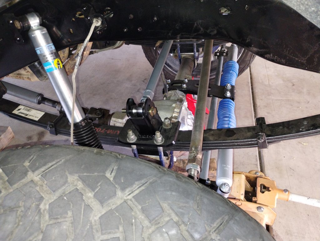

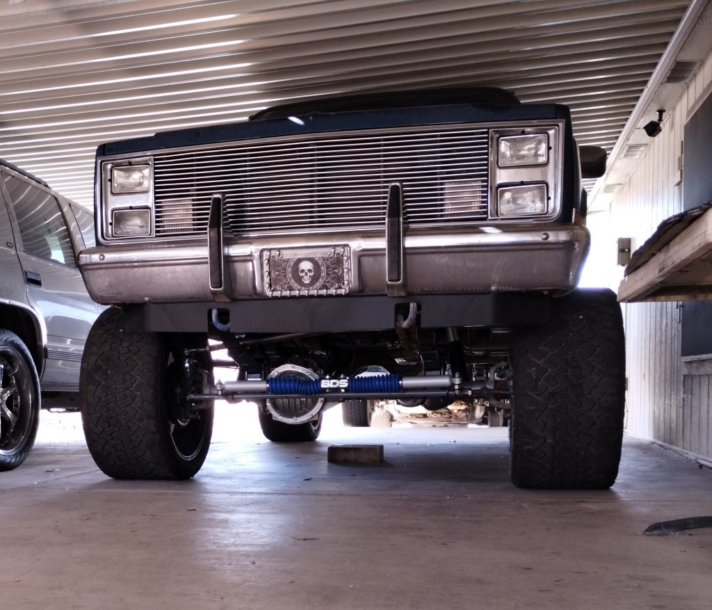

Just finished up the crossover steering on my rig. Added the panhard bar. OMG! What a difference in control. Even with the 24x14, and 35 15.50 R24s. UNBELIEVABLE!

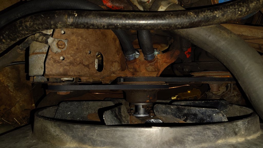

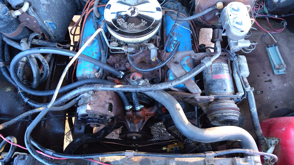

Finished the brakes(one of the new calipers was damaged where the crush washer seals) and replaced the leaking coolant hoses got belts and fan clutch should be here tomorrow along with some fuel hose I still have to drop the tank I will get to it tomorrow also slapped a air cleaner on it

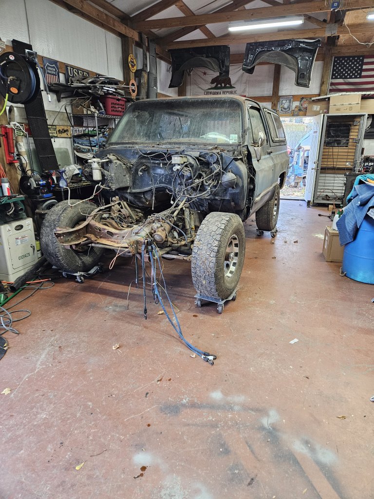

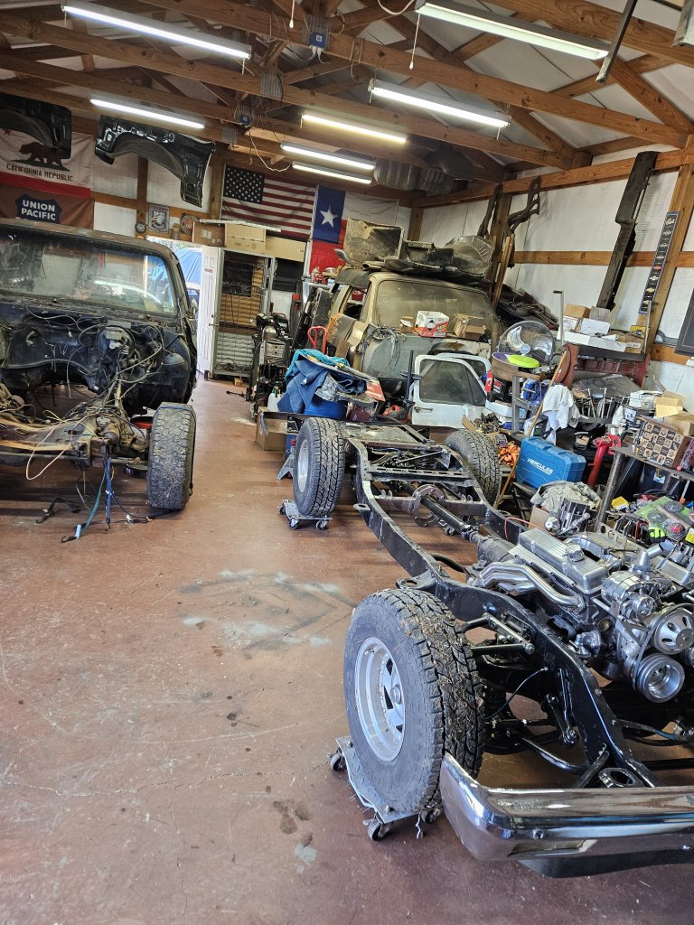

Got the doner Blazer in the shop to pull the body off... it's a bit cramped in the shop at the moment. Hopefully it won't be long before the body comes off.
