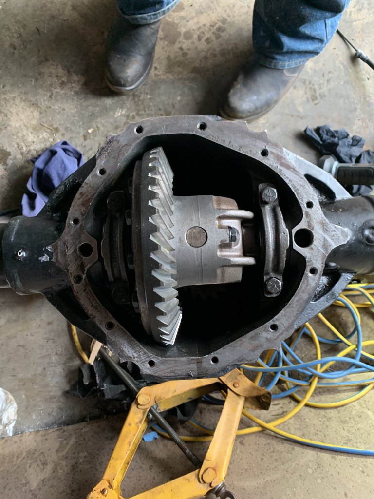

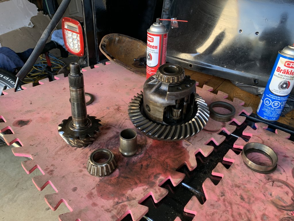

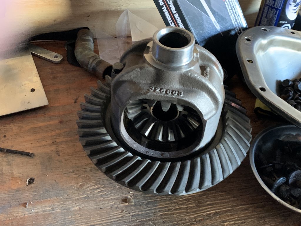

After discovering my G80 locker had broke I finally finished up the rear axle with a replacement open diff. I haven't setup a rear end before, but it wasn't terrible after getting some tools and making a couple of setup bearings.
The rear had a lot of metal in it as the broken G80 locker teeth got ground to a nice fine paste.
Had to get a second crush sleeve when I went a bit too far and ended up with too much preload on the pinion bearings. A few other mistakes but overall it went well.
Was a bit concerned before , but after having the diff in and out many times I am glad I tried it myself and next time I won't be too worried about a job like this.
